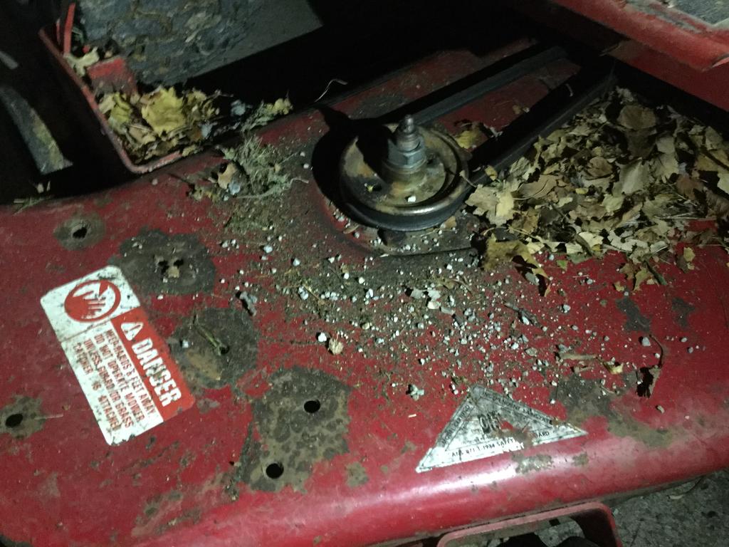

FAST 87 #1 Posted October 19, 2019 (edited) I have a 42” mower deck with the grease zerk on the very top as shown in the picture. When I put grease in the zerk does that grease the whole spindle? The reason I’m asking is because I greased the zerk on top and see no zerk down below but when I run the mower deck it sounds like your hearing a bearing the needs grease. I have no play in any of them and everything looks good but I don’t want to damage something if I can help it. If that zerk doesn’t grease the bottom of the spindle near the blade then is there a way to lube that part of the spindle?thank you for any help. Edited October 19, 2019 by FAST Share this post Link to post Share on other sites
peter lena 10,127 #2 Posted October 19, 2019 the bearings are sealed on the , outside ( exposure ) side , with no seal on the inside of the spindle housing, allowing the zerk fitting to fill the chamber with grease and lubricate the bearing. having said that , it takes regular greasing to fill that chamber, and get in the bearing. when i recently replaced my bearings , i palm greased the bearings, to insure grease, and also pre filled the chamber to ensure there were no issues. i also use LUCAS RED AND TACKY GREASE , 550 drop point for zero grease run off. that noise you hear might be the spring tension IDLER PULLEY , known for failure and noise . they get sloppy and could be your issue. good luck with it , pete 1 1 Share this post Link to post Share on other sites
FAST 87 #3 Posted October 19, 2019 Thank you @peter lena that gives me something else to check that I didn’t give a lot of attention because I was so focused on the spindles. It looked fine but I will really look at that now. Thanks again. 1 Share this post Link to post Share on other sites
pacer 3,181 #4 Posted October 19, 2019 There was a recent post addressing the spindle housings lubrication and replacing the bearings with sealed ones. Thus eliminating the need to stuff gobs & gobs of grease into the spindle cavity just to get a thimble full of grease into the bearing - and even then cant be really sure you did get that little bit of grease there! Any how, I was relating how I have started using sealed bearing and am having good luck with them (FWIW I'm also using sealed bearings on the front wheel spindles for the same reason) 1 Share this post Link to post Share on other sites
FAST 87 #5 Posted October 19, 2019 Thank you @pacer. Went to that post and screen shot that bearing size and asked a question about it there. Share this post Link to post Share on other sites
