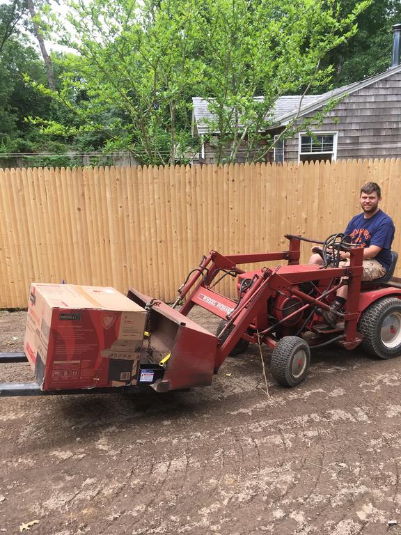

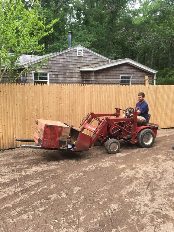

c-series don 12,363 #8 Posted October 10, 2019 I have an ark loader (although it’s tagged as Wheel Horse) on a C-141 8 speed. I believe I paid $1600 for it 15 years ago. I purchased them separately but when I put them together it looked like they were meant to be. My C-141 even has the wrong hood decals but they match the decal on the loader frame so I left them on the hood. Here’s my future son-in-law moving our new grill for assembly. 2 Share this post Link to post Share on other sites
FAST 87 #9 Posted October 10, 2019 @c-series donthat looks really nice. Thank you for posting these pictures. It’s nice to see what my tractor would like like with the ark loader. Do you like how it operates and do you use this tractor as a mower as well? Share this post Link to post Share on other sites
c-series don 12,363 #10 Posted October 10, 2019 This is my dedicated loader tractor. I do like the way it operates, it’s good for around the yard things but as many here will tell you it’s hard to steer with a full bucket of dirt. I am an equipment operator by trade so I know it’s kind of a toy but it is a handy thing to have. Changing from the loader to a mower deck will not be a quick thing. I’d recommend leaving it on and getting another tractor to mow. 1 1 1 Share this post Link to post Share on other sites
