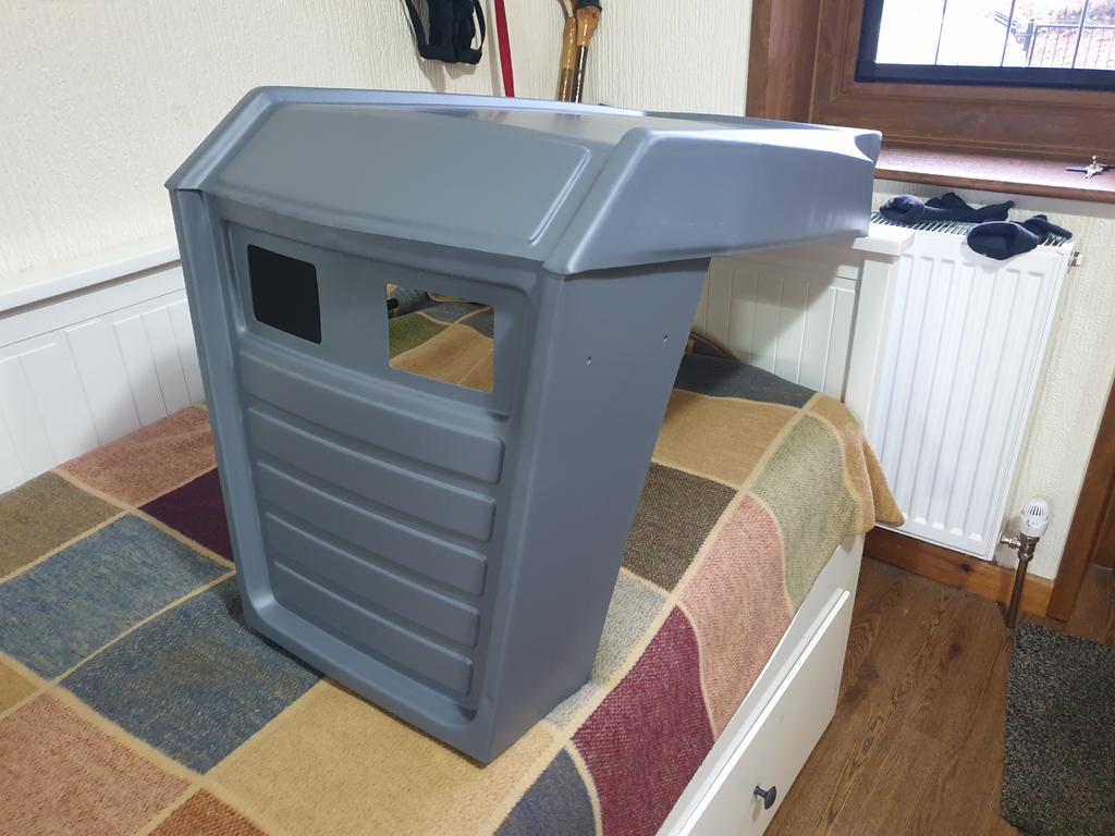

MikMacMike 494 #126 Posted December 19, 2019 On 11/15/2019 at 1:59 PM, Mickwhitt said: Shot blasting is our generic term for cleaning metal but firing media at it using compressed air. Not sure if there are stress relieving aspects to it. The bonnet looks good and I will put it to one side till it's time to paint it. I've painted the underside of the seat tray in black gloss as a corrosion protection measure. I will be painting the upper side when its fitted. Lots more rain here today so floods are all round us. Mick Oh dang your as bad as me......you brought the mare to bed wit ya hehehehehe. Shes lookin sweet. Share this post Link to post Share on other sites

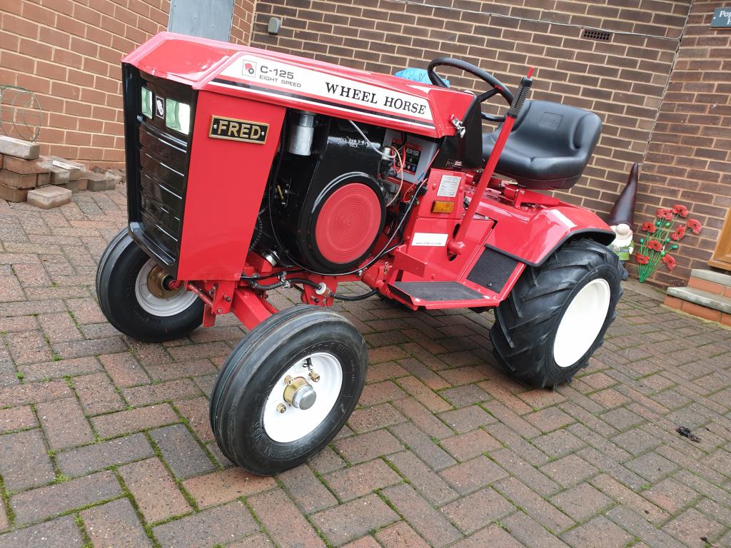

Mickwhitt 5,259 #127 Posted December 19, 2019 Yep mike, if I could get her in the house I would do. First outing today in the driveway, all seems good with the new wheels and hubs at the front. Got to make a PTO brake as that bit is missing. Not a big job. Just chatting with an exhaust fabricator to see if I will need to sell a kidney to get a shiny new muffler. 2 3 2 Share this post Link to post Share on other sites
MikMacMike 494 #128 Posted December 19, 2019 5 minutes ago, Mickwhitt said: Yep mike, if I could get her in the house I would do. First outing today in the driveway, all seems good with the new wheels and hubs at the front. Got to make a PTO brake as that bit is missing. Not a big job. Just chatting with an exhaust fabricator to see if I will need to sell a kidney to get a shiny new muffler. I think youve got enough tools there Id be inclined to make one from stainless steel. I am hoping soon thats what Ill be doing too. It was neat to research on exhaust harmonics and in fact I read somewhere in here a RedSquare boy was giving info on exactly that too. Ill be doing some mods on my Kol~po intake and exhaust to extract a bit more hp and tork out of her....basically making her more efficient too. You got a great lookin pony there bruther. When I was living in the UK I did notice, well in London anyways, they wer still cutting grass the one year a couple days before christmas heheheheh Youll never need a snow blower id think? A plow very posibly! Share this post Link to post Share on other sites
balconio 606 #129 Posted December 20, 2019 10 hours ago, Mickwhitt said: Yep mike, if I could get her in the house I would do. First outing today in the driveway, all seems good with the new wheels and hubs at the front. Got to make a PTO brake as that bit is missing. Not a big job. Just chatting with an exhaust fabricator to see if I will need to sell a kidney to get a shiny new muffler. Wow it turned out gorgeous, really nice attention to detail. Nice job! 2 Share this post Link to post Share on other sites
