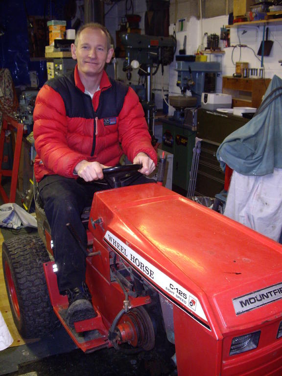

Mickwhitt 4,082 #1 Posted September 26, 2019 Hi again, I managed to dig out an old memory stick with some photos on of when I got my new Horse and the strip down sequence of it. I was shocked to see the date was 2007..... was it really that long ago I embarked on this journey? But there has been a lot of other stuff going on too, so she has not taken centre stage. 14 Share this post Link to post Share on other sites
Mickwhitt 4,082 #2 Posted September 26, 2019 A much younger looking me sitting on the Horse when she arrived at my previous house. 2 Share this post Link to post Share on other sites
The Tuul Crib 7,331 #3 Posted September 26, 2019 Funny how father time can change our Appearance im definitely one for that !! But after all it's all about the wisdom that we gain along the way! Especially when it comes to the color red ! Nice looking tractor can't wait to see more pictures ! Share this post Link to post Share on other sites
Stormin 9,975 #4 Posted September 26, 2019 'Ow do, Mick. Nice looking C-125. Did a refurb on my C-125 early this year. Really good work horses. I see a Mountfield sticker on the front. A Belgium built one by any chance? Mountfield did import them. My C-81 and C-121 are Belgium built. My C-125 was built in South Bend. USA. 1 Share this post Link to post Share on other sites

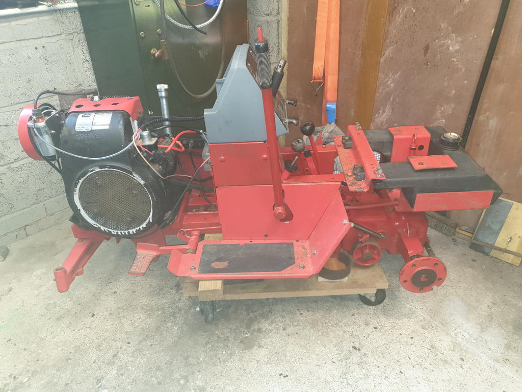

Mickwhitt 4,082 #10 Posted October 13, 2019 Ok, so I've found the majority of the bits I stored away 12 years ago. They survived a house move and I dont seem to have lost anything big. It's just remembering where everything goes! A few hours over the weekend and I'm at this stage, Again I'm sorting out where everything goes before I repaint things. Dont want to get well into things and find something big needs addressing. May have the big sheet metal lumps powder coated rather than paint them myself. Regards Mick 4 Share this post Link to post Share on other sites

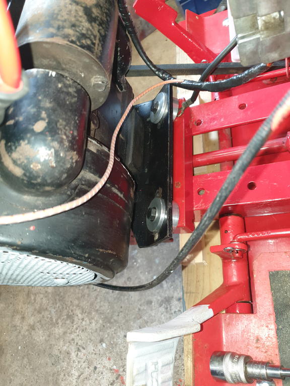

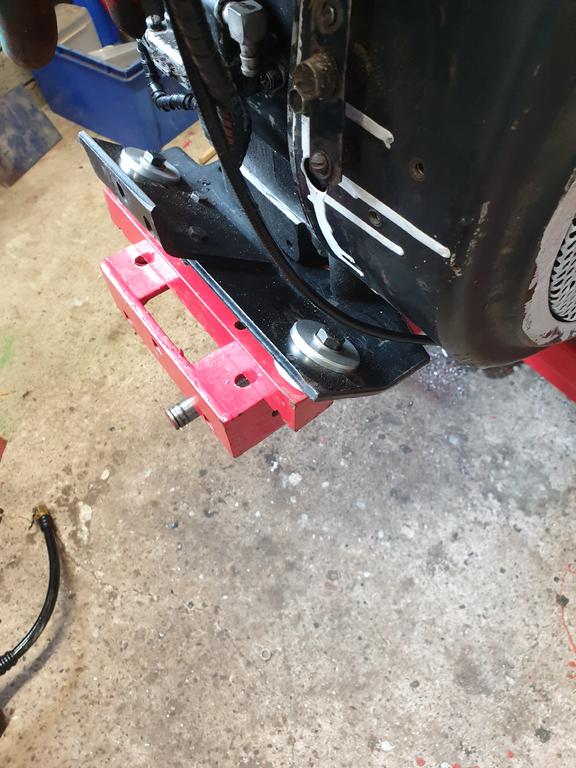

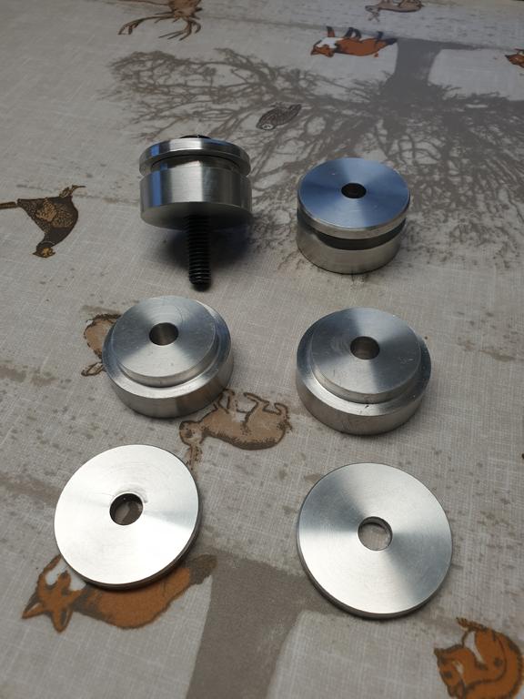

Mickwhitt 4,082 #14 Posted October 14, 2019 Yes I see, the firm that do the wheels are pretty good so I'm just going to have those cleaned and refinished. I bought 2.5 litres of Fiat Rosso paint which is as near as can be to the Massey fergusson red I was going to use. Decided to make a set of bronze bushes for the clutch cross shaft as it's a bit sloppy in the chassis. A day on the lathe will see those done a d the new engine mounts. Mick 3 Share this post Link to post Share on other sites
Stormin 9,975 #15 Posted October 14, 2019 Looking forward to seeing the engine mounts. 1 Share this post Link to post Share on other sites
Mickwhitt 4,082 #16 Posted October 15, 2019 Wheels have gone in for cleaning and coating, tyres arrive tomorrow. I've done a set of mountings and I will have a go at fitting them on friday, I have a couple of busy days coming up. Just a simple round pad that fits in the cradle and a washer to clamp the whole lot down. Mick 2 3 1 Share this post Link to post Share on other sites

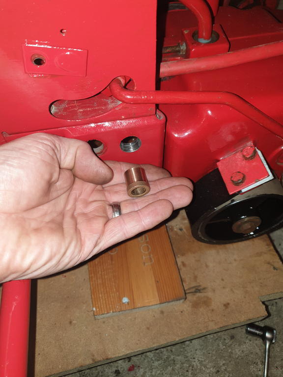

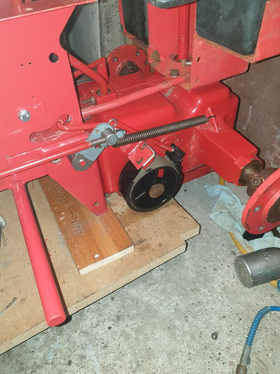

Mickwhitt 4,082 #18 Posted October 20, 2019 Ok, so the brake band is back and fitted. The clutch cross shaft was quite sloppy in the chassis bearing holes so I bored them out and made two bronze bushes. Much more secure and positive now. 4 Share this post Link to post Share on other sites
Mickwhitt 4,082 #19 Posted October 20, 2019 The cross shaft has far less movement and the clutch feels a lot smoother and positive. 5 1 Share this post Link to post Share on other sites

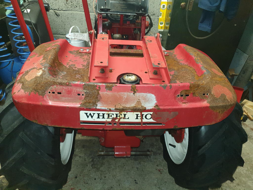

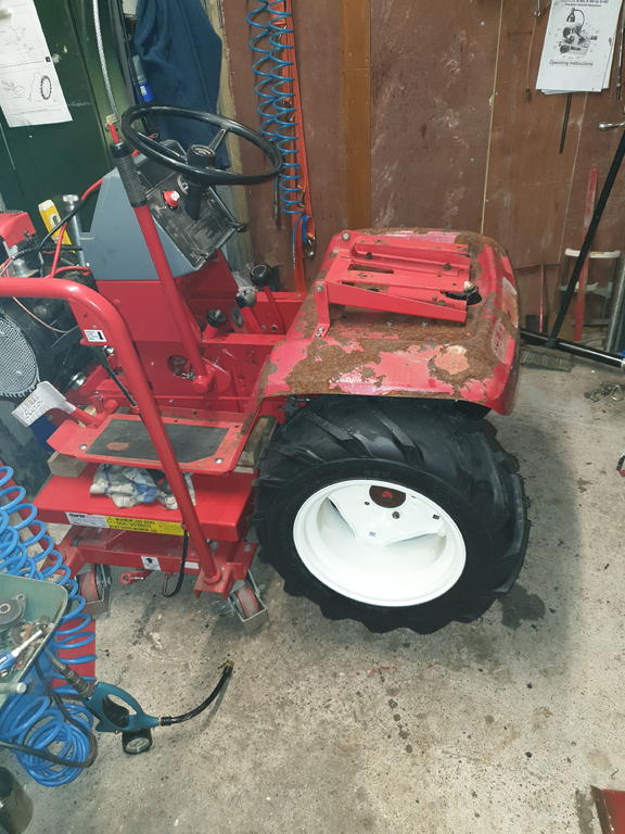

Mickwhitt 4,082 #21 Posted October 21, 2019 I have just remembered that when this horse arrived it had no seat tray, just a cobbled together roll bar affair. I bought a seat tray and I fitted it today to see if it fitted. Anyone have any thoughts if it looks ok? Also not sure what the seat stops should rest on, there is nothing for them to sit on. Also tried the new wheels on. 1 1 Share this post Link to post Share on other sites
Stormin 9,975 #22 Posted October 21, 2019 Seat tray looks OK. Though the brackets look taller than mine below. There should be two spring loaded rubber ended buffers at the back. You can see the split pins keeping them in place. Share this post Link to post Share on other sites
Mickwhitt 4,082 #23 Posted October 22, 2019 Thanks Norm, Looks like the seat hinge supports have been lengthened to allow the tubular steel roll bar to be fitted. I'm going to scrap that as it's not right for the machine and a bit Heath Robinson. I'll fabricate new supports to put the seat base level. Engine mounts are fitted and look good, just a bugger to fit with no flex like the rubber ones. I'll post a pic later, just busy with organising stuff. Mick Share this post Link to post Share on other sites
Mickwhitt 4,082 #24 Posted October 22, 2019 Another bit of lathe work to make bronze bushes for the PTO lever, even though I probably wont use it. I modified the seat brackets back to their original size so the seat support sits level now. 4 Share this post Link to post Share on other sites
