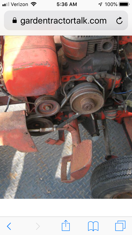

Burnerman 759 #27 Posted September 27, 2019 (edited) What I need is the proper belt routing and sizes for this tractor. It has the separate clutch and brake pedals. The parking brake handle is in the rear. 5/8” x 35” engine and 5/8”x 62” trans belts don’t seem to work out. Are we missing something? @new2horses or @jabelman any ideas? Edited September 27, 2019 by Burnerman Share this post Link to post Share on other sites
Burnerman 759 #28 Posted September 27, 2019 I found a video on YouTube of the 3 different year executives. It looks like ours is closest to a 64 model. The implement arm does not have a push button. The whole top grip moves down to release the pawl and a slight twist in the released position locks it into float. The pedals and parking brake are also consistent with the 64’s. The 65 has fixed foot rests with a bar that is a combination clutch/brake. Our dash layout is consistent with a 65 but the battery cover is only retained by 1 screw at the top. I see later ones with 2 additional screws at the bottom. I guess we’ll have to bring her to some shows next year. Maybe we’ll find some answers. 😁😁 I’ll be going to Jacktown fall harvest show next month in Bangor PA. I’ve never been there before. I’ll bring some pictures and see if anyone has info. Share this post Link to post Share on other sites
Burnerman 759 #29 Posted September 27, 2019 Found a belt routing picture for the left pedal clutch. Matches our setup so now I just have to find a set of belts that fit properly. 1 Share this post Link to post Share on other sites

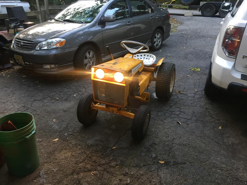

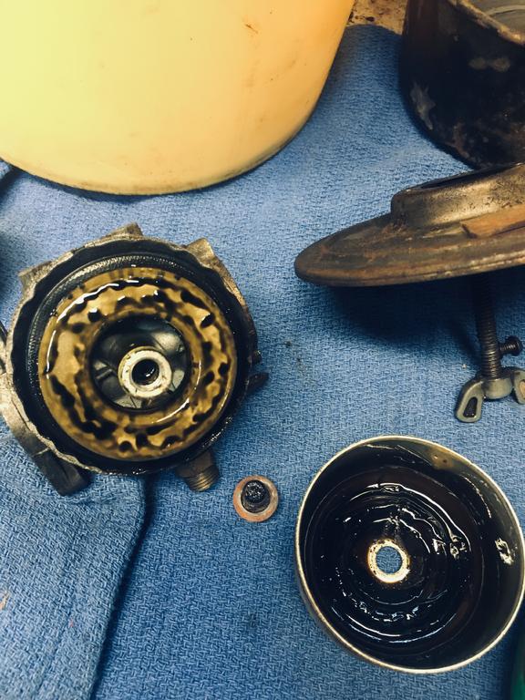

Burnerman 759 #35 Posted September 28, 2019 my son stopped by tonight and we just couldn’t wait till tmw. Got the belt situation figured out. I put on a 63” belt with the jack shaft in the full rearward position. We found out that the engine mounts were at the full forward position. We slid the engine back and the 35” belt disengages now. We tucked the wiring in and pulled the cover on the voltage regulater and found a set of points burnt. Cleaned them up with a point file and the gen light is now out! We’re charging! I’ll meter it out tmw. I’ve got a lil wiring to fix up. My son ran it up and down the road. One headlight was actually working. We drained the trans and there’s a magnetic drain plug!! The fluid was full of bronze but otherwise great. I’m guessing that’s the axle bushings. I hope I can replace those without opening the trans. There was no evidence of moisture at all! There was no gear oil smell to it but it was gear oil. It maybe the original oil. Refilled it and I went for my ride but no headlight. Found out the headlight wire shorted out on the grille. Seems with the engine in the full forward position had rubbed the headlight wire thru on the air cleaner we never checked that wire. That was probably the mystery load we had @JBall when we had it on the WH. ☹️ Also!!! There’s no fuses on that circuit except 2 55yr old headlight bulbs. ☹️☹️ Check all of your wires!!!! It runs great and drives well. My leather brake band isn’t thick enough but does work for now. I still can’t figure out how the parking brake lever is supposed to be setup but I’m going to keep at it. I’m close. 😁 I’ll post some more pictures tmw. Here’s it’s very first ride in who knows how long. 22004AD5-0177-411C-996A-8D5D910A63C1.MOV 3 2 Share this post Link to post Share on other sites

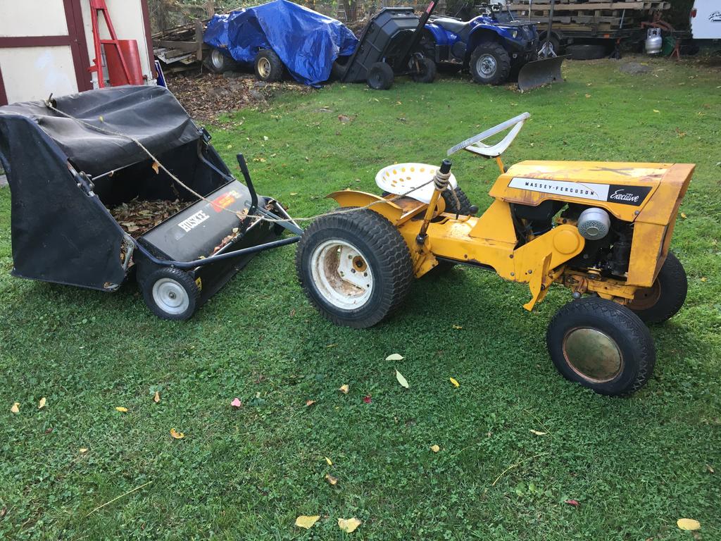

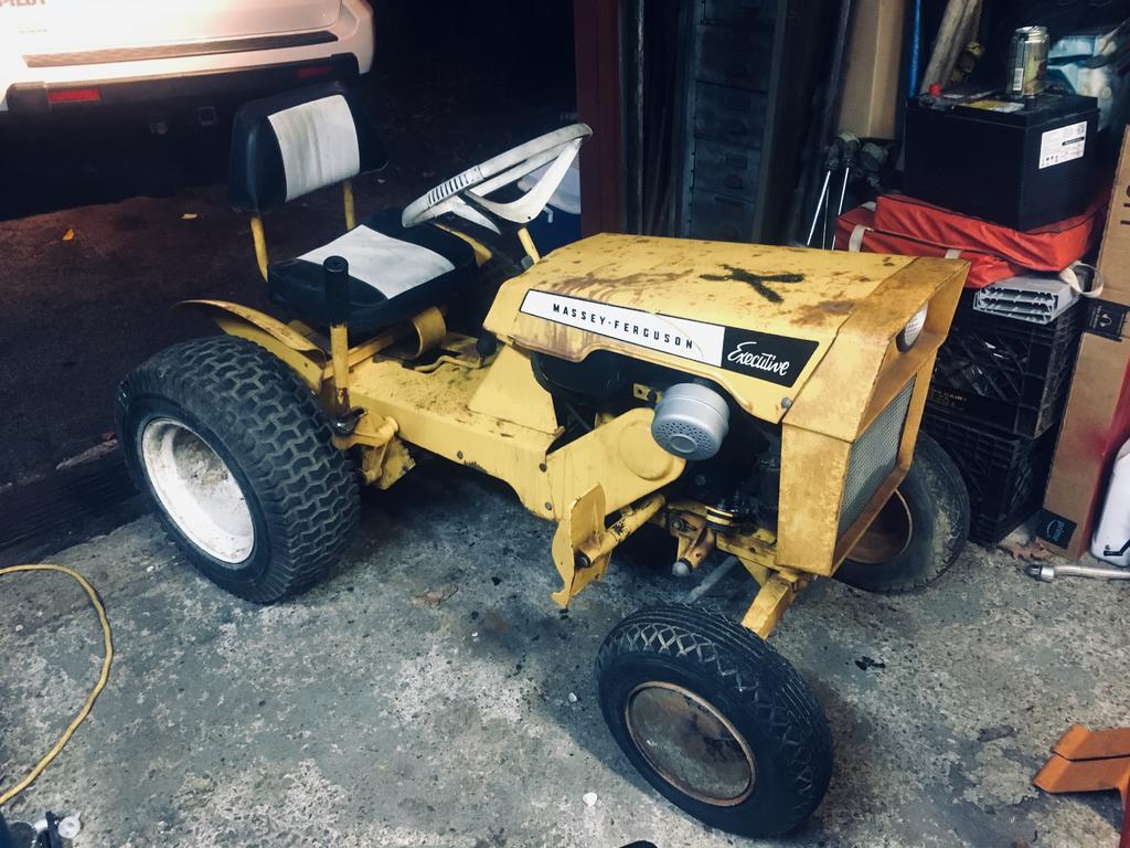

Burnerman 759 #38 Posted September 28, 2019 My son @JBallstopped at the junkyard on his way over to work on his Jeep. Found out the tractor came from a horse farm about 25 min away. He found a steel tractor seat bolted to a milk can so now we have a work seat. And I put her to work. My WH has a bad front wheel bearing that I’m glad I caught in time. So the Massey gets to sweep leaves. 2 1 Share this post Link to post Share on other sites
Burnerman 759 #39 Posted September 28, 2019 (edited) After running it I can see why the dual pedals got ditched for a single clutch/brake pedal and the parking brake moved up front. Lol. I tried to go with that thing set I don’t know how many times. 😂 My leather brake band works pretty good! Its a cool little tractor though that runs amazingly well. Shes a keeper. Edited September 28, 2019 by Burnerman 1 Share this post Link to post Share on other sites

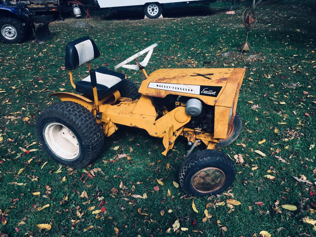

Burnerman 759 #42 Posted October 7, 2019 I relined the brake band with the proper material. It was tricky and needed to be thinned down a bit but it works great. The leather I had put in was in good shape still. I didn’t take any pics. ☹️ We got the new neutral safety switch and installed it. I put a new starter belt on. It still slips when cranking every once in awhile. The engine doesn’t have ACR. 2 3 Share this post Link to post Share on other sites
