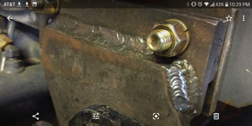

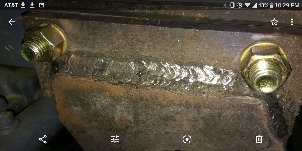

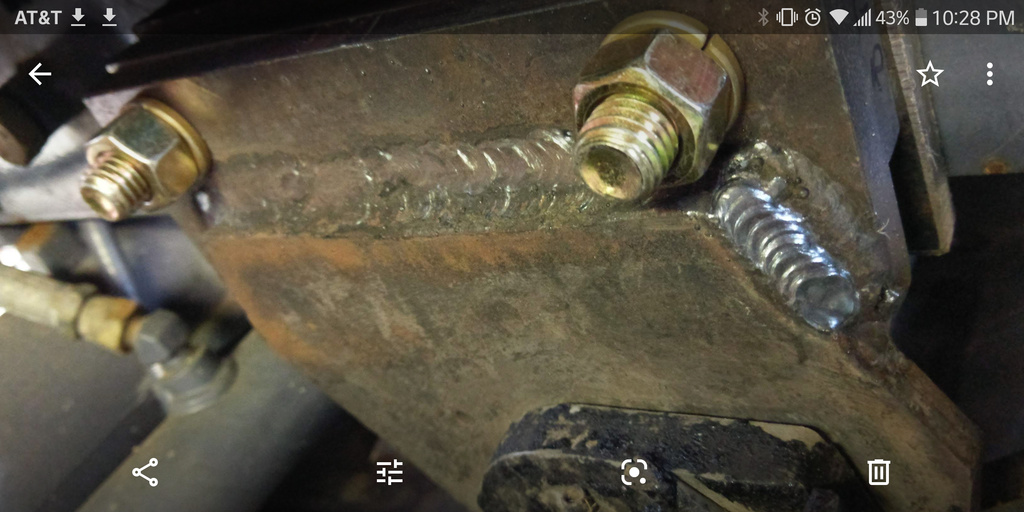

ebinmaine 79,297 #101 Posted December 8, 2019 14 minutes ago, wallfish said: Woo Hoo, there's no limits now. Practice Practice Practice Get yourself a slag hammer to knock it off if you don't have one. COVER YOUR EYES as that crap is brutal on the eyeballs since it's sharp! And hot if you chip it off quick enough. Pay attention to the puddle as you move the stick. Sometimes easy to loose if you try to go too fast. Be sure to grind the edges or faces of the metal you are welding as clean metal is much easier to get a good bead with good penetration. A bead may look good from the surface but without the penetration it will be weak. Wait until you try vertical and or overhead welding, that takes some patience. https://www.ebay.com/itm/392269613976 Thanks John. I appreciate the tips as always. I have a slag hammer and some other things... Auto darkening helmet. Kevlar sleeves. Great boots. Next purchases will be more protective gear. Some sort of hat and an apron. Share this post Link to post Share on other sites
JoeM 10,053 #102 Posted December 9, 2019 That looks pretty good EB. It is a fine start! I have to laugh about a story of my early days. They had a canopy busted on a machine cab in the field and the day foreman gave me the assignment of repair. I was a swing shift welder working the day turn. I ask the foreman why he didn't assign the job to one of his steady day guys. You know the guys with the good check numbers. He told me; "I need a welder not a rod burner!" I felt pretty good, never forgot. Right now you qualify as "Rod Burner", with much potential to do welding! Ingredients for a good stick weld; heat, angle, speed, and arc length. Heat; use a mfg. suggested medium, angle; tilt rod about 15 degrees in direction of travel, speed; puddle should be twice as wide as rod is thick, arc length; about half the thickness of rod diameter. Just a few rules of thumb, adjust as you go. 1 2 Share this post Link to post Share on other sites
ebinmaine 79,297 #103 Posted December 9, 2019 22 minutes ago, MrOiluj52 said: qualify as "Rod Burner" I'll take it!!! I'm pretty happy I got 2 pieces of metal to stick to each other.... 1 Share this post Link to post Share on other sites

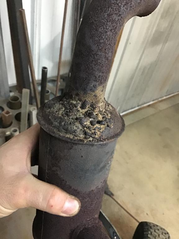

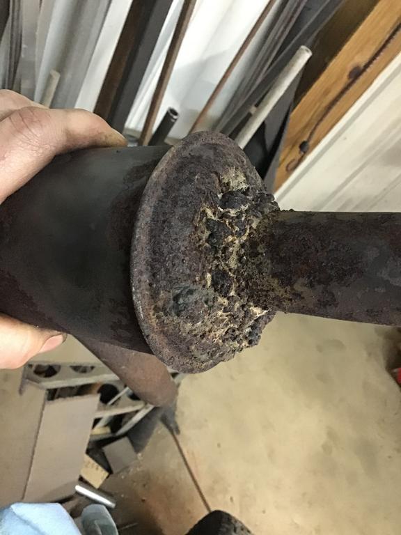

Pullstart 70,195 #107 Posted April 5, 2020 EB! Great progress! As you have found today, practice practice! Being comfortable is key and finding a way to brace your hand, arm, etc is going to be exponentially the best way to improve a novice’s experience while welding. Other than safety details, this was the first thing I taught Rylee today when she was welding for the first time. Your definition of “looks like Hell” is way wrong. This is thah mufflah (see what I did there?) off Steve. We hacked the downpipe off it to fix up Screamin’ Jimmy. This looks like Hell. 2 2 Share this post Link to post Share on other sites
WVHillbilly520H 10,378 #108 Posted April 5, 2020 Eric practice does make "perfect" you too can be laying a bead with the stick like this... 1 1 Share this post Link to post Share on other sites
ebinmaine 79,297 #109 Posted April 5, 2020 9 hours ago, pullstart said: This is thah mufflah (see what I did there?) I don't know if I should admit this on an open public forum but I didn't even catch that the first time I read the sentence. I'm just so used to reading and speaking like that it just didn't even register. I think it's awesome that you got your kid out there learning to weld. That mufflah looks like somebody had a lot of fun with about 4 6011 rods making boogers... 1 2 Share this post Link to post Share on other sites
