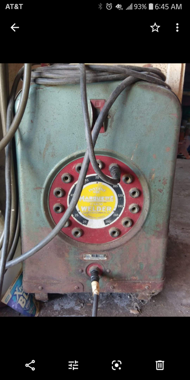

WVHillbilly520H
Eric, this is my FILs that I have been using lately... Also 5/32" diameter rods seem to work better for me...

The reason that I wanted a stick welder is because I have already purchased some rods because my father gave me a stick welder. Turns out his will only weld 1/16" 6013 and even that not all that well.
