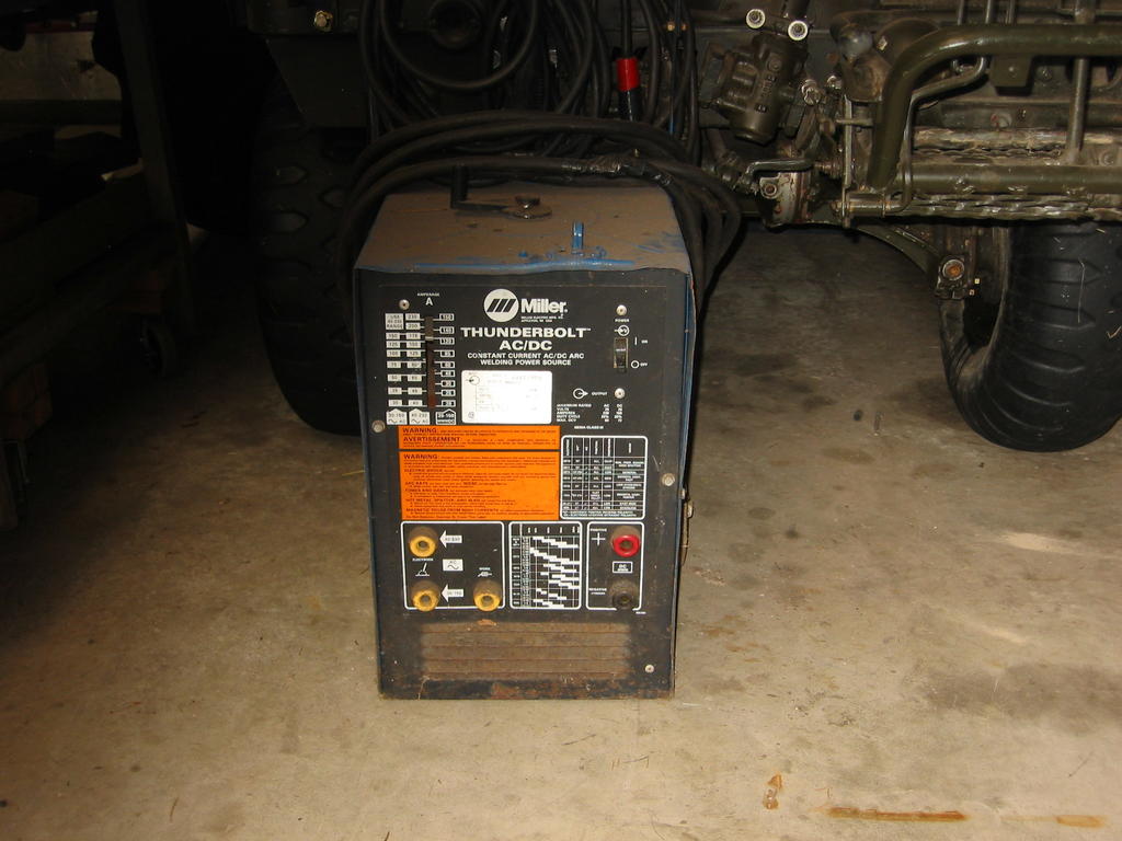

pfrederi 21,007 #29 Posted September 17, 2019 I will ad as a complete amateur welder I really like the DC capability. A mentioned can be much easier striking an arc got his for #35 at an auction. Didn't work well found it was wired for 440. Fixed to 220 works great. Miller Thunderbolt AC/DC 2 Share this post Link to post Share on other sites

oliver2-44 11,663 #39 Posted September 18, 2019 6 hours ago, pfrederi said: I will ad as a complete amateur welder I really like the DC capability. A mentioned can be much easier striking an arc got his for #35 at an auction. Didn't work well found it was wired for 440. Fixed to 220 works great. Miller Thunderbolt AC/DC Yes that the machine I have. Very happy with it for the farm welder I am, just not thin stuff at my skill level. My older brother is a very skilled welder and he did beautiful repairs on my big Oliver backhoe welding every direction. On the Auto darkening helmets. I bought a "Lincoln" lower price one and later learned the small watch sized battery in it was not replaceable. So I learned the hard way, in 2 years it was junk. The next one I bought I made sure it had a replaceable battery. 1 Share this post Link to post Share on other sites
