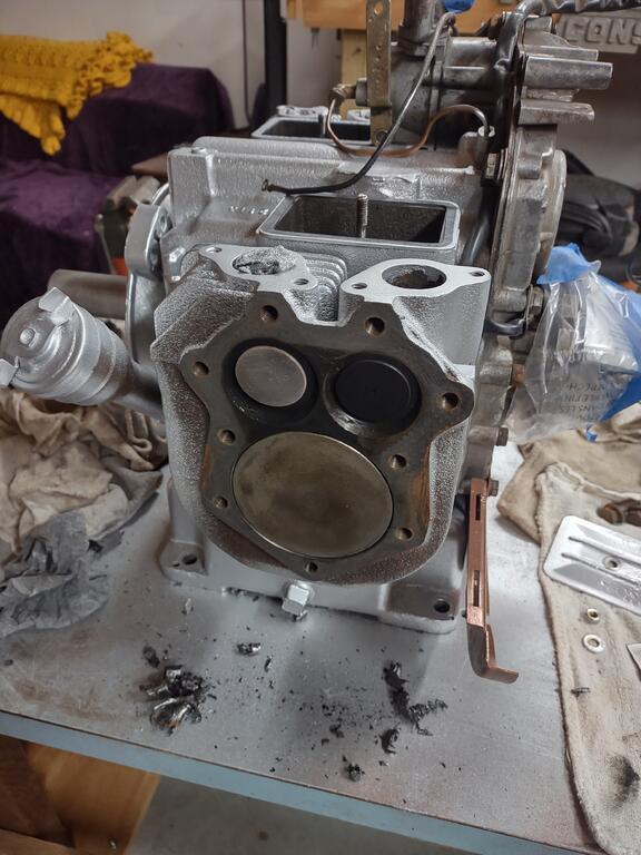

Oldskool 6,678 #1566 Posted February 9, 2022 So where do you stand on the cylinder bores? Are the heads back on? Share this post Link to post Share on other sites
ebinmaine 79,767 #1567 Posted February 9, 2022 3 minutes ago, Oldskool said: So where do you stand on the cylinder bores? Are the heads back on? Haven't been able to get back to it to try to wipe them down with a cleaning agent yet. 1 Share this post Link to post Share on other sites

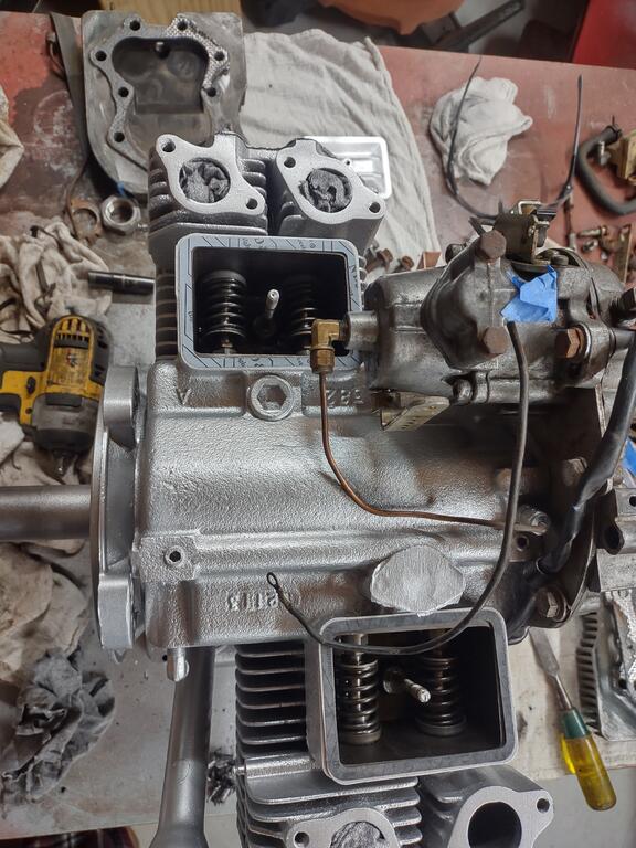

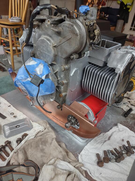

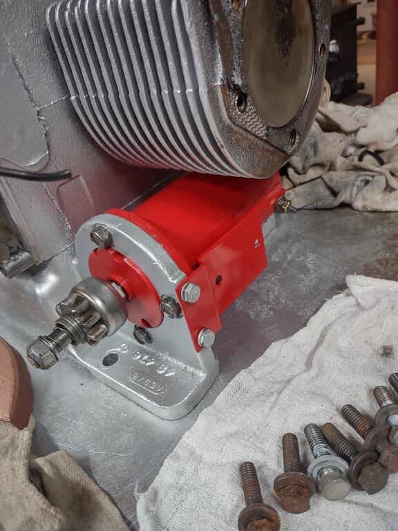

ebinmaine 79,767 #1573 Posted February 11, 2022 Got the starter put back together and mounted up. Also the first piece of engine tin. Checked all the torque values on the front cover. Tightened up a couple. Started cleaning up the end of the block. Valve clearance checked 02/10/2022 Front. Int. .018 Exh. .008 Rear. Int. 018 Exh. .008 Points checked 02/10/2022 .018 3 8 Share this post Link to post Share on other sites
Pullstart 70,823 #1574 Posted February 11, 2022 Looking good EB and BBT! 1 1 1 Share this post Link to post Share on other sites
Snoopy11 5,731 #1575 Posted February 11, 2022 3 minutes ago, Pullstart said: Looking good EB and BBT! I second that... looking sweet! Don 1 1 Share this post Link to post Share on other sites
