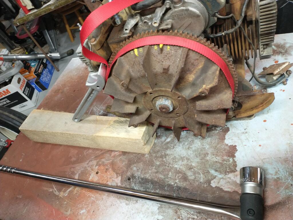

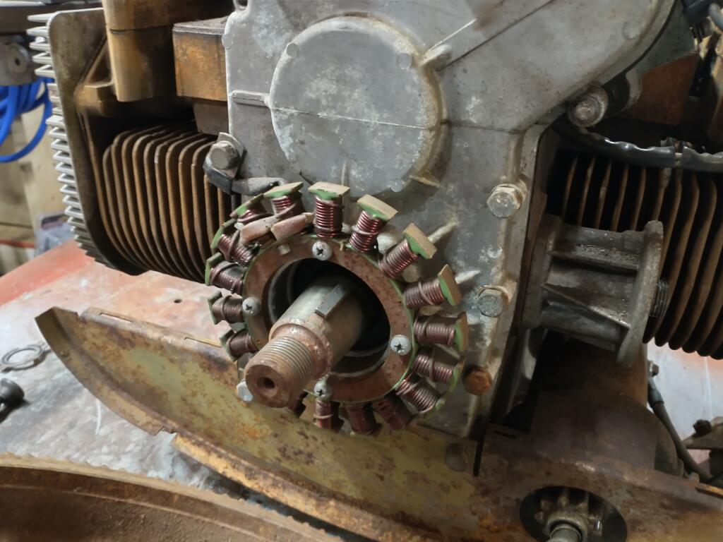

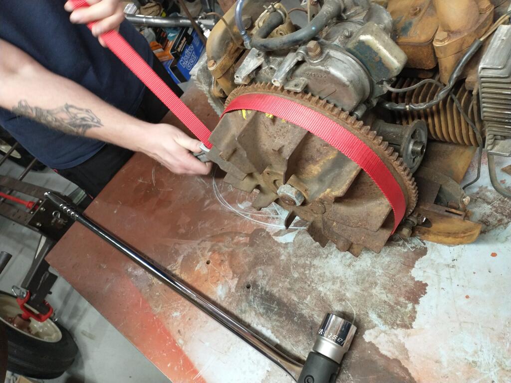

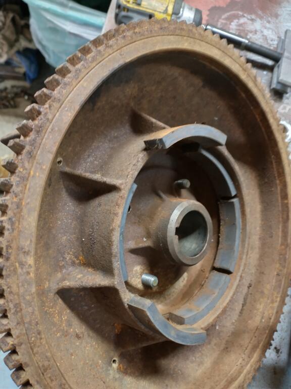

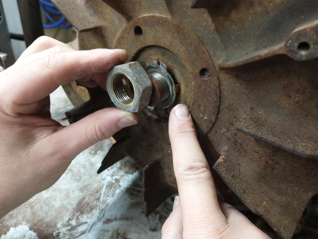

ebinmaine 80,423 #1427 Posted January 15, 2022 Here's a few pics of the flywheel coming off. I needed to remove it for multiple reasons. 1. The big thing is that I was hearing a scrape-ish noise so I figured the magnets were loose. Yepp. 2. Also while we were in there might as well remove the last piece of tin and the starter. Setting up the wrench. 51" long, 3/4" drive breaker bar was a pretty good choice. 4 2 Share this post Link to post Share on other sites
