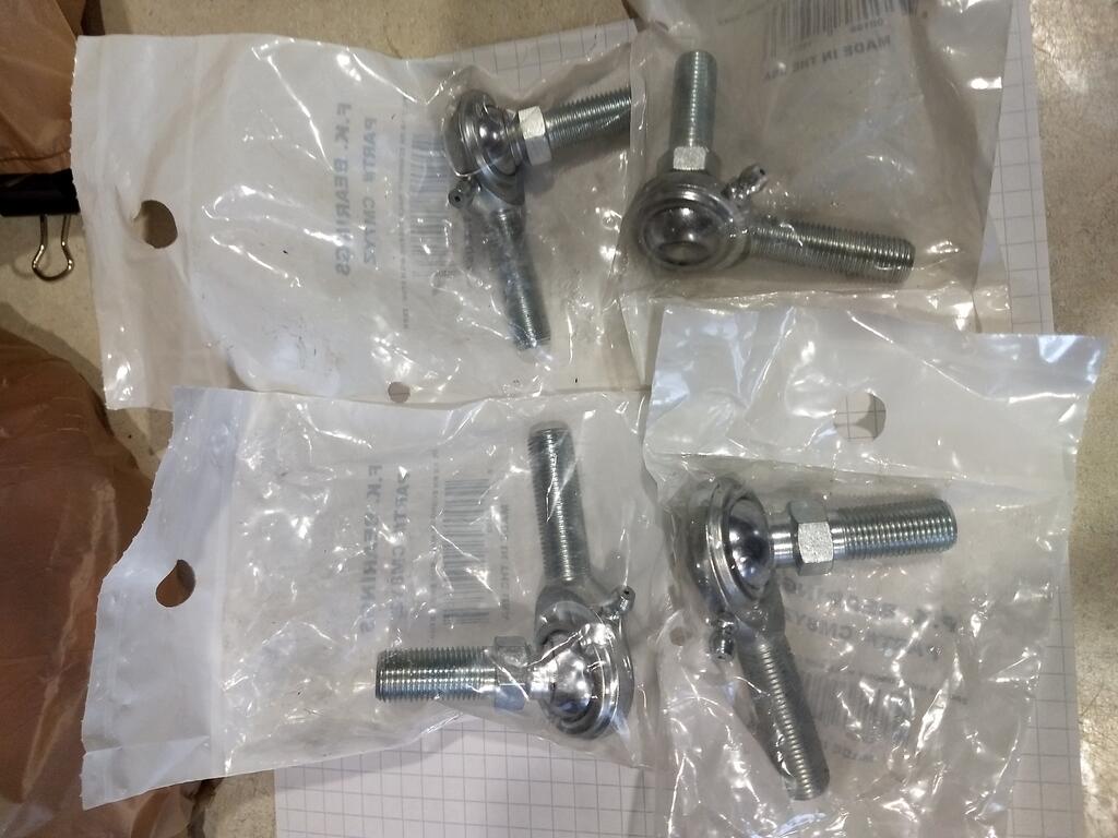

ebinmaine 81,282 #1161 Posted April 10, 2021 Tie rod ends came in from McMaster-Carr yesterday. USA made. 7/16 for the inside. 1/2 for the outside. Both greaseable. 1 6 Share this post Link to post Share on other sites

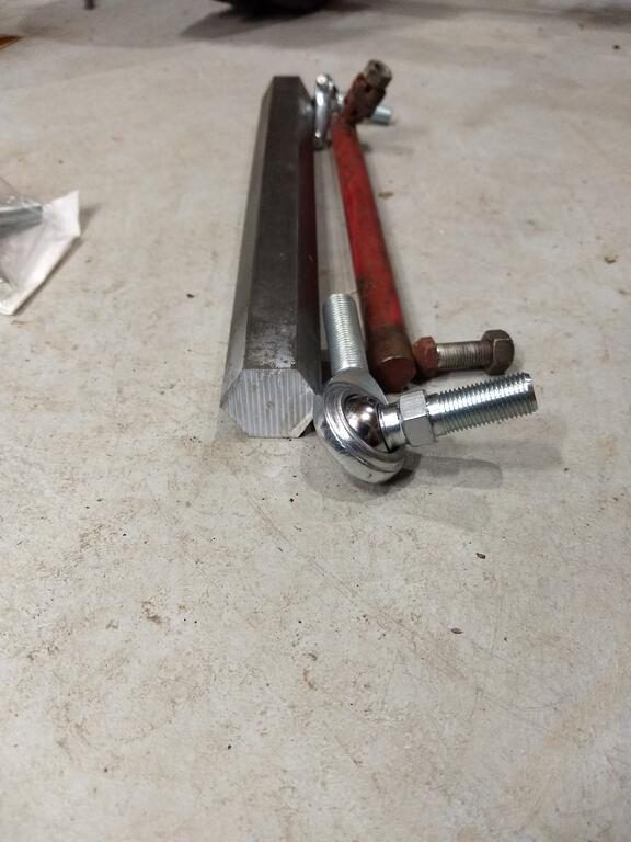

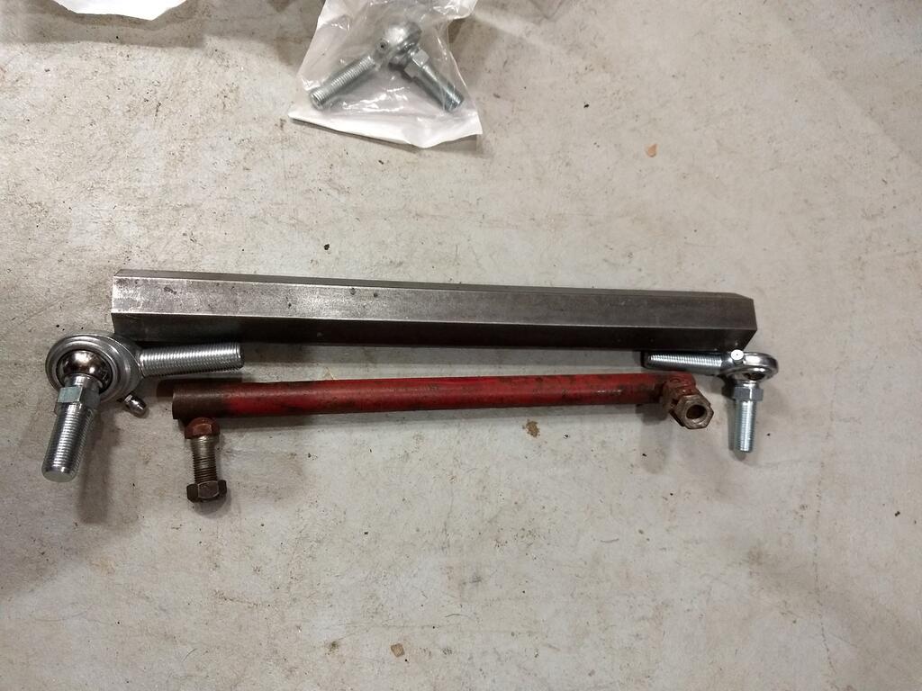

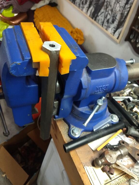

ebinmaine 81,282 #1169 Posted April 13, 2021 1 hour ago, OldWorkHorse said: Let's see the BEEF! These hex rods are 1-1/8". Here's an old stick tie rod for comparison. O. E. 5/8" diameter. 10.25 long. Custom slightly larger HD version: 13" long. 7/16 inner, 1/2" outer ends. 2 3 Share this post Link to post Share on other sites

OldWorkHorse 3,156 #1172 Posted April 13, 2021 7 hours ago, ebinmaine said: These hex rods are 1-1/8". Here's an old stick tie rod for comparison. O. E. 5/8" diameter. 10.25 long. Custom slightly larger HD version: 13" long. 7/16 inner, 1/2" outer ends. That's def gonna be solid! Can't wait to see them on colossus! 2 Share this post Link to post Share on other sites
19richie66 17,951 #1173 Posted April 13, 2021 Now you can use a Wheel Horse blade wrench to adjust you steering. 3 1 Share this post Link to post Share on other sites

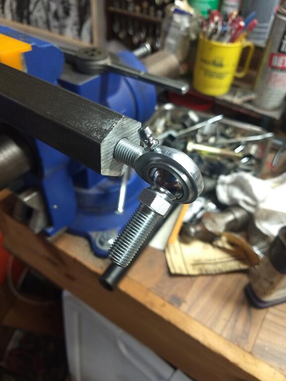

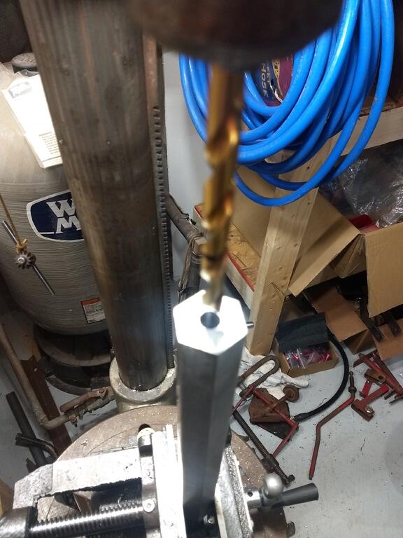

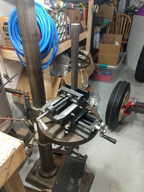

ebinmaine 81,282 #1174 Posted April 17, 2021 Did some experimenting with the big drill press and a cross slide vise I picked up a year or 3 ago. Never tried to mount the vise so that was interesting. Got that figured out and put one of the meaty hex rods in it. Checked level/plumb 7 ways to everything. Drilled a hole in one end of each rod and then tapped then for 7/16-20 thread. That's the smaller of the 2 rod sizes. Smooshed the drilled tie rod into the vise and ran a tap into it. Used the nice fresh no idea how old this oil is cutting oil. What with the rod being so high out of the vise and the vise itself being... "Not expensive".... There's a tiny bit of off parallel from the rod to the rod end. All told it was a great experience. Another tool for our home use. Now I need to figure out how to clamp round material. If anyone has suggestions I'm all ears. 6 Share this post Link to post Share on other sites
OldWorkHorse 3,156 #1175 Posted April 17, 2021 4 minutes ago, ebinmaine said: Seems like a pretty good idea! Looks good man! Share this post Link to post Share on other sites
