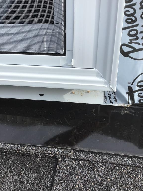

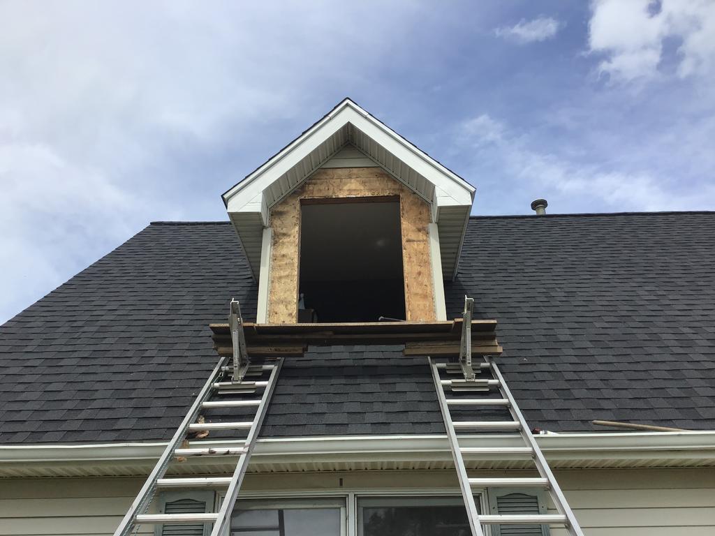

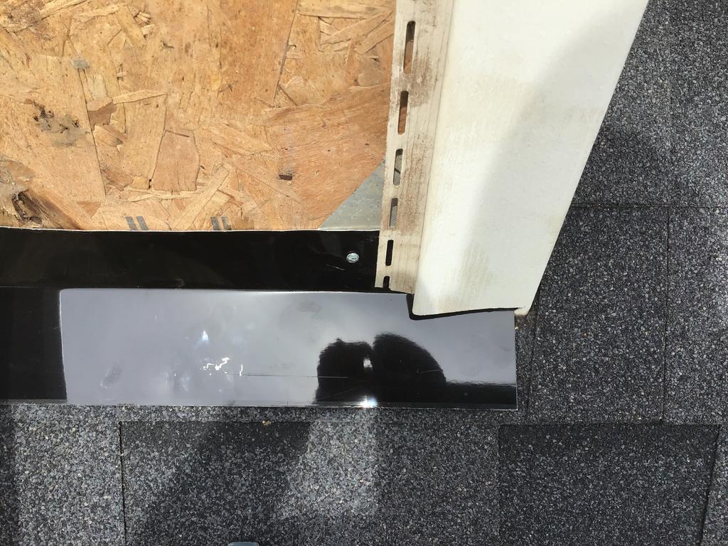

Pullstart 71,459 #1 Posted August 25, 2019 Woo hoo, I get to play with the winders today! Part of doing things, is figuring why the last guy did such a shoddy job. There wasn’t any flashing between the dormer wall and roof line, so before a bit of house wrap goes on I made this piece up. It’ll help shed water the correct way! 6 1 Share this post Link to post Share on other sites
ebinmaine 81,002 #2 Posted August 25, 2019 Nice work sir. Trina and I are quite often finding things about the way this house was finished that are questionable to say the least. Good that someone caught that and you are fixing it. 1 Share this post Link to post Share on other sites

Tractorhead 9,218 #6 Posted August 25, 2019 I would preferr a bit Sealant (neutal Silicone) to make a Water barrier between Wood and Metall. Wood has the ability to suck Water, called capillar effect. Just as suggestion. 1 1 Share this post Link to post Share on other sites

953 nut 69,931 #8 Posted August 25, 2019 1 hour ago, Tractorhead said: Wood has the ability to suck Water, called capillar effect. Are those dormers functional or decorative? If you don't need them then get rid of them! Water will accept the path of least resistance. Seal the siding from the top down and allow room at the bottom for water/ice/snow to keep from backing up under the siding. Snow accumulation on the roof and melting along the dormer edge will find a way in if you let it. You need step flashing over each shingle and up the wall at least twelve inches all the way up the sides of the dormer. Keep the lower "J" Channel up 1 1/2" or more off the roof. I would run the metal flashing on the front all the way up under the window flange. 1 Share this post Link to post Share on other sites

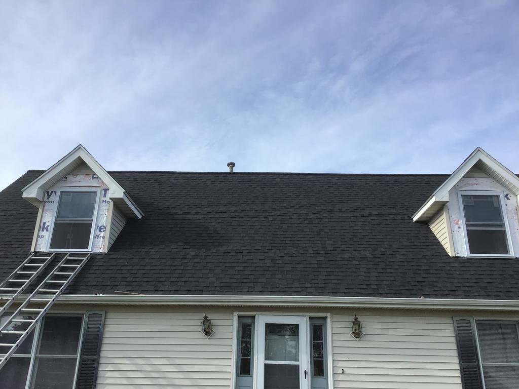

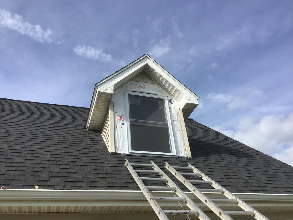

Pullstart 71,459 #11 Posted August 25, 2019 They’re both in! I need to follow with some tape and finish the water shed. They are functional so will need to stay, but I’ll do my darndest to make ‘em work for me and not against me! 3 1 1 1 Share this post Link to post Share on other sites

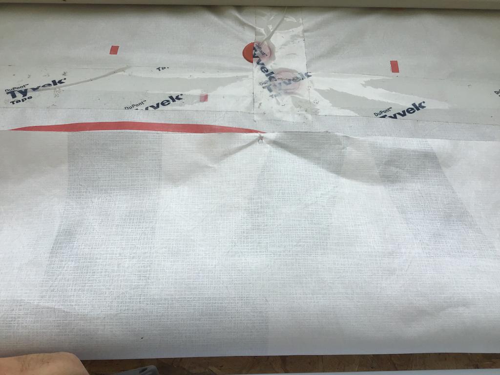

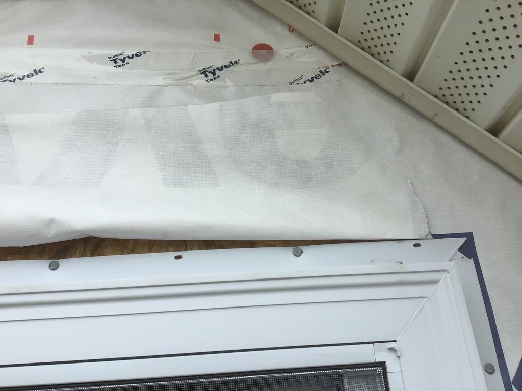

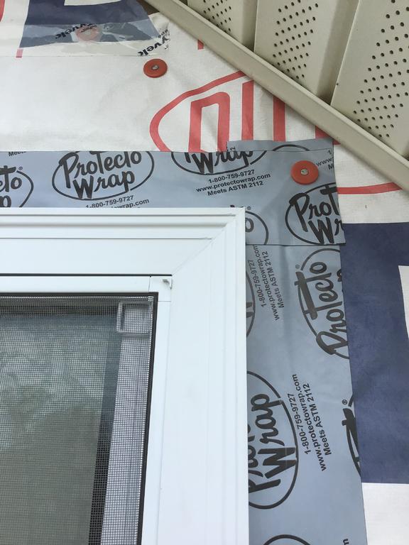

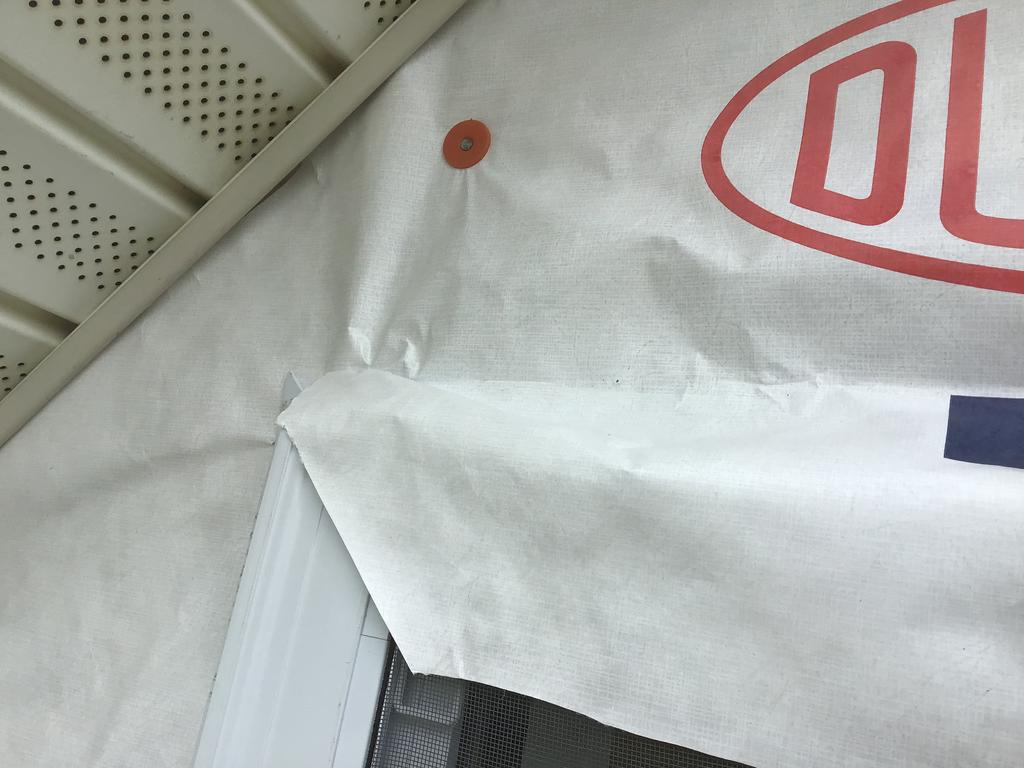

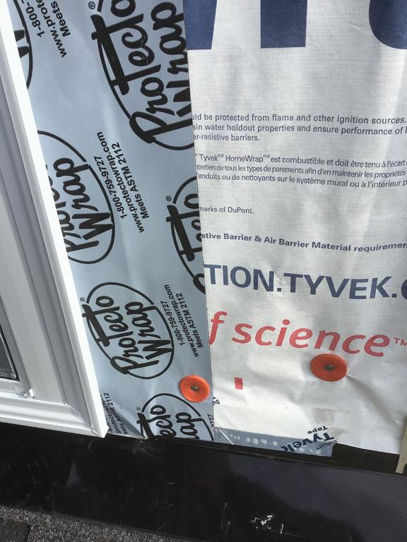

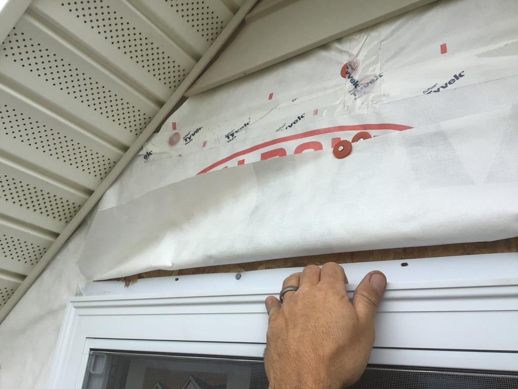

Pullstart 71,459 #15 Posted August 26, 2019 @jabelman keeping the water shed in mind... the house wrap gets tucked into the side openings and nailed or stapled in place. The top gets slit a couple inches up and left long... then tracked out of the way. That was done last night. Today, I trimmed the to flap to expose some of the nailing strip but still have the ability to shed water. I prefer to seal the bottom from the inside, tape the sides, then the top of the window. A couple nails on the ends of the tape help to keep everything in place while I press all the tape firmly. All of this sheds water, but also gives it a place to go in the event it does get in. I’m sure there are plenty of videos how to do this, in much more detail. Share this post Link to post Share on other sites
The Tuul Crib 7,354 #16 Posted August 26, 2019 It all looks correct! Should be fine! 1 Share this post Link to post Share on other sites

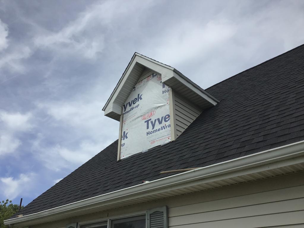

Pullstart 71,459 #17 Posted August 26, 2019 Backing up a bit, here’s the top flap detail... Share this post Link to post Share on other sites

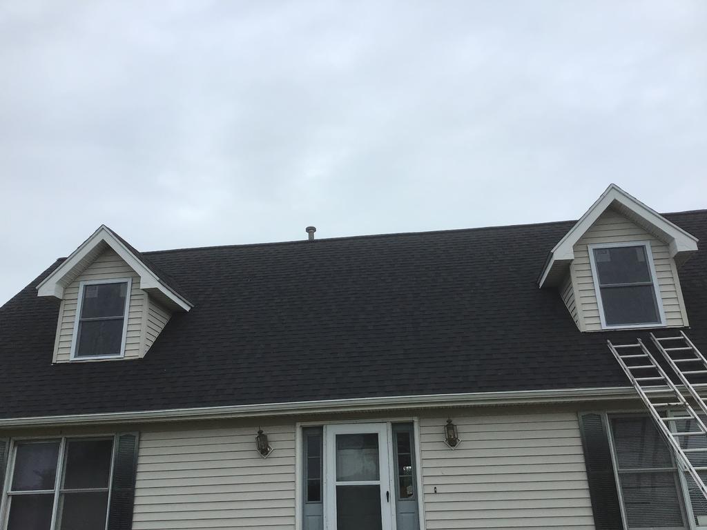

Pullstart 71,459 #18 Posted August 26, 2019 Finished before the storms hit! 2 1 Share this post Link to post Share on other sites
The Tuul Crib 7,354 #19 Posted August 26, 2019 11 minutes ago, pullstart said: Finished before the storms hit! And you didnt fall off the roof!! 1 Share this post Link to post Share on other sites
