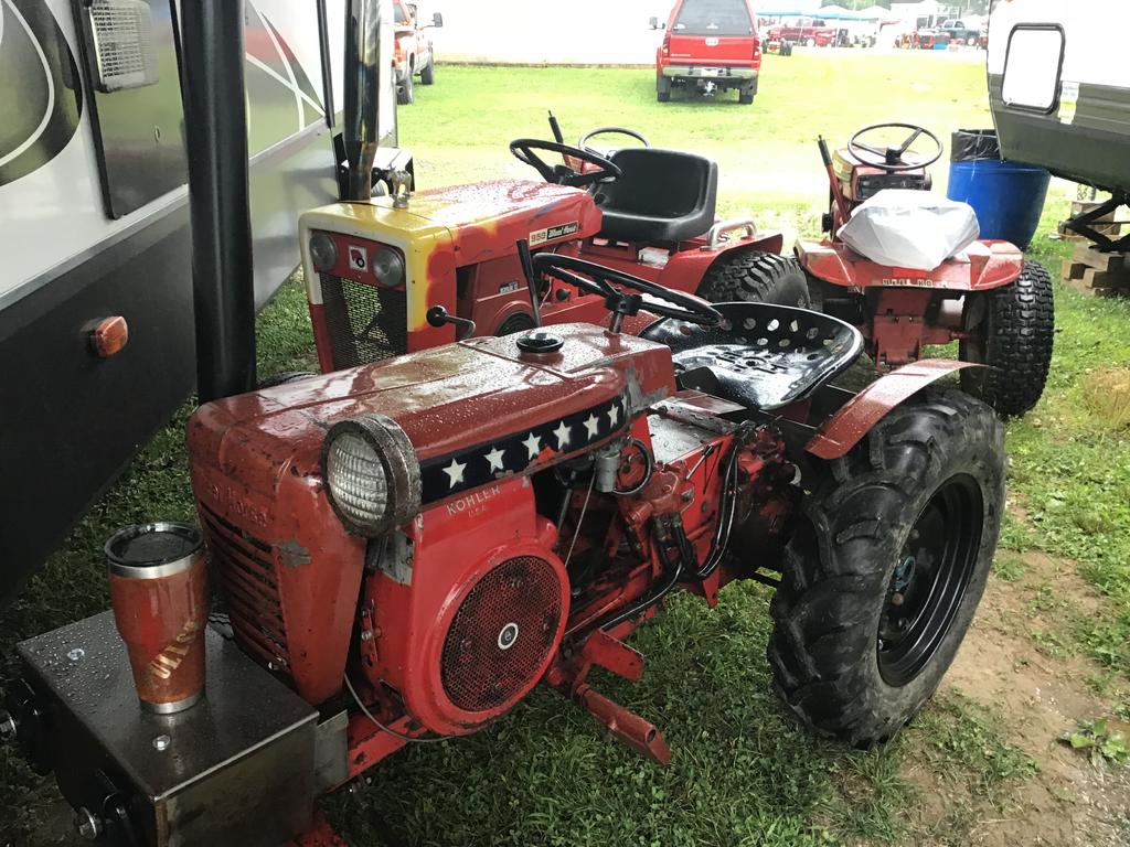

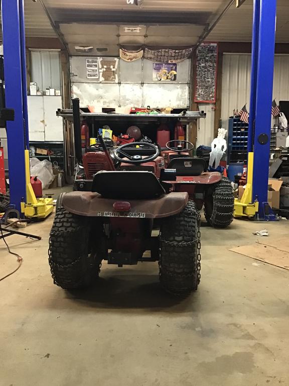

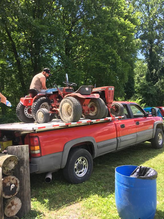

Pullstart 71,482 #22 Posted September 7, 2019 40 minutes ago, ebinmaine said: Not to be hijacking the thread but will those 15" axles "bolt in" and replace the (12"?) Axles in an 8 speed? If so, would that be ok to widen the stance on Colossus? I’ve got a feeling that Rylee’s Screamin’ Jimmy has had an axle transplant using something wider... It’s got a super wide stance compared to Jada’s or any other of our 60’s tractors. 2 1 Share this post Link to post Share on other sites
953 nut 70,057 #23 Posted September 7, 2019 44 minutes ago, pullstart said: Rylee’s Screamin’ Jimmy has had an axle transplant using something wider. If they are 1 1/8" that could be. Share this post Link to post Share on other sites
Pullstart 71,482 #24 Posted September 7, 2019 14 minutes ago, 953 nut said: If they are 1 1/8" that could be. I think they’re only 1”... but he to hub that axle is much wider than other ones in the barn by far Share this post Link to post Share on other sites
