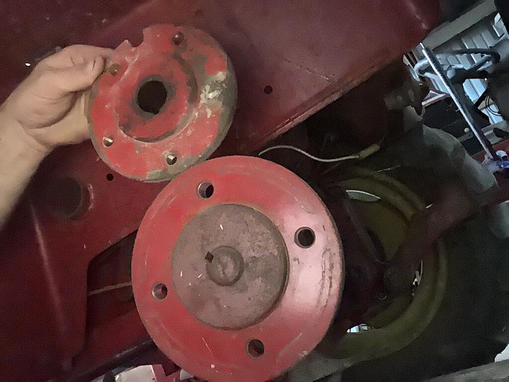

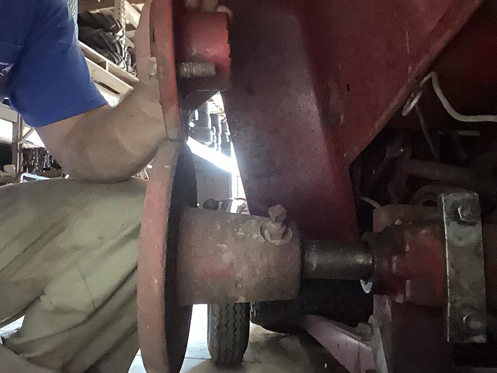

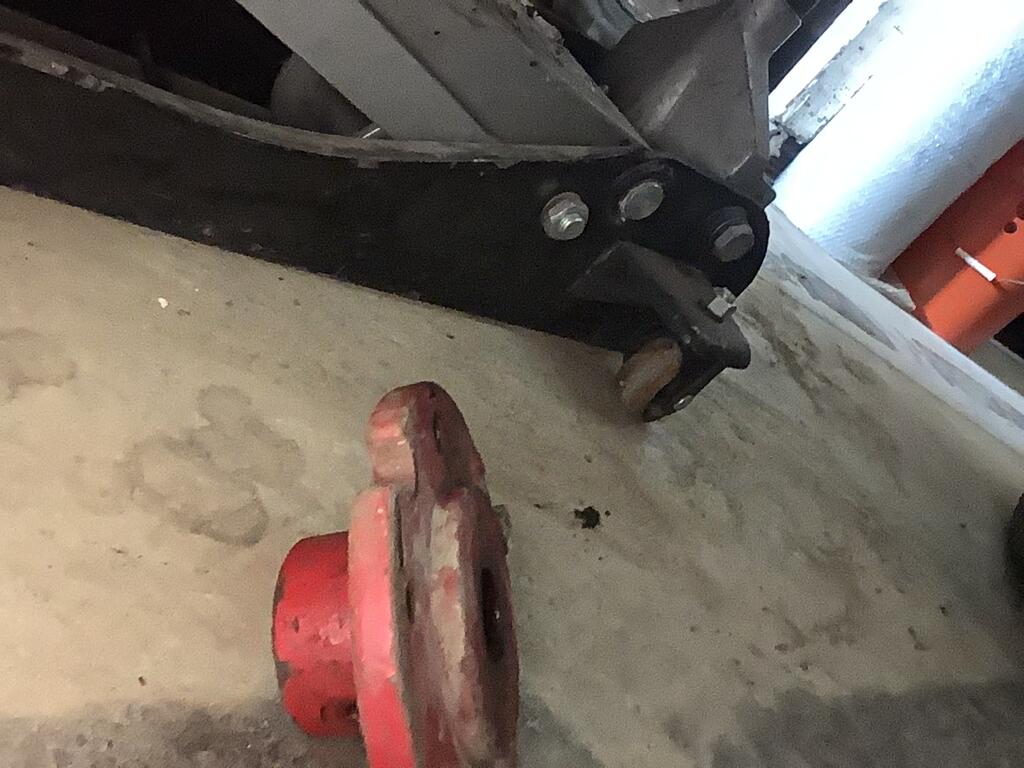

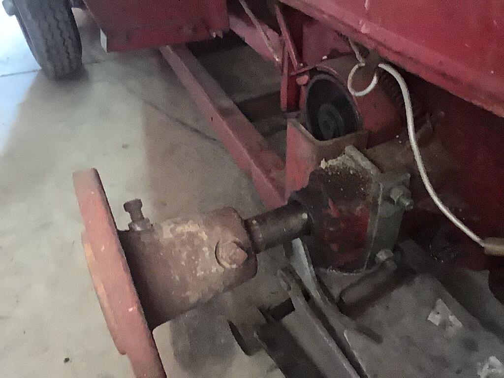

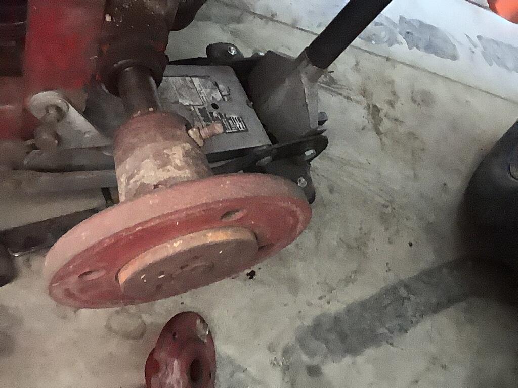

The 4 lug hubs are BEASTS compared to the 5 lug flavor.  Why less holes and more strength?  I’m not sure.  They have much longer keyways, heavier castings, thicker flanges, etc.

@Pullstart are the 5 lug hubs a direct bolt on or did you buy/get/make some to fit?
Assuming the axles on the big wheel models are also beefier?

They are still 1-1/8” axles, same width and height keyway… so direct swap.  The 4 lug axle shafts have an RX keyway if I recall… they are a deep half moon and about 2” long.

Quite the difference. Do you think the difference in hubs has something to do with the availability in wheels/rims and tyres back in the day?

sure could have been

I think it is a mater of physics. Larger diameter tires will subject the hub and axle to more forces when they are cornering or have side force applied to them.

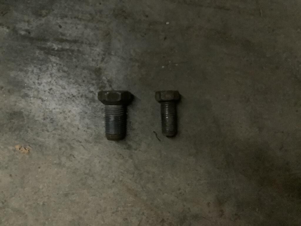

@sjoemie himself lug bolt comparison too.  Big one = 4 lug.

Heavier hardware makes sense, 4 studs to transfer power or at least clamping force instead of 5 means more stress per bolt.
Also the forces on the hubs are greater with larger wheels for sure.
Funny thing though.. on cars.. older and lighter(!) cars have 4 studs and the newer and thus heavier cars have 5 studs. Well around here anyway. To make it easier (not) the stud patterns differ between cars.. obviously :P
