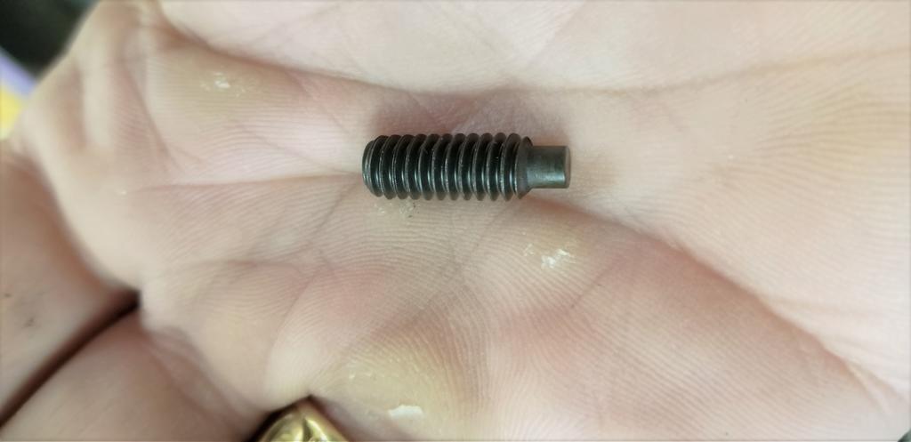

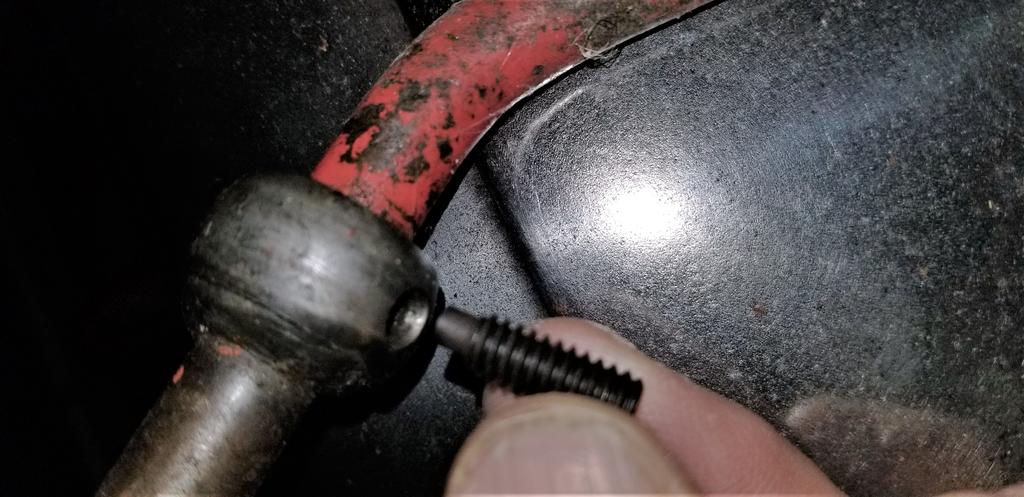

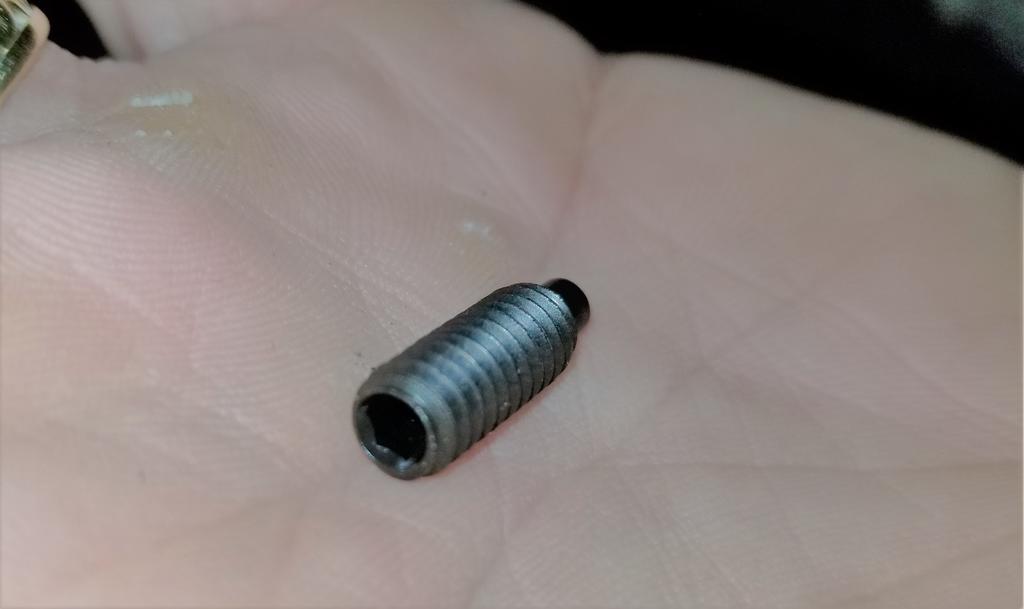

AMC RULES 37,259 #28 Posted August 21, 2019 This is the specific type of set screw you need to retain, and adjust tension on your shifter... have one of these "Dog Point" set screws Charley? 2 1 Share this post Link to post Share on other sites
AMC RULES 37,259 #29 Posted August 21, 2019 Allen head, screws into that collar in top of your trans... adjust the tension to allow the shifter to pivot through all four gates. 2 1 Share this post Link to post Share on other sites

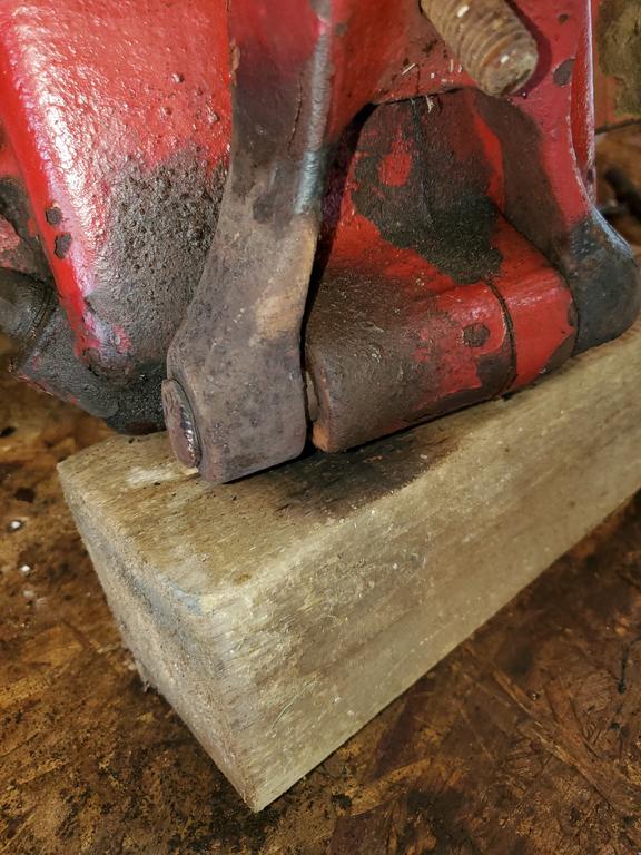

Charley 40 #47 Posted August 21, 2019 Is there something special to getting this pin out. I don't see a roll pin it moves about 1/16th back and forth but wont drive out. 1 Share this post Link to post Share on other sites
stevasaurus 23,849 #48 Posted August 21, 2019 This is one of the things that make opening the trans hard. If it moves at all, you can heat, and soak (like PB blaster, candle wax, etc) and keep working it. File the ends so there are no burrs...an air hammer with a punch is a good option. I have also used a Sawsall to cut the 1/2" soft steel in between the hitch and the trans to get to where you can pound it out. You can buy the 1/2" steel at Ace or Tractor Supply to make a new pin. Patience and a case of beer go a long way. There is a groove on each end of the pin that should hold a 1/2" "C" clip to hold the pin in place. 2 1 Share this post Link to post Share on other sites
953 nut 69,175 #49 Posted August 21, 2019 1 hour ago, stevasaurus said: cut the 1/2" soft steel in between the hitch and the trans to get to where you can pound it out. You can buy the 1/2" steel at Ace or Tractor Supply to make a new pin. Steve, I think you will find that they are 3/4". Lowell sells the pins and they are nice. https://www.wheelhorsepartsandmore.com/hitches-liftkits.html#!/Toro-Wheel-Horse-Hitch-Pin/p/84954775/category=23548047 I have cut the pins on both sides of the transmission and then drilled them with progressively larger drill bits until they are weakened to the point that they will give up. The heat produced by the drill bit may help. 1 1 Share this post Link to post Share on other sites
Charley 40 #50 Posted August 22, 2019 I got her out, took a little heat, I'll put a new one in this one has been beat up 2 Share this post Link to post Share on other sites
