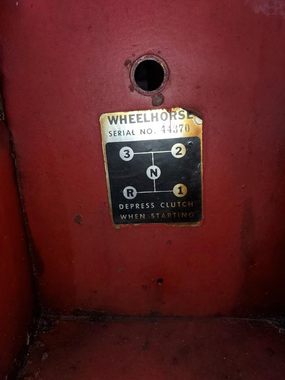

Charley 40 #1 Posted August 20, 2019 This is all the info I have, what year and modle is this? Serial # 44370 1 Share this post Link to post Share on other sites
953 nut 69,175 #3 Posted August 20, 2019 Looks like a 1964 model 854 to me. 1 Share this post Link to post Share on other sites
Charley 40 #4 Posted August 20, 2019 Thats great, thank you. Does 854 have any special meaning. Such as what HP the engine is? Share this post Link to post Share on other sites
Achto 32,643 #5 Posted August 20, 2019 (edited) 1 hour ago, Charley said: Does 854 have any special meaning. Such as what HP the engine is 8 = horse power 5 = standard transmission / electric start 4 = the year on the 1960's models. In this case 1964 It is a shame that part of your gas tank is missing. Edited August 20, 2019 by Achto 3 Share this post Link to post Share on other sites

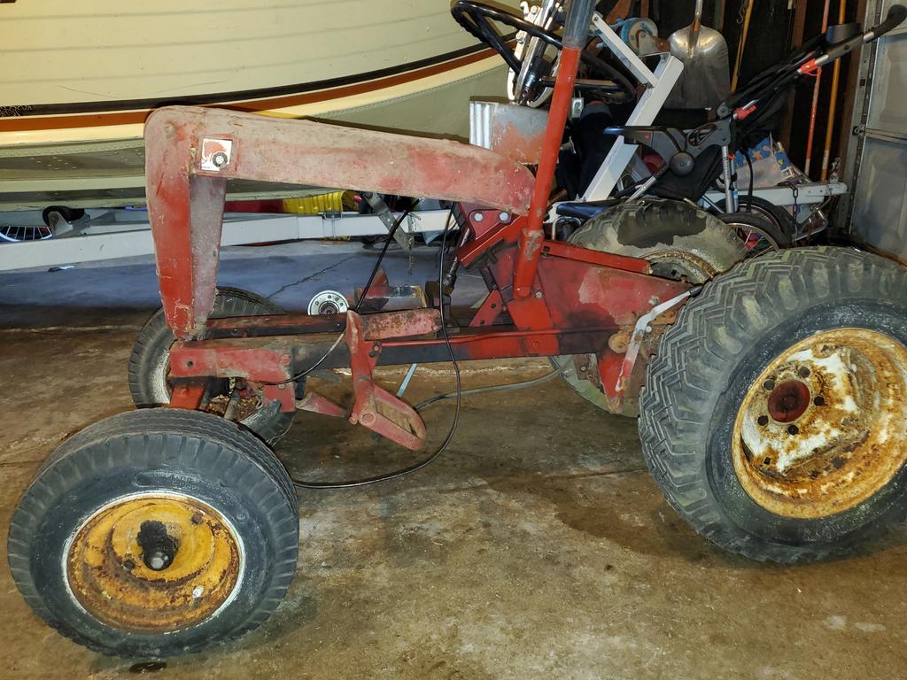

WHNJ701 4,173 #6 Posted August 20, 2019 (edited) interesting hack job on the gas tank and the shifter is reversed?? Edited August 20, 2019 by jabelman Share this post Link to post Share on other sites
Charley 40 #7 Posted August 20, 2019 Somebody cut the tank off, I don't know why SMH, I have a new one and the gear shift has come disconnected from the inside so its all willy nilly!!! Thats a job im a little nervous about. I think i have to split the case to put it back in its home. I don't know anything about that though... 1 Share this post Link to post Share on other sites
WHNJ701 4,173 #8 Posted August 20, 2019 no the gear shift just fits right in between the shift forks, should take you 2 minutes to get it in 1 Share this post Link to post Share on other sites

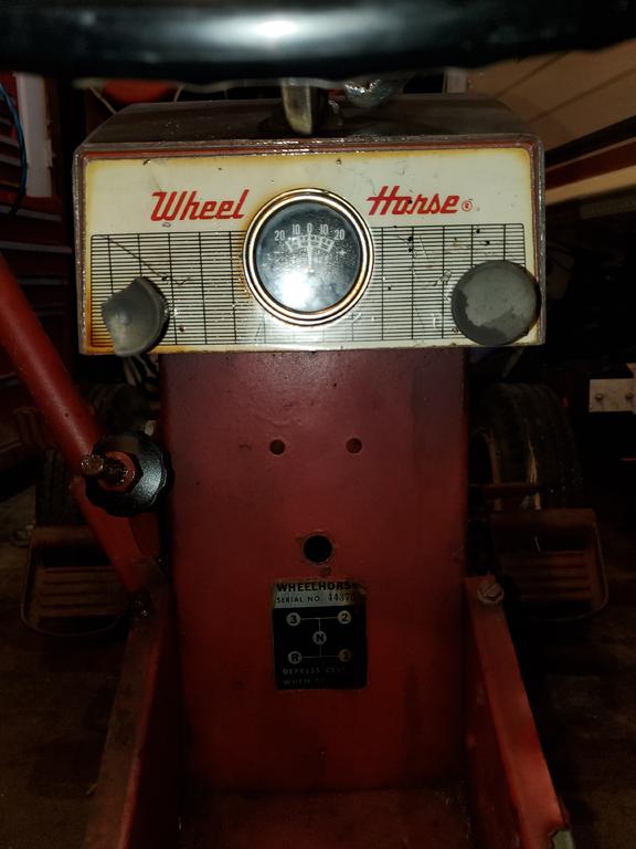

CasualObserver 3,416 #13 Posted August 20, 2019 @Charley It has the wrong frame for an 854.... the front axle looks to be tucked under a flat front. The rear fenders look awfully pointy, like the 701 fenders, but you have the left side shield which did not come on the 701. Maybe it's just the angle of the picture. Is there anything on that belt guard laying in the bed of the truck? Perhaps a number that ends with a 2? Can we see more pictures please... like the hood and the dash? 1 Share this post Link to post Share on other sites
CasualObserver 3,416 #14 Posted August 20, 2019 The serial number seems like it should fall in 63... but the frame would be wrong for that too.... perhaps this is a mutt of available parts? Share this post Link to post Share on other sites
Charley 40 #17 Posted August 20, 2019 1 hour ago, AMC RULES said: You'll find there is a set screw in the front of the collar that the shifter handle drops into. So i did find where the set screw should go but when i put the lever in it doesn't function. I dont understand the mechanics of how it should operate. Share this post Link to post Share on other sites

CasualObserver 3,416 #23 Posted August 21, 2019 Nevermind my observations.... it does appear to have the correct frame for a 63 or 64.... still need to see the dash to see. The 854 had the silver and black dash, the 63 models would be white. Share this post Link to post Share on other sites
