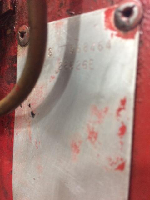

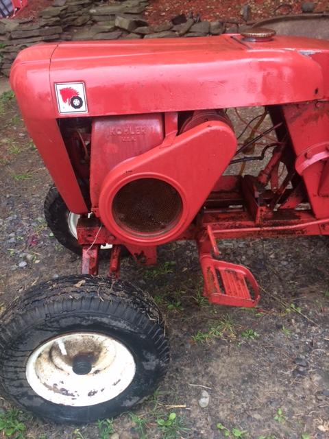

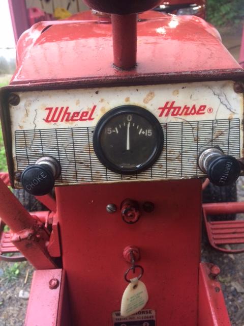

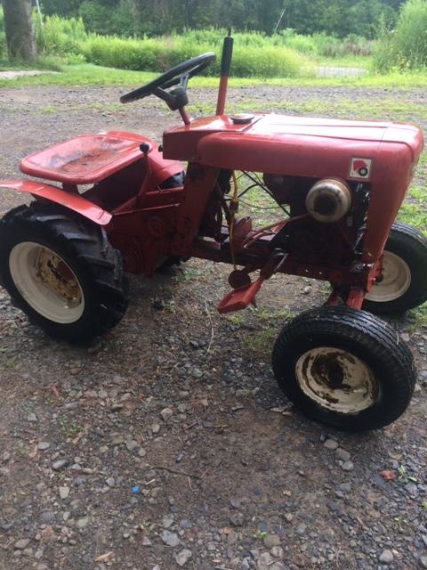

mooman3121 58 #1 Posted August 13, 2019 Hi all! I just recently picked up this old tractor and I am not sure that it is a 854 as the owner claimed. I have seen pics of 854 gas tanks on here and the dash board looks different than mine. Please take a look at my pics and let me know what this might be and what the engine might be, and if I have the correct mower deck. it looks to be all original to me but even the engine plate was all painted over and faded. Thanks! 4 Share this post Link to post Share on other sites
CasualObserver 3,406 #2 Posted August 13, 2019 Serial tag starts with 62... they only did that in 1962 and used the tags up in early 63, Flat front frame /front axle mount indicates 1962... and it has a Kohler. If original engine... you have a 702. If engine was replaced... could have been a 552 or 702. 7 1 Share this post Link to post Share on other sites

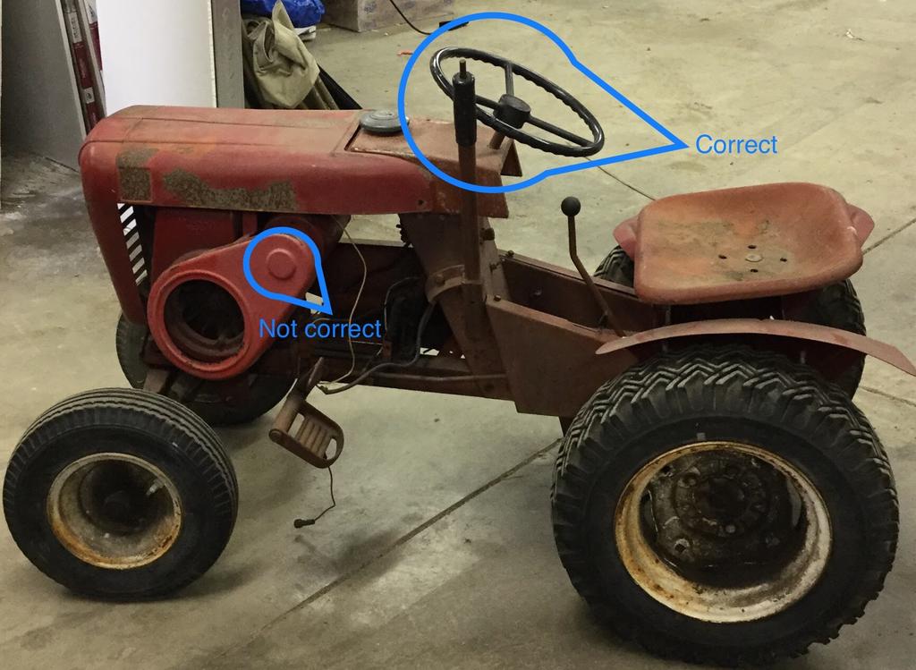

gwest_ca-(File Mod) 10,479 #3 Posted August 13, 2019 Sure looks like a 702. Do you have the drive belt guard for the transmission? Necessary for the clutch to work. Click on the picture. Garry 4 Share this post Link to post Share on other sites
stevasaurus 22,229 #4 Posted August 13, 2019 Definitely a 702...1962. That serial number fall in-between my 502 and 702. The spec # 28626E is correct for the K161S 7 hsp Kohler. Also correct seat for the 702. Correct steering wheel also. I also think that mower deck is also right for that horse. You do need a belt guard to make it drive-able. The guard funnels the slack toward the engine drive pulley when you step on the clutch. This stops the transmission input pulley so you can shift the transmission with out grinding the gears. Nice find. edit...not the correct steering wheel...I stand corrected 5 Share this post Link to post Share on other sites

ACman 7,505 #7 Posted August 13, 2019 (edited) 3 hours ago, stevasaurus said: Correct steering wheel also. ....that looks like a C-series steering wheel. Should have a three spoke . It does however have the correct 1962 one year only starter/generator belt guard (flat ...no bump on s/g end) and the lift lever has detent not the dial adjust that came in 63 . Get a a good picture of the dealership sticker and see if it’s listed and/or add picture to the dealership list thread. Edited August 13, 2019 by ACman 3 Share this post Link to post Share on other sites
stevasaurus 22,229 #8 Posted August 13, 2019 Jeff is correct about the steering wheel. It is the same one I have on my 702, but the correct one is on my 502 in the second picture. Thanks @ACman 2 Share this post Link to post Share on other sites

mooman3121 58 #11 Posted August 13, 2019 thanks for pointing out the steering wheel issue- I knew it was not the right one from the start, as they had NO padded wheels back then! LOL! 1 Share this post Link to post Share on other sites
