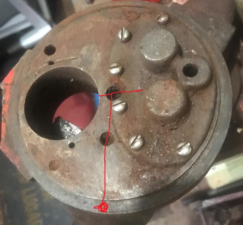

adsm08 4,797 #29 Posted September 15, 2019 OK, so the center hole on this unit is where the rod to hold the fluid reservoir threads in. The red circle I drew is the location of a plug that is for accessing the pressure spring and check ball, which sit in a passage that connects to the gear chamber's discharge. This is where I have been filling it because it is the biggest hole in the case. The T section of the line I drew is the passage that runs from the gear chamber over to the valve's bore. Share this post Link to post Share on other sites
wheelhorseman 3,256 #30 Posted September 15, 2019 Do you have a picture of the shaft side of your pump? Share this post Link to post Share on other sites

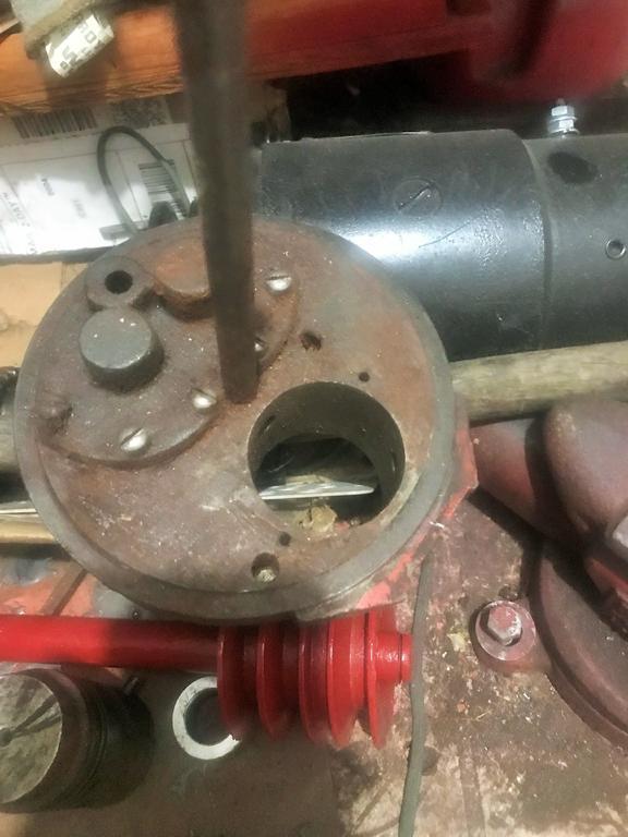

adsm08 4,797 #42 Posted September 18, 2019 OK, so I have been having some issues with the proposed test. Like I don't have a drill the pulley shaft fits in. I was able to spin it up by hand fast enough to get oil up to the valve bore with the reservoir shaft out. That's a big hole in that passage. I'm starting to wonder if the shaft isn't in tight enough and is causing an internal leak. The port that is getting no flow is on top, and would have to fight gravity as well. The port that works is nearly level with the gear chamber when the pump is installed in the tractor. Share this post Link to post Share on other sites
Tractorhead 9,217 #43 Posted September 19, 2019 5 hours ago, adsm08 said: I'm starting to wonder if the shaft isn't in tight enough and is causing an internal leak. i had suspected that. but i didn‘t have a manual or a part, where i can compare, how it must be and where can be the fail. Another thing i wonder, basicly oilpumpgears must fit snug in case, without to much gap. i wonder if you told you can rotate the shaft fast enough, normally if the pump is well, also slow motion is enough to move some oil. i suggested the Accudrill just for a continouse rotation, not for the rotation speed. that means if you press your finger to the Bore in Valvehousing faced to the pump and you rotate the oilpump by hand (even slow) you must feel a massive resistance on the Pumpshaft while rotate. if not, your pump seems not to work well. Do you have calipers Share this post Link to post Share on other sites

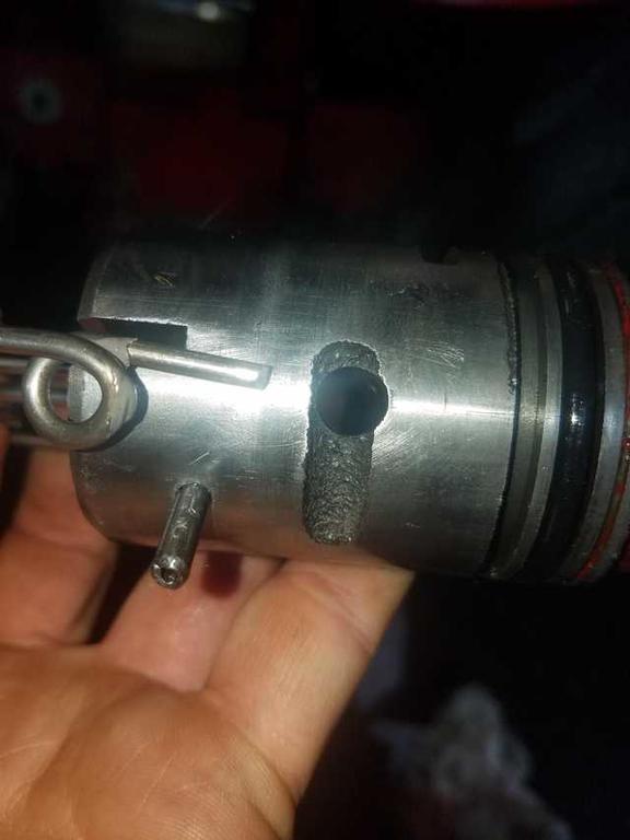

adsm08 4,797 #45 Posted September 21, 2019 OK gentlemen. I found, and fixed the issue, which it would appear I also caused. Sticking out of the side of the valve in this picture is a roll pin. It's primary purpose, as far as I can determine, is to set the depth of the valve in the pump body. Normally at full rotation it can contact the shaft that holds the reservoir on. I did not have this roll pin fully installed, and it was contacting the gear cover, cutting out the last few degrees of valve rotation, and keeping the fluid control passage from lining up with the upper port. I found it while doing a final post assembly check of everything, before putting the return spring and line adapters in. If it hadn't been for some of the ideas put in my head by @Tractorhead's suggestions I may never have tried rotating the valve before putting the spring in, and my not have ever caught it. I tapped the pin in the rest of the way, assembled everything, and now it works again. Looks like it doesn't even leak. Special thanks to @Tractorhead @wheelhorseman @Lane Ranger and everyone else who contributed to figuring this out. 1 1 Share this post Link to post Share on other sites
