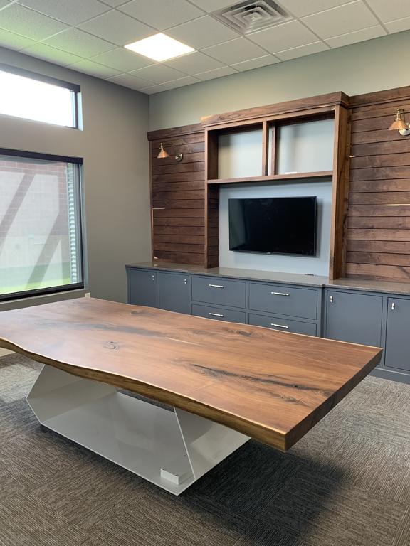

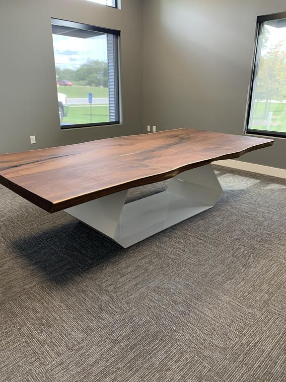

Jennifer 1,878 #128 Posted September 1, 2019 On 8/31/2019 at 7:23 AM, pullstart said: I received these pictures from the customer last night. The table top needs to be drilled now for inserts then we can screw the two together. There will be ivory in the chairs and all the cabinetry handles are deer antler. All the woodwork is from the same tree, remember! Wasn’t for sure what to expect as I did not quite understand the blue prints, However talk about breathtaking!!! Wow you have a real talent! God has blessed you! 4 1 Share this post Link to post Share on other sites

formariz 12,381 #130 Posted September 2, 2019 @pullstart Ensure that the fastening method to the slab allows it to expand and contract across the grain. Depending on atmospheric conditions that slab will change in width as muck as one inch. If it’s movement is restricted it will inevitably crack. Slots rather one round holes in base are one of doing it placing fastening screws in center of slots. 1 2 1 Share this post Link to post Share on other sites
Pullstart 71,567 #131 Posted September 2, 2019 Thank you everyone for the kind comments! Cas, I drilled the holes in the strapping oversized so I can use large washers and allow for movement. I had the breadboard ends in mind when I drilled them 1 Share this post Link to post Share on other sites

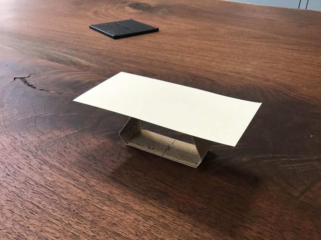

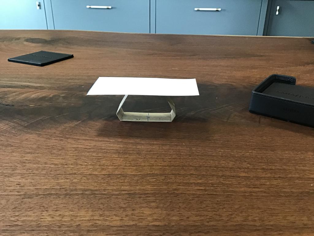

Pullstart 71,567 #136 Posted September 4, 2019 I’d say we nailed the scale model! 3 1 Share this post Link to post Share on other sites

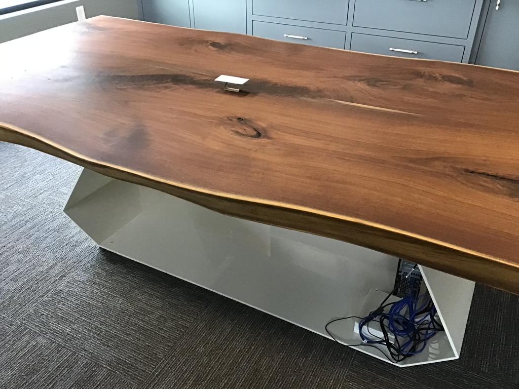

953 nut 70,664 #141 Posted September 5, 2019 They need to tidy up the electronics, couldn't that be suspended from the bottom of the table top? Share this post Link to post Share on other sites
Pullstart 71,567 #142 Posted September 5, 2019 11 minutes ago, 953 nut said: They need to tidy up the electronics, couldn't that be suspended from the bottom of the table top? Absolutely! He has a PC bracket on the way along with white wire loom too 1 1 Share this post Link to post Share on other sites
