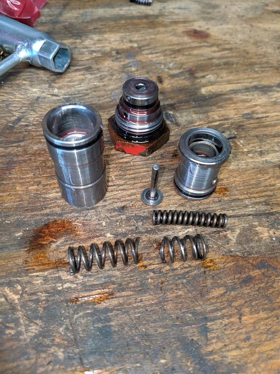

WildmanC120 613 #1 Posted July 9, 2019 (edited) Well I picked up this GT14 in the fall. I have not done much with it but I knew the hydro was real weak. Finally got it into the shop today and pulled apart the accelerator valve section to fins carnage in both side. Now...what parts do I need and where do I get them???? I need a small spring, a big spring and one of the plungers that goes into the small spring. I would upload pics but for some reason it says I can only upload 246k. Didn't know there was some kinda limit???? Edited July 11, 2019 by WildmanC120 Share this post Link to post Share on other sites

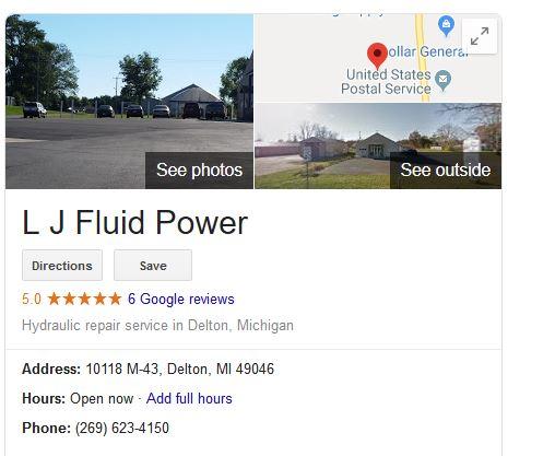

pfrederi 20,688 #9 Posted July 9, 2019 LJ Fluid power is best source for new parts. GT14s had hydro gears. beyond the tune up the service manual doesn't have much. WH viewed then as "Repair by Replacement" You can do some resurfacing of the pistons and valve plate in the pump side but the hydro gear for the motor isn't something you can resurface. 1 Share this post Link to post Share on other sites

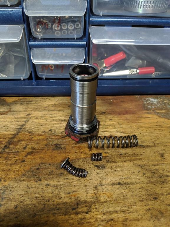

WildmanC120 613 #15 Posted July 11, 2019 OK... so here are the pics of the pieces that came out. 1 1 Share this post Link to post Share on other sites
953 nut 66,699 #16 Posted July 11, 2019 I don't know if the springs are out there anymore, but a few years ago member @refracman was able to hook me up with a fellow who had the springs. Don't mix up the forward (one to the rear) and reverse (one to the front) valves as they have different size passages making reverse slower. 1 Share this post Link to post Share on other sites
WildmanC120 613 #17 Posted July 11, 2019 2 hours ago, 953 nut said: I don't know if the springs are out there anymore, but a few years ago member @refracman was able to hook me up with a fellow who had the springs. Don't mix up the forward (one to the rear) and reverse (one to the front) valves as they have different size passages making reverse slower. Thanks for the info. Hopefully he chimes in and we can get this sorted. If push comes to shove I can bring the pieces to a local machine shop and have that plunger made and I'm sure they can measure the springs and order something comparable. Just at what cost... Share this post Link to post Share on other sites
pfrederi 20,688 #18 Posted July 11, 2019 1 minute ago, WildmanC120 said: Thanks for the info. Hopefully he chimes in and we can get this sorted. If push comes to shove I can bring the pieces to a local machine shop and have that plunger made and I'm sure they can measure the springs and order something comparable. Just at what cost... Check with Lincoln at a-z I got some of them from him awhile back. 2 Share this post Link to post Share on other sites
WildmanC120 613 #19 Posted July 26, 2019 Ok so I have the parts I need now thanks to AZ. Does anyone have a pic or remember the order in which these go back on? I have kinda forgot over the past few weeks. Share this post Link to post Share on other sites
gt14rider 1,207 #20 Posted July 26, 2019 Does this help 3 3 Share this post Link to post Share on other sites
WildmanC120 613 #21 Posted July 27, 2019 On 7/26/2019 at 9:13 AM, gt14rider said: Does this help That was very helpful TY. Got the trans back together now. it definitely has a lot more power then it did before. I'll change the filter and whats left of the flud and see how it does. 1 Share this post Link to post Share on other sites
