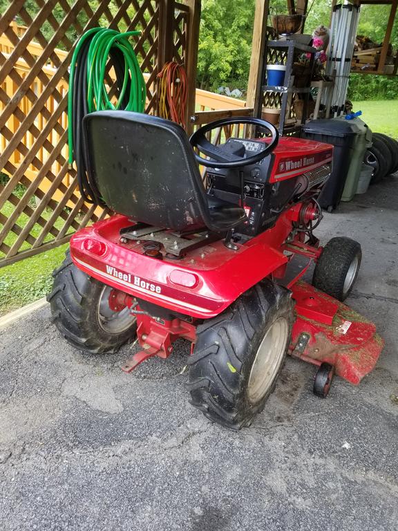

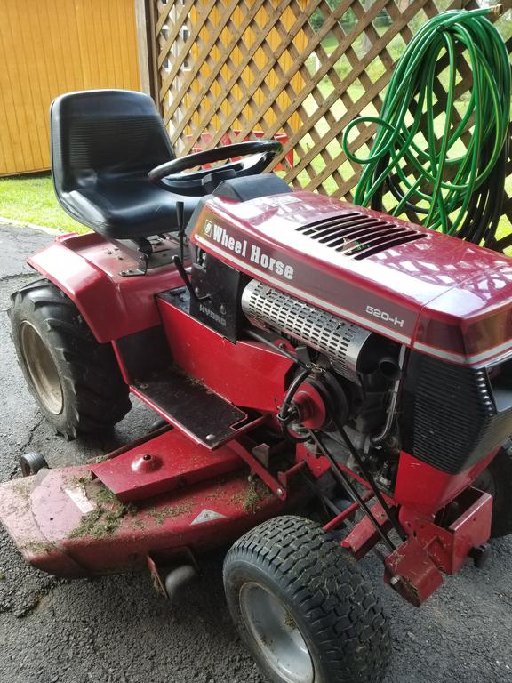

RunningMajorK 7 #1 Posted July 7, 2019 Just picked this baby up today, did a little research. Thinking it's a 88' or 89'. Model# 3120oE01 has the P220 Onan engine. Can someone confirm and suggest a snow blade? 2 1 Share this post Link to post Share on other sites
Vinylguy 4,796 #2 Posted July 7, 2019 A very nice 1988 520-H 3 Share this post Link to post Share on other sites
RunningMajorK 7 #3 Posted July 7, 2019 Thanks vinylguy, has a little surge while it idles but hopefully a little cleaning will smooth it out. 1 Share this post Link to post Share on other sites

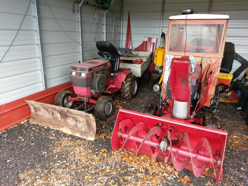

WVHillbilly520H 10,379 #10 Posted July 8, 2019 (edited) 5 hours ago, RunningMajorK said: Just picked this baby up today, did a little research. Thinking it's a 88' or 89'. Model# 3120oE01 has the P220 Onan engine. Can someone confirm and suggest a snow blade? Definitely '88-89... '90 or newer has the swept forward front axle... Just as Gary listed above but any plow frame from 1973 will work, a 42" will be minimally acceptable and work with yours but again like Gary said the 48" will be better get another tractor and have a plow and blower I also see you already have the rear axle hitch/bracket for a tiller and front or mid grader blades... @ebinmaine thanks for the shout out. Edited July 8, 2019 by WVHillbilly520H 1 Share this post Link to post Share on other sites
