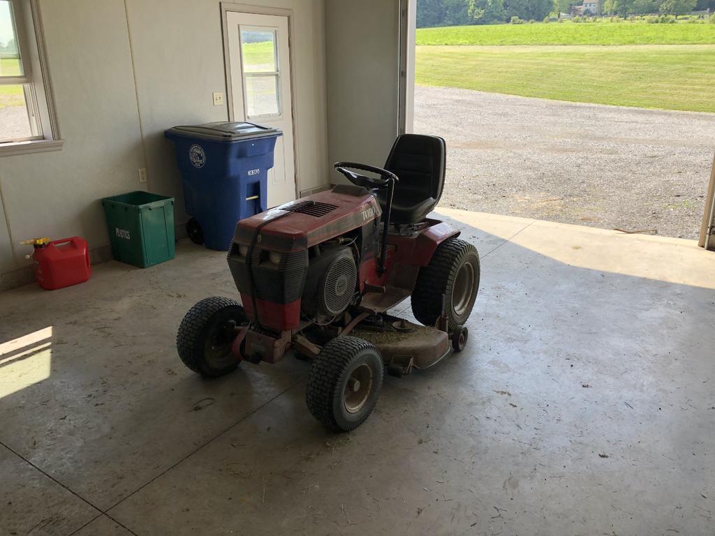

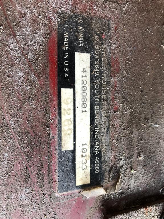

i just traded my way into a 520-8, and am looking for some info on its value. This is my first Wheelhorse- I had been looking for an older one in the style of a c161 hydro or d180 but ended up with this- has the 48” side discharge deck. I’m wondering if I’ve any chance of trading it for an older hydro with 48” mower and snowblower or if I should just bite the bullet and list it for sale... and for how much. Or if I could find a snowblower for this one. It runs and mows great, but is a little big for the 48” deck. Any info would be appreciated.

Welcome to REDSQUARE. I believe the 520-8 was only built 1 year 1990.This may be hear-say but I have heard 225 total built?. Usually 8 speeds use 90 Weight gear oil.

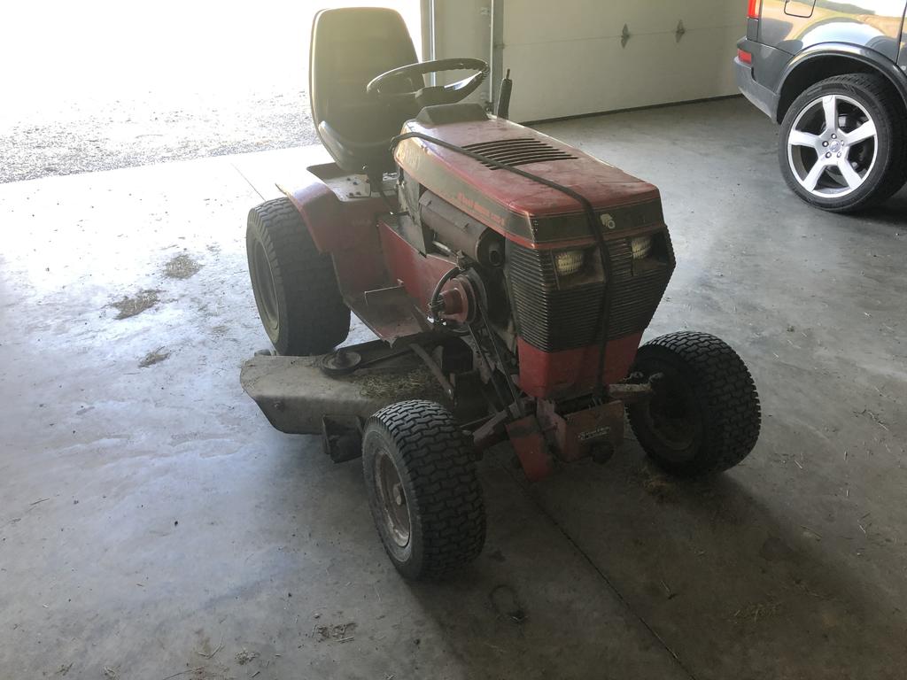

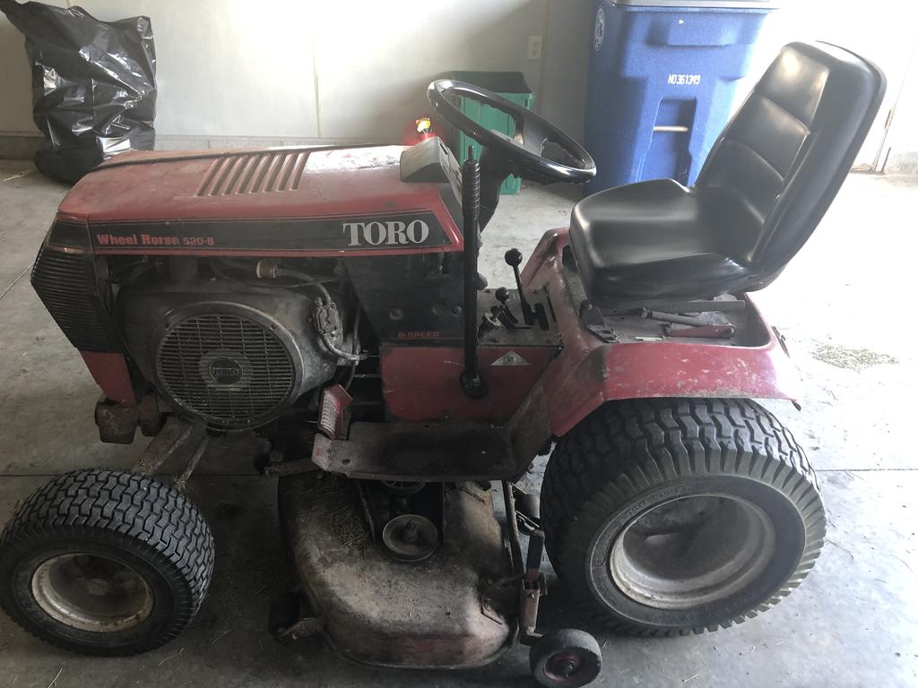

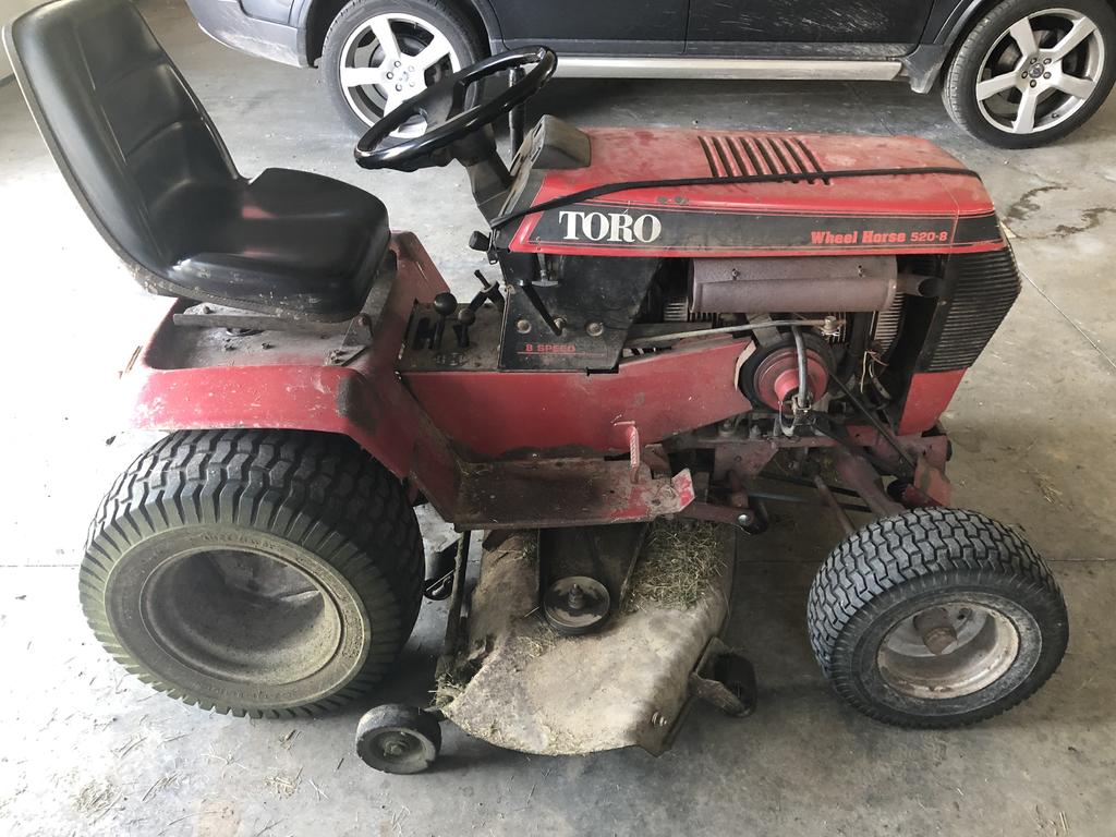

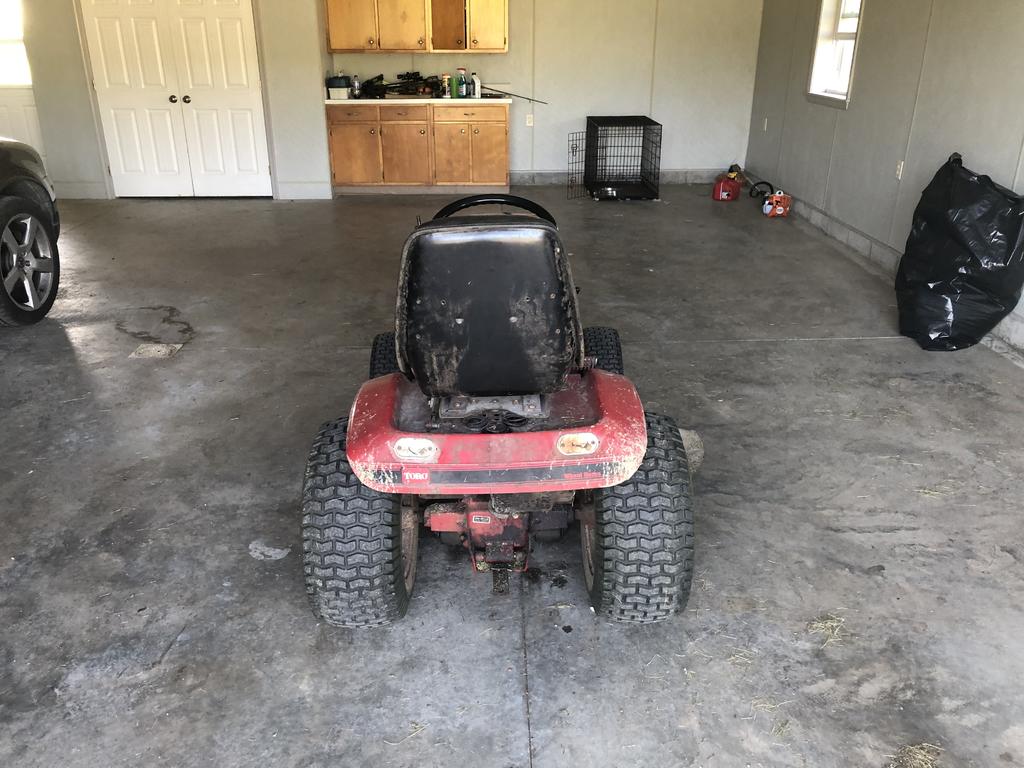

It’s got 1082.7 hours as of this morning. Here are some more photos of condition. I don’t think the deck will ever be pretty without paint. Lights don’t work, battery gauge doesn’t work, fuel gauge does work, steering is still pretty tight (a little slop in the wheel but steers well) no odd noises and has been kept greased and oil changed 2x a season by previous owner. He claims the engine was rebuilt a couple years ago at about 850 hours, but I’ve no proof of that. Sure is a strong, smooth runner. The throttle does drift down slower if not bungees up on the lever.

Now why didn't I think of that!  Instead of smashing a rivet or putting a small bolt thru the throttle, I could have used a mile long bungee cord.  :ychain:

It came to me like that! 😂

That tractor would clean up nice with a bath and some rubbing compound. Looks like a transmission seal on the right side is leaking. Be sure and clean behind the engine tins. That Onan rear cylinder Tin likes to get plugged with grass and overheat the cylinder.  Great tractor

Jeff, if you remove the throttle lever from under the dash (or you may be able to do it with it on), smash the rivet that the lever pivots on with a pair of pliers or something similar. That will restore the tension that it is supposed to place on it. If that doesn't work, drill out the rivet and replace it with a 1/4-20 bolt.

Or Plan C, put a tiny bolt thru the rivet and squeeze it that way.
That tractor appears to be abused almost as much as the 520HC & 520H tractors that I saw at an auction yesterday.  It simply amazes me how folks go out of their way to destroy their possessions.

I wouldn't say its been "destroyed".. All of the sheet metal is there and appears to be straight and the deck doesn't look like it's been too beat up.. Just looks like it spent part of its life outside.

No, it ain't as bad as the junk I saw yesterday, but I have three 520H tractors with many more hours and they appear much better.
