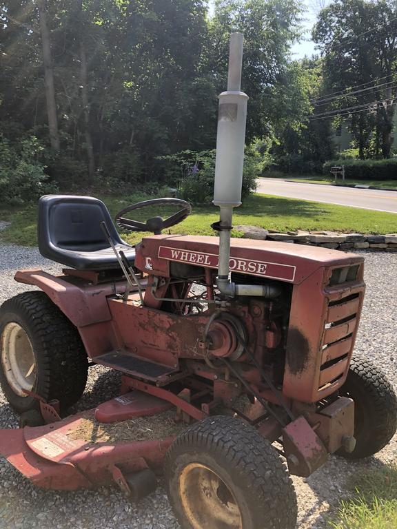

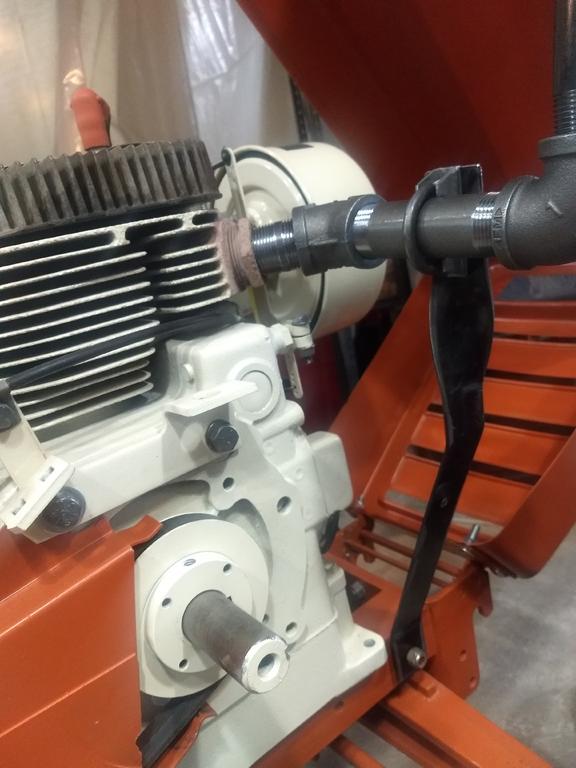

ebinmaine 79,010 #2 Posted July 1, 2019 All it is is black iron pipe. Not a bolt on kit so to speak, but very easy to put together. Not sure on the size but it's probably 1 inch or 1 - 1/4 inch. Here's a shot of the parts I used as they are all fastened together after I painted them. And here's a picture of it fabbed on to the tractor before I removed them for paint. If my memory serves me correctly it was a two inch double male, 45 degree elbow, 4 or 5 inch double male, 90-degree elbow going up ........ and then whatever you need to get into your own muffler. All of these parts are very readily available at any decent hardware store or big-box store. The one thing that most of us would recommend is a bracket to hold it in place to keep it from vibrating because the cast iron of the engine can be brittle. 2 1 Share this post Link to post Share on other sites

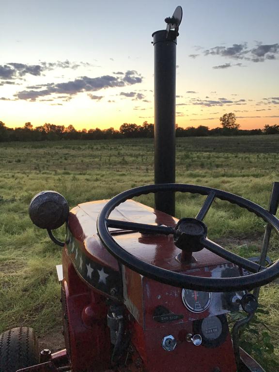

seven 202 #3 Posted July 2, 2019 Can you send s picture of the muffler Share this post Link to post Share on other sites
ebinmaine 79,010 #4 Posted July 2, 2019 2 minutes ago, seven said: Can you send s picture of the muffler Not sure if you want mine or Matt's but here's what's on the cinnamon horse And as installed 1 Share this post Link to post Share on other sites

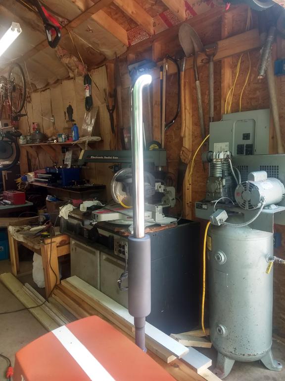

mattd860 162 #9 Posted July 4, 2019 Check it out!! Need to paint and add a support bracket 1 1 Share this post Link to post Share on other sites
ebinmaine 79,010 #10 Posted July 4, 2019 Looks great!! Share this post Link to post Share on other sites
