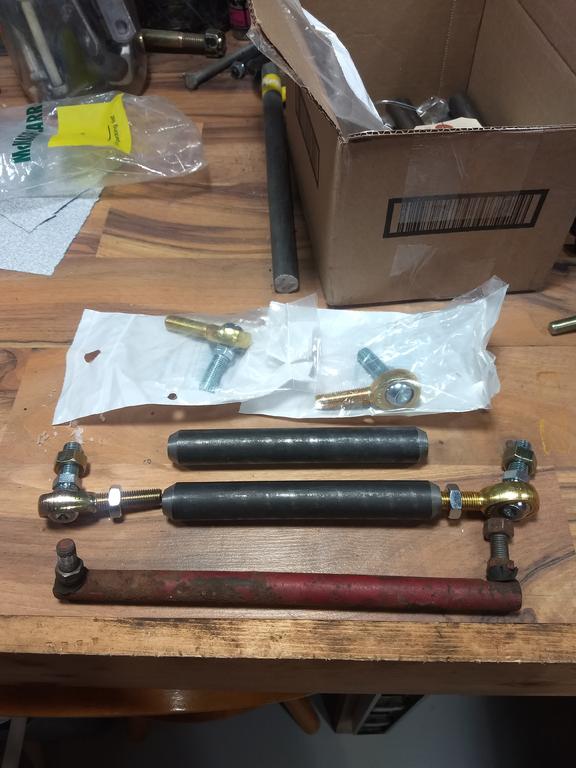

ebinmaine 77,569 #1 Posted June 29, 2019 @Mows4three @bellevillerod I'm finally getting around to putting the tie rods together for the cinnamon horse. The holes on the steering knuckles are wallowed out a bit like they are on many of our horses. I decided to go to the next size up tie rod which is 7/16. I also decided to change over to heim joints which should tighten things up. For comparison of size the stock tie rod in the picture has a .625 diameter and the new one will have an .875 diameter. Overkill? Maybe. Go big or go home. 10 3 Share this post Link to post Share on other sites

ebinmaine 77,569 #4 Posted June 30, 2019 13 minutes ago, RandyLittrell said: You fabing the tie rods, or bought them somewhere? Randy Bought, would be the closest description. Let's just say that a very nice person donated these to my cause. 3 1 Share this post Link to post Share on other sites
RandyLittrell 3,944 #5 Posted June 30, 2019 Just now, ebinmaine said: Bought, would be the closest description. Let's just say that a very nice person donated these to my cause. With the regular sized one's I believe there is some DOM tubing just the right size to tap. Wasn't sure if these weren't the same way. Randy Share this post Link to post Share on other sites
ebinmaine 77,569 #6 Posted June 30, 2019 9 minutes ago, RandyLittrell said: With the regular sized one's I believe there is some DOM tubing just the right size to tap. Wasn't sure if these weren't the same way. Randy No. These were actually solid rods to the best of my knowledge. Drilled and tapped. 1 Share this post Link to post Share on other sites

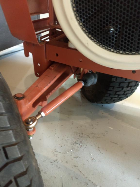

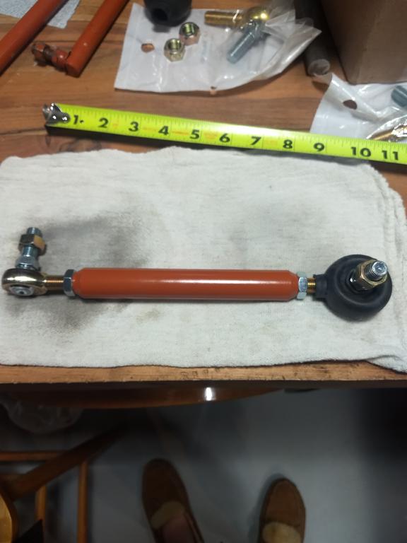

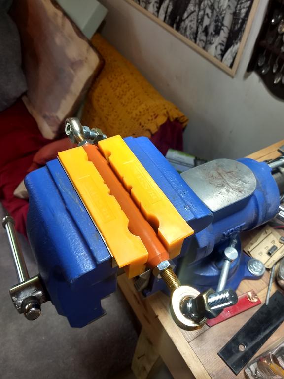

ebinmaine 77,569 #22 Posted June 30, 2019 Here's a few photos from this morning. Trina painted them last night and I assembled, and installed them today. You can see an inner boot cover. Those and the heim joints came from McMaster-Carr. 5 Share this post Link to post Share on other sites

Digger 66 3,525 #25 Posted June 30, 2019 Love those Soft Jaws ! Where'd 'ya get 'em ? 1 Share this post Link to post Share on other sites
