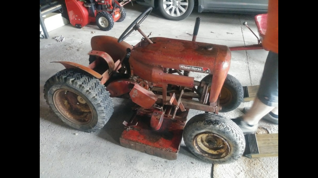

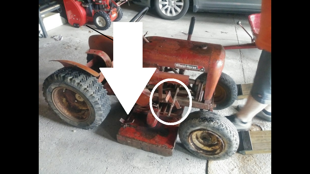

Solze1267 202 #1 Posted June 16, 2019 I recently acquired a rj58 with a mower deck. There is no id tag that I can find on the deck and I was curious if anyone knew a model number so I can get a reference manual for it. I also found it interesting that the spindle has the blade attached and the cutting edge bolts on to the end. Hopefully someone can shine some light on the deck for me. 1 Share this post Link to post Share on other sites
gwest_ca-(File Mod) 12,220 #2 Posted June 17, 2019 Click on the picture Garry 4 1 Share this post Link to post Share on other sites
Solze1267 202 #3 Posted June 17, 2019 @gwest_ca thank you that is exactly what I need👍🏻👍🏻 1 1 Share this post Link to post Share on other sites
oliver2-44 11,465 #4 Posted June 17, 2019 I'd say congratulations on the find, but it didn't happen if there's not any 1 Share this post Link to post Share on other sites
Solze1267 202 #5 Posted June 18, 2019 @oliver2-44 here it is fresh off the truck 2 Share this post Link to post Share on other sites

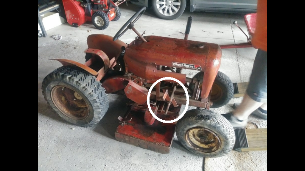

wallfish 19,914 #19 Posted October 14, 2019 If you're still in contact with the seller, this pedal indicates it once had snow/dozer blade attached. Maybe they have it? Share this post Link to post Share on other sites
Solze1267 202 #20 Posted October 14, 2019 He does but we declined it due to how rough of shape it was in... Share this post Link to post Share on other sites
wallfish 19,914 #21 Posted October 14, 2019 The pedal still being on the tractor without the rest of it is the same reason why people are always looking for pedals. It will fit the 1960-61 style blades and it's used to pull the lock pin for indexing the blade Share this post Link to post Share on other sites
Solze1267 202 #22 Posted October 14, 2019 Here I thought it had something to do with the mower deck. Thank you for clearing that up...but if you don't mind me asking and I feel kind of dumb for not knowing....how are the blades engaged on the rj's... Share this post Link to post Share on other sites
wallfish 19,914 #23 Posted October 14, 2019 There;s absolutely no dumb questions on here which makes it the best site on the web. None of us were born with this knowledge so sharing info is what it's all about 1 Share this post Link to post Share on other sites
