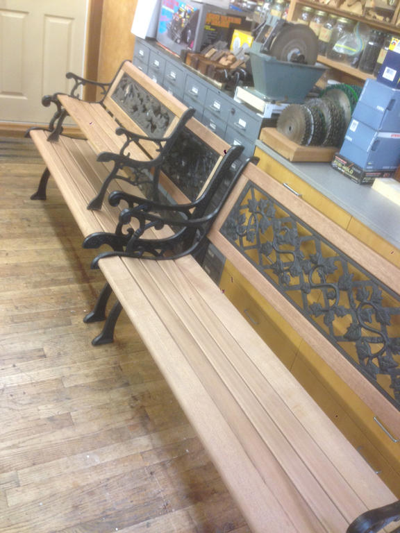

formariz 12,381 #16 Posted May 19, 2019 Thought you left it out on purpose.I found that some of these seats are a little too deep so ones inside of leg is always putting too much pressure on that board making it uncomfortable. I have resorted in the latest ones to shape that board so it is comfortable and does not dig in to leg. I also found that in many it is best that boards are not all same width, so now I just customize them according to bench so they have a smooth contour without edges protruding from adjacent board. Here is the latest batch. 2 Share this post Link to post Share on other sites
Stormin 9,988 #17 Posted May 19, 2019 (edited) We have one like those type of benches. Same pattern. That's due for a rebuild one day. I like the way you've done the seat. Edited May 19, 2019 by Stormin Share this post Link to post Share on other sites
