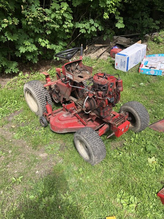

NikW 53 #57 Posted May 22, 2019 Update on the horse. Pulled the carb and sent it to my buddy for a cleaning and rebuild. Changed fuel pump. Removed the muffler and headpipe to put the correct setup on. Removed pulleys from mule drive to replace bearings. Removed rear tin and drive belt cover to remove drive belt. Removed gas tank to clean everything. Drained rear oil and engine oil. Pressure washed. I ordered an air filter and fuel filter. Fuel lines. All 3 belts. Clutch pulley. Bearings for mule drive pulleys. And a spark plug. Once all the parts get here she’s getting put back together. The manuals on the forums here really helped me out with finding all the correct part numbers. I’m enjoying this whole process a lot. Can’t wait to get it back together and feel a drive belt that doesn’t slip. 3 Share this post Link to post Share on other sites

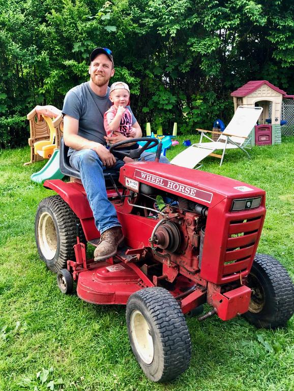

NikW 53 #59 Posted May 25, 2019 Well she’s all back together and we got a nice ride in last night! My son Lucas loved it! The new drive belt fit perfect and works perfect. Everything turnout great. We still need the pulleys for the mule drive and gotta trim the exhaust up and wire the headlights but she drives like a dream. I love how easy it steers and just works! This forum was a big help! 2 2 Share this post Link to post Share on other sites
