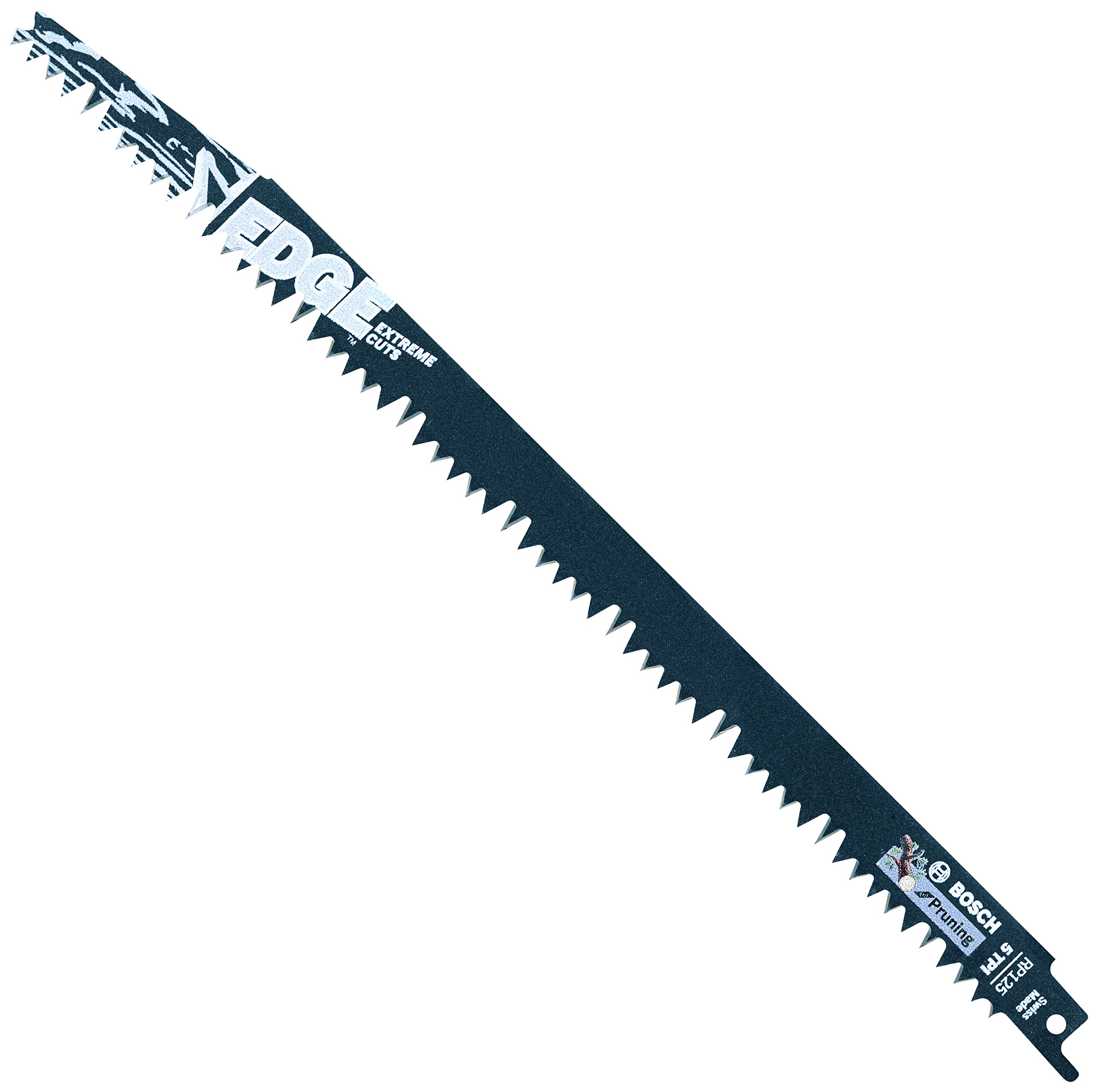

953 nut 69,555 #5 Posted April 18, 2019 This is what I use on roots. They hold up well and are long enough to get to the roots underneath. 13 1 1 Share this post Link to post Share on other sites
ebinmaine 80,766 #6 Posted April 18, 2019 5 minutes ago, 953 nut said: This is what I use on roots. They hold up well and are long enough to get to the roots underneath. Is that a Sawzall style blade? 3 Share this post Link to post Share on other sites
elcamino/wheelhorse 9,363 #7 Posted April 18, 2019 It sure is , they work well on roots . The real big stumps will be the problem getting them out of the ground. 2 1 Share this post Link to post Share on other sites
ebinmaine 80,766 #8 Posted April 18, 2019 4 minutes ago, elcamino/wheelhorse said: It sure is , they work well on roots . The real big stumps will be the problem getting them out of the ground. I don't actually have to get them completely out of the ground. Just low enough that I can layer stone over the top of them. 1 Share this post Link to post Share on other sites

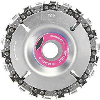

formariz 12,381 #9 Posted April 18, 2019 To grind down stump here is what I use. It is used for carving generally, but it works well for this. Comes in a couple different cuts (aggressive or fine). Clear dirt around stump to level wanted. Blow stump clean as much as you can with compressed air. Then grind down . I usually grind them from the top inside out leaving edges for last. This way I expose cutter to dirt only at the very end.Tool can be easily sharpened with small wheel in a drill. A word of caution. Get used to it slowly, make sure grinder has additional handle installed and guard. It is effective but can also be dangerous if you are reckless with it. 3 Share this post Link to post Share on other sites
SylvanLakeWH 32,608 #10 Posted April 18, 2019 1 hour ago, 953 nut said: This is what I use on roots. They hold up well and are long enough to get to the roots underneath. I use same thing... Chain saws are not designed for ground contact. High potential to do saw harm and not safe. These are cheap and much safer... 5 Share this post Link to post Share on other sites

953 nut 69,555 #12 Posted April 19, 2019 4 hours ago, formariz said: can also be dangerous if you are reckless with it. They can take off an arm! A 4" grinder hasn't got enough to hang onto and use one of these. 1 1 Share this post Link to post Share on other sites
clueless 3,439 #13 Posted April 19, 2019 16 hours ago, 953 nut said: This is what I use on roots. They hold up well and are long enough to get to the roots underneath. Put one on my battery powered Dewalt sawzall a few years ago for the wife to do some pruning, trimming, and root removal. Never got the saw back . 1 4 Share this post Link to post Share on other sites
ebinmaine 80,766 #14 Posted April 19, 2019 1 minute ago, clueless said: Put one on my battery powered Dewalt sawzall a few years ago for the wife to do some pruning, trimming, and root removal. Never got the saw back . You do realize that gives you full unequivocal permission to go get another battery powered Dewalt Sawzall of equal or greater value, right? 3 Share this post Link to post Share on other sites
clueless 3,439 #15 Posted April 19, 2019 1 minute ago, ebinmaine said: You do realize that gives you full unequivocal permission to go get another battery powered Dewalt Sawzall of equal or greater value, right? That happened with in the first couple of months . That blade and a battery powered sawzall is about the best thing there is for trimming and taking down shrubs and small trees. 3 1 Share this post Link to post Share on other sites
Lee1977 7,785 #16 Posted April 19, 2019 11 minutes ago, clueless said: That happened with in the first couple of months . That blade and a battery powered sawzall is about the best thing there is for trimming and taking down shrubs and small trees. I can see that would work very well. The best thing for cutting down overgrown shrubbery is a pole saw. Then use a sawzall or chain saw if you are taking it to the ground. 1 Share this post Link to post Share on other sites
Sarge 3,473 #17 Posted April 19, 2019 Those pruning blades are the same thing I use to remove stumps and roots around here - much cheaper, safer and effective than any chain saw. I'd recommend using a really cheap grinder if you go with the chained saw blade made for wood - the shock load they can put back into the tool is staggering and will destroy an expensive grinder in short order. Hunt around - I believe someone is now making those pruning blades for sawzall-type machines in Bi-Metal blade form, which can take 4 times as much heat and abuse. Those types of blade material can also handle hitting dirt, rocks and other debris quite well with little damage to their teeth. A lot of times I've just used the bi-metal type super-aggressive demolition blades made for cutting through wood and steel for these jobs that include dirt and debris. The pruning blades are faster, but their teeth are also a lot more delicate and prone to dulling when they hit anything but soft woods. Sarge 3 1 Share this post Link to post Share on other sites
Mows4three 833 #18 Posted April 19, 2019 Eric, My humble suggestion... Go to Harbor Fright. Buy their cheapest sawzall (baterry operated is handier) and don't forget to take a 20% off or a sale coupon. Buy some of their extra blades for rough cutting wood. Saw the roots off with the sawzall and save your back. Much less digging is required. Once I found this method of stump removal I've never gone back to an axe. I don't have a backhoe or a skid steer so I had to get smarter or I would be forced to work harder. Cheers! Dave 1 1 Share this post Link to post Share on other sites
ebinmaine 80,766 #19 Posted April 19, 2019 folks, I'm liking the Sawzall idea. That's the way we're going to go. I have two that are corded and that's okay because it's close enough to the house that I can plug in. I do actually have one of those 5 TPI demolition blades with the reinforced teeth as mentioned I believe above by @Sarge. I don't know if the weather is going to hold off enough in the next couple days but we're going to try to get out there and clear some more land. 3 Share this post Link to post Share on other sites
