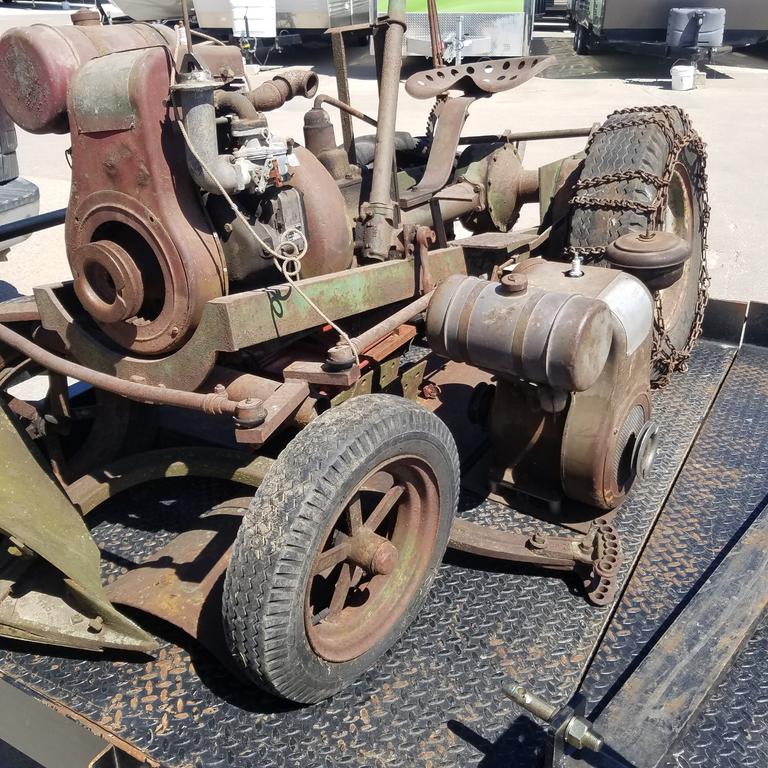

Kungfil 49 #1 Posted April 15, 2019 55 Senior made the trip from Indiana to Nebraska. Please add to registry (if not already there). Nebraska claims 1 Senior. What did I get myself into? 3 10 1 Share this post Link to post Share on other sites

peter lena 10,103 #3 Posted April 15, 2019 definetly worth saving , from the mechanical , straight line drive set up , to the ford type rear end. hope is does not go to the scrapper , pete 2 Share this post Link to post Share on other sites

stevebo-(Moderator) 8,742 #15 Posted April 16, 2019 It is pretty simple. I have two and the carbs are very difficult to clean and rebuild to get them to idle correctly. I would look on line for an nos zenith carb for it. I did that for both of mine and they both run perfect now. You will want to clean up points and make sure she has good spark. You may just want to replace ignition as well. Once you have them tuned right they pretty much start on first or second pull every time. 5 Share this post Link to post Share on other sites
