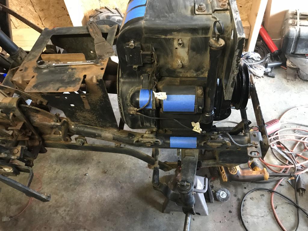

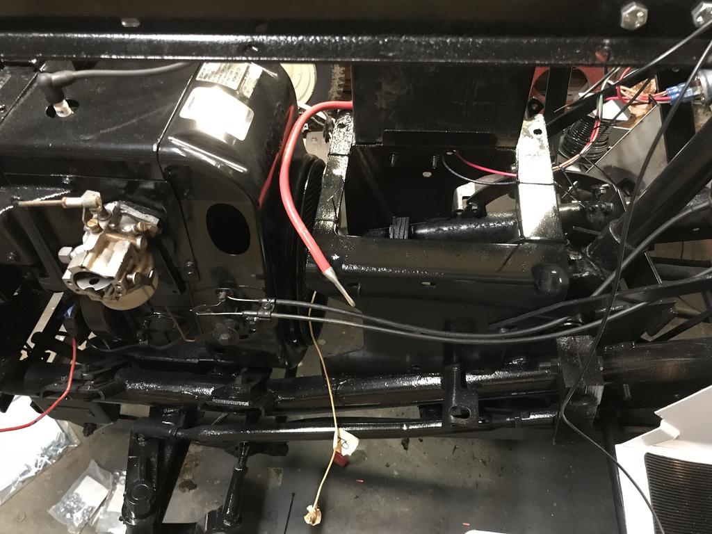

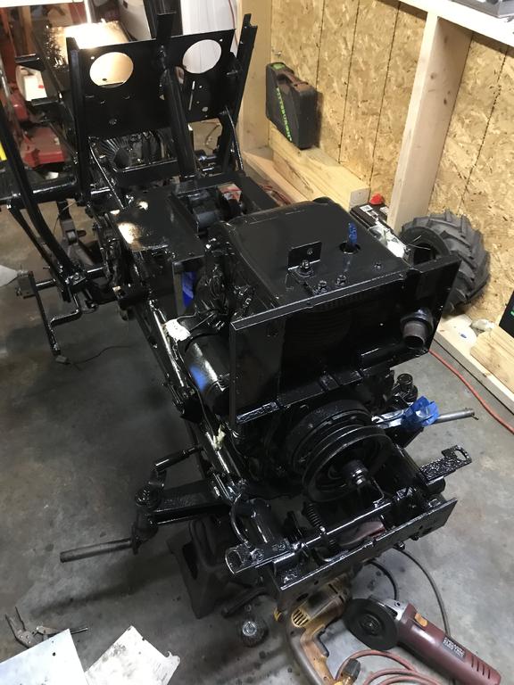

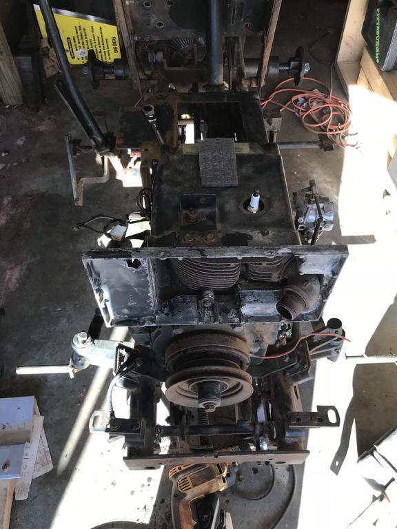

dells68 7,499 #12 Posted April 7, 2019 Finished cleaning the he frame, engine, and trans today. Put a good coat of black before I quit to burn brush. 6 1 Share this post Link to post Share on other sites

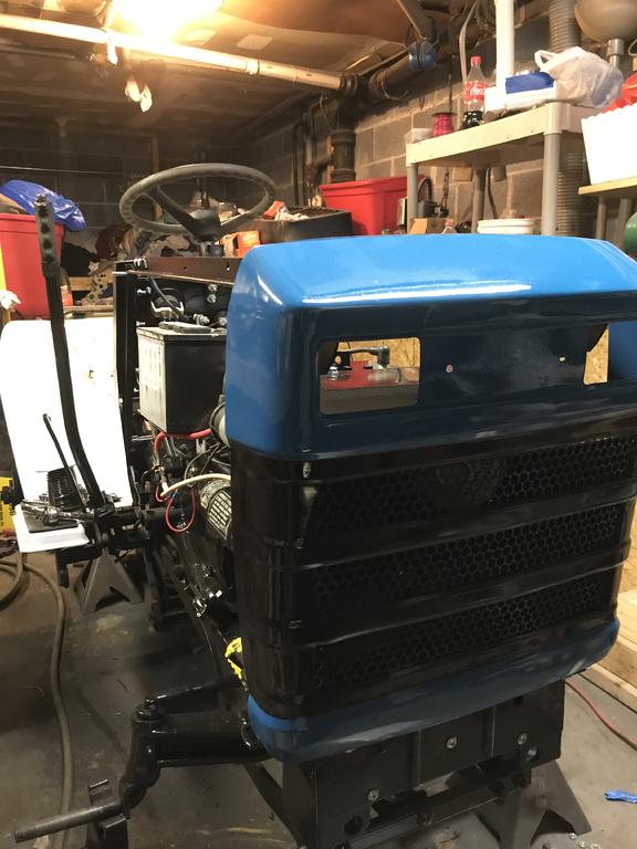

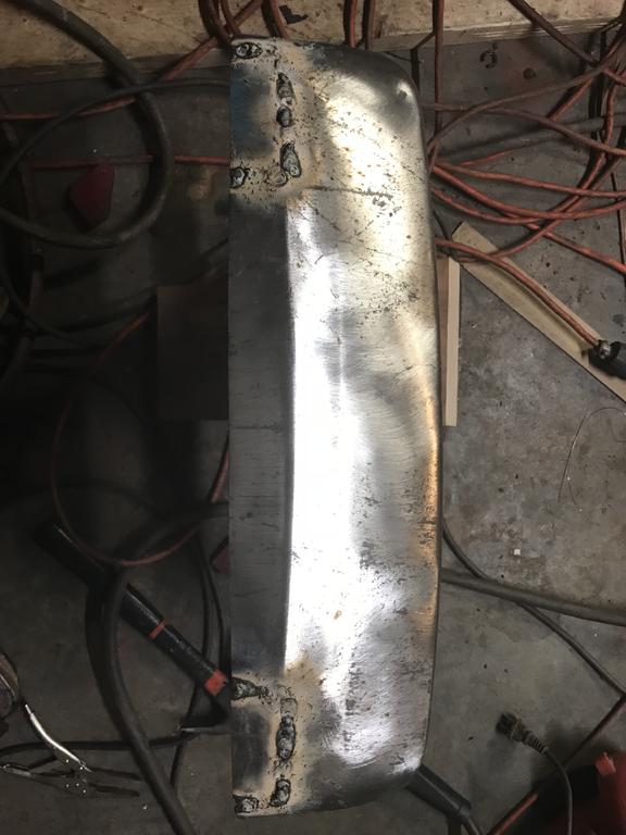

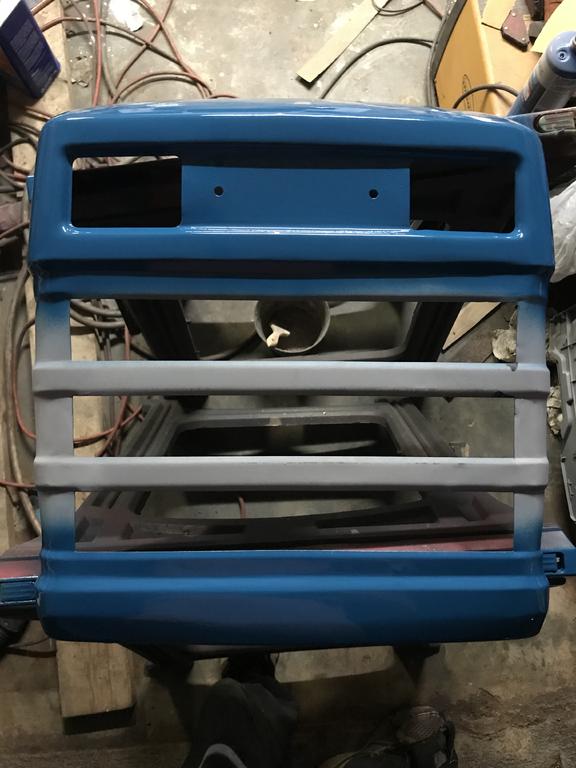

dells68 7,499 #13 Posted April 10, 2019 (edited) It much progress lately. I’ve been busy trying to keep up with things at school and outside now that Spring is here. I did get a chance to work on the grille tonight. The original was pretty rusted all over - through in some places. I have the grille from the parts 165, but somebody broke the top brace mount brackets clear off. So, I decided to cut the old brackets from the original and weld them on the solid one. I did have to pound out a few dents and put a skim of body filler on them. Probably won’t get another chance to work until this weekend. Oh well, a little progress is better than no progress! Please ignore my ugly welds. I’m using a flux core and it doesn’t seemlike it’s getting hot enough to do a nice job lately. Might be time for a new one. Edited April 10, 2019 by dells68 3 Share this post Link to post Share on other sites
ebinmaine 80,477 #14 Posted April 10, 2019 5 hours ago, dells68 said: Might be time for a new one Oh no... Not a new tool... Oh what ever shall you do... 1 Share this post Link to post Share on other sites
WVHillbilly520H 10,379 #15 Posted April 10, 2019 5 hours ago, dells68 said: It much progress lately. I’ve been busy trying to keep up with things at school and outside now that Spring is here. I did get a chance to work on the grille tonight. The original was pretty rusted all over - through in some places. I have the grille from the parts 165, but somebody broke the top brace mount brackets clear off. So, I decided to cut the old brackets from the original and weld them on the solid one. I did have to pound out a few dents and put a skim of body filler on them. Probably won’t get another chance to work until this weekend. Oh well, a little progress is better than no progress! Please ignore my ugly welds. I’m using a flux core and it doesn’t seemlike it’s getting hot enough to do a nice job lately. Might be time for a new one. i know what you mean I have the old Sears fluxcore that dad bought new in the late 90s just doesn't have the zip as those 480 volt units at work...but I'm kinda digging this one from HF...https://www.harborfreight.com/unlimited-200-professional-multiprocess-welder-with-120240-volt-input-64806.html... Should cover everything but the blue wrench...btw my best friend back home had/has one of those Ford LGTs made by Jacobson so parts can be found in an orange shade of red. 1 1 Share this post Link to post Share on other sites
dells68 7,499 #16 Posted April 10, 2019 Jacobsen made Ford’s mowers for them. They were a very well built machine. Sadly, Ford’s pricing made it quite difficult for dealers to move them, most often selling them at near cost. Ford didn’t understand why dealers didn’t want to push these machines. Yes, they would far outlast big box machines, but people wanted cheap, not quality in lawn and garden tractors. Share this post Link to post Share on other sites
Pullstart 71,172 #17 Posted April 10, 2019 That grill looks like it is Bumble Bee’s friend... 2 Share this post Link to post Share on other sites
Sarge 3,473 #18 Posted April 10, 2019 For some of that sheet metal work - I actually prefer to use 1/16" stick electrodes in the 7014 flavors. The bead goes down extremely fast with little damaging heat input as long as you keep them short and quick. They have a tough learning curve but work great compared to trying to use a flux core Mig. For better control - I cut the rods in half and clean the needed ends properly, then, have at it in short bursts. I have welded entire sheet metal storage boxes clear down to 20ga. out of flat sheet stock with those rods, no warpage at all. Sarge 1 Share this post Link to post Share on other sites

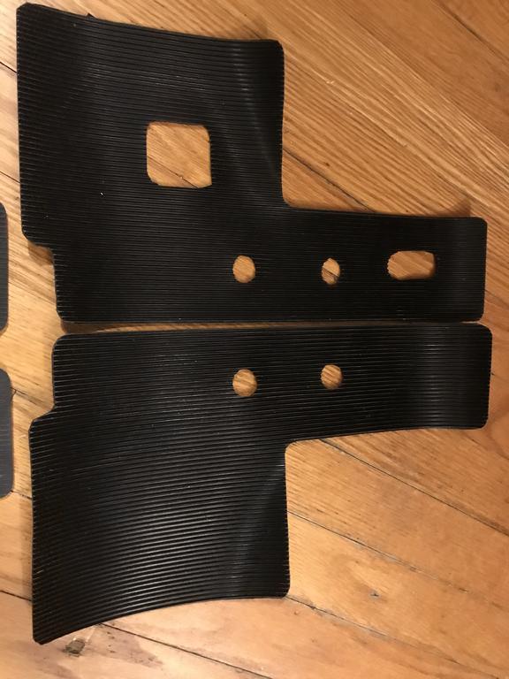

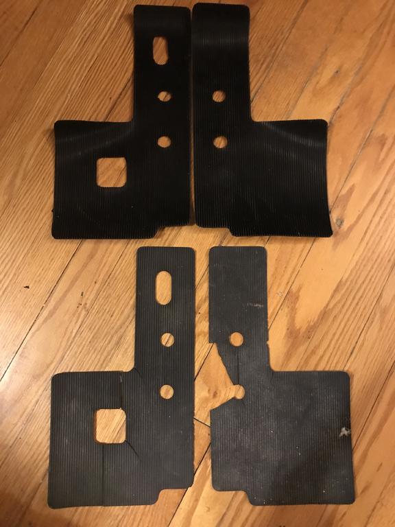

dells68 7,499 #19 Posted April 14, 2019 I spent the better part of today working up the garden at Dad’s and planting potatoes with him. When I got home, I used a paint removal wheel and cleaned up the donor seat pan and gave it a coat of etching primer. Sorry, no pics. I also cut two replacement foot rest pads from some rubber matting I had ordered, since there are no replacements available. This week I managed to source new taillights, headlights, ignition switch, and ribbed tires and tubes for the front. I hope to paint the fender pan this week so I can begin reassembly. Hopefully more progress this week. 8 Share this post Link to post Share on other sites

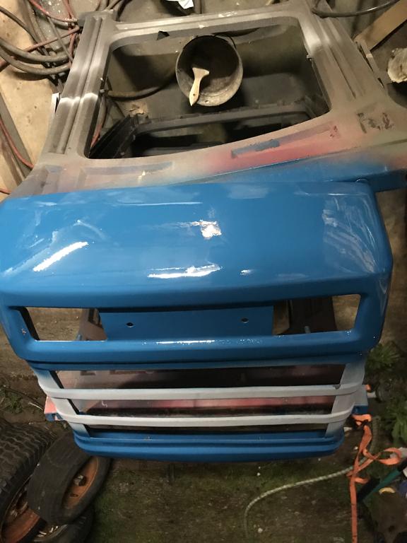

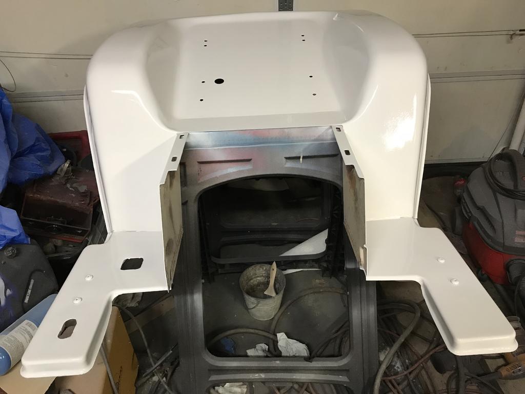

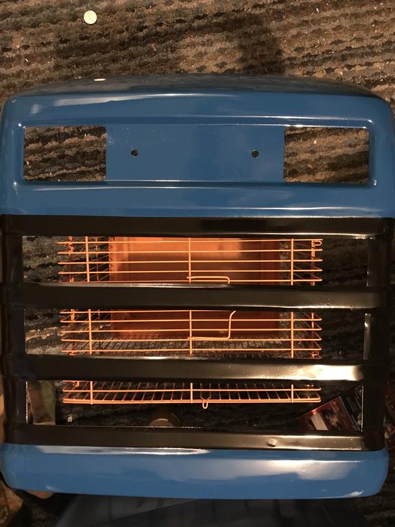

dells68 7,499 #20 Posted April 17, 2019 Inching my way there but by bit. Grille now has some Ford blue on it and the fender pan is painted. 8 3 1 Share this post Link to post Share on other sites

dells68 7,499 #24 Posted April 21, 2019 Little more progress over the past couple of days. 1 4 1 Share this post Link to post Share on other sites

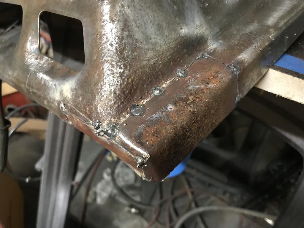

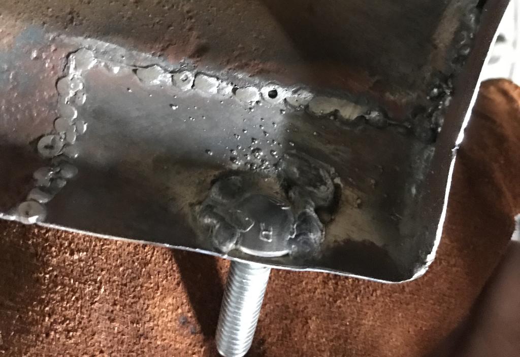

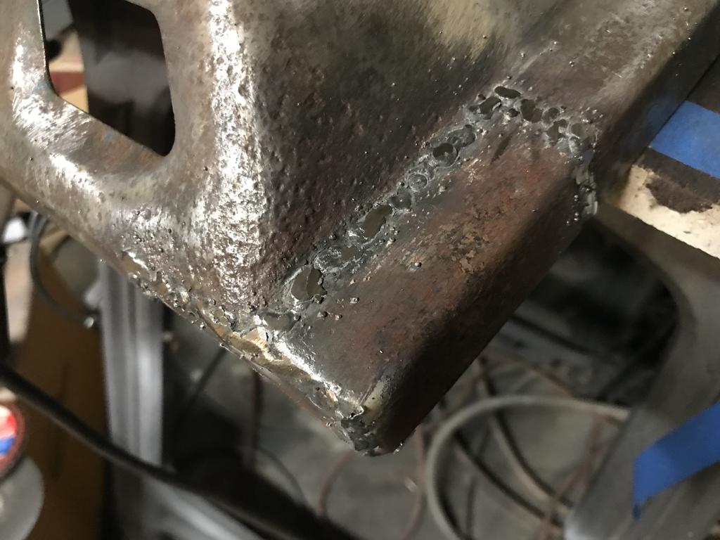

dells68 7,499 #25 Posted April 24, 2019 The bottom front left hand corner of the hood side was almost rotted away from standing water. I had to cut the rot out and make a new corner and weld in a new bolt that serves as an adjustable locator pin. Don’t judge the welds, I’m still using my worn out flux core, but did get good penetration. Should be good for another 40 years or so😁. 5 1 Share this post Link to post Share on other sites
