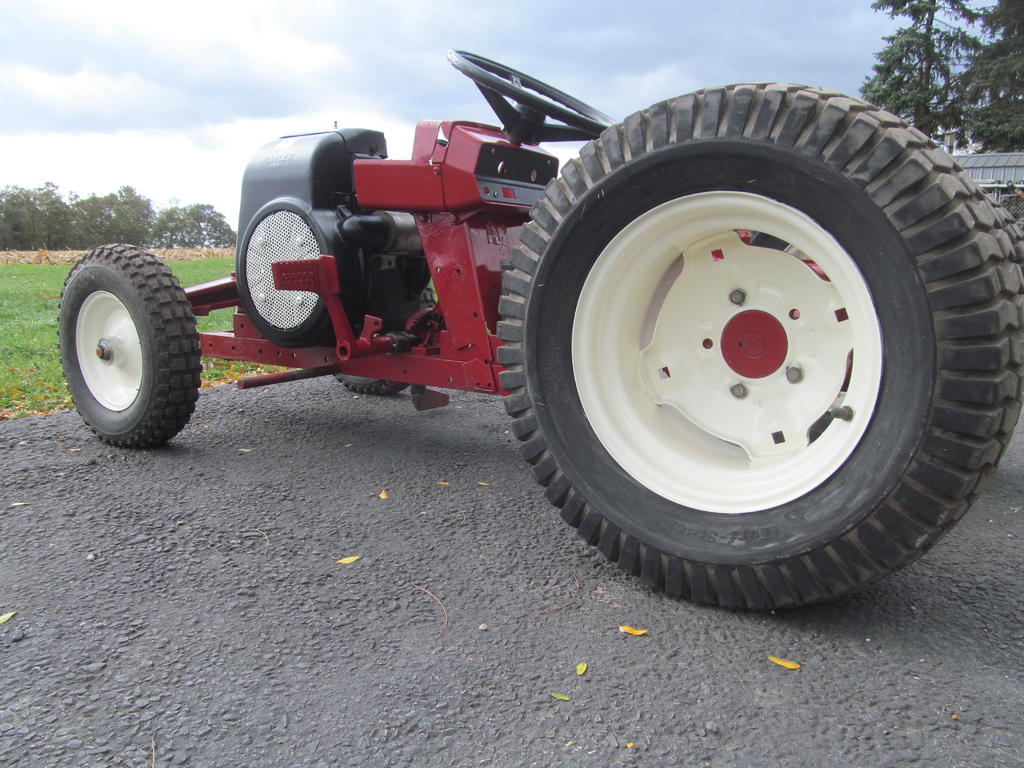

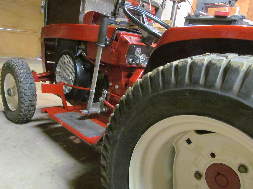

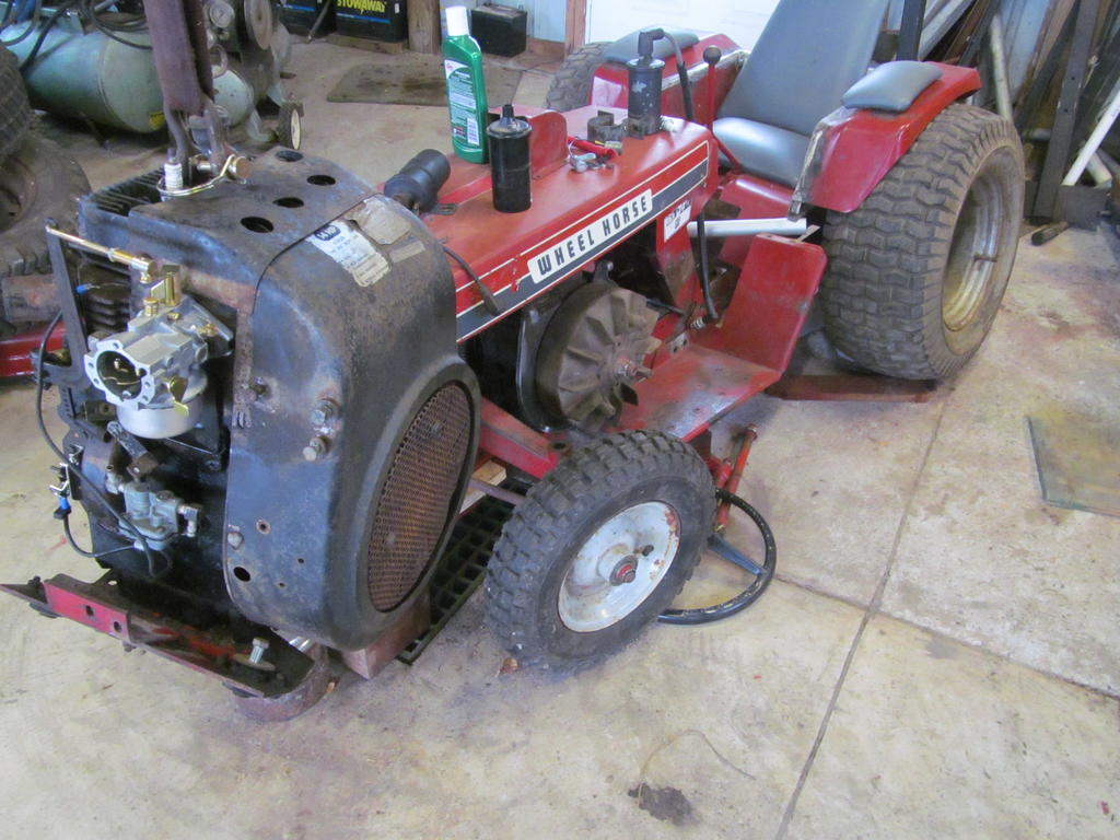

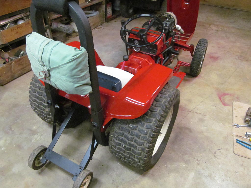

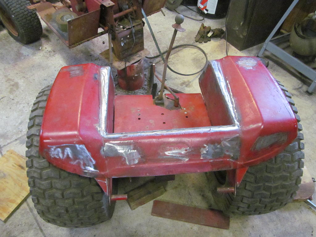

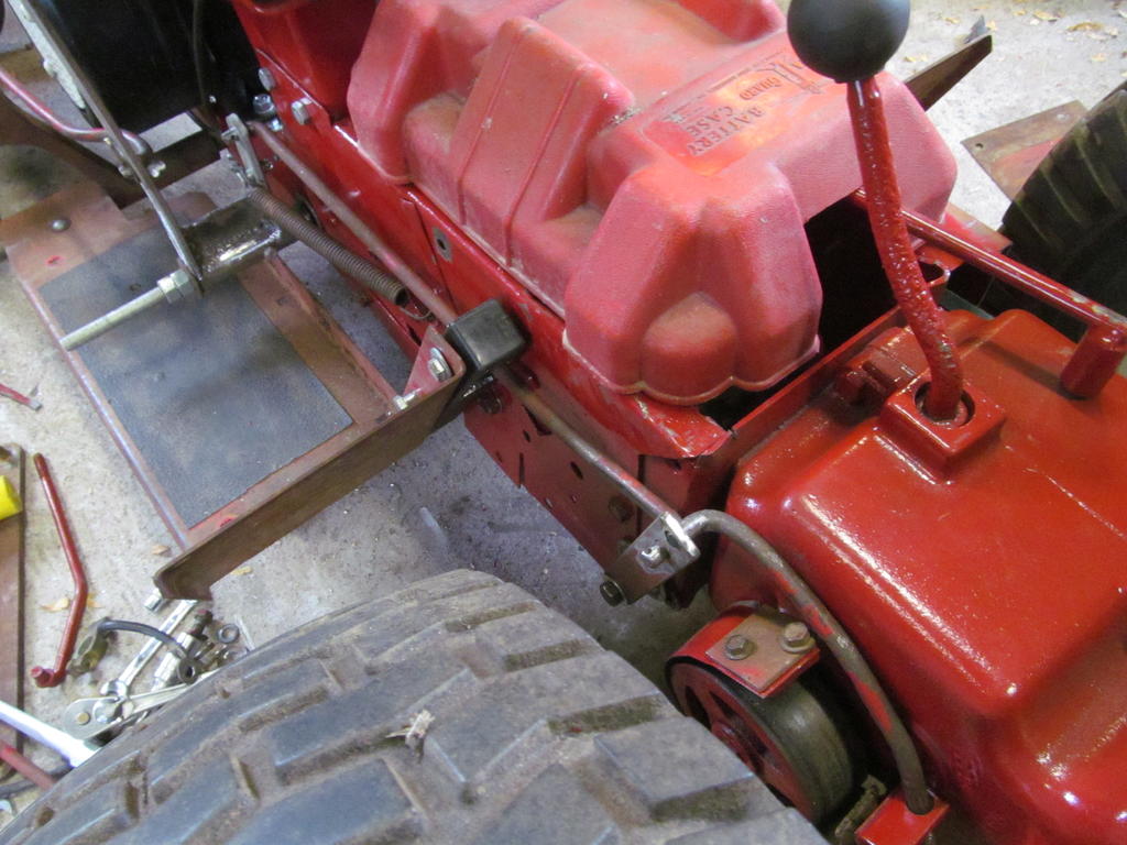

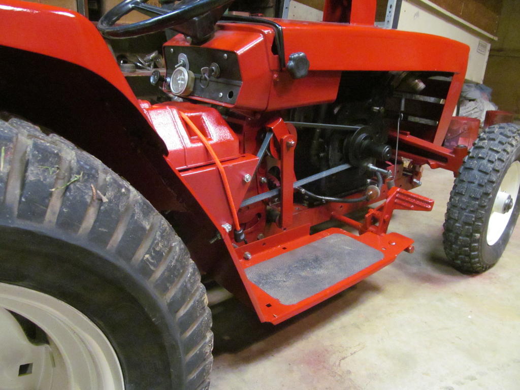

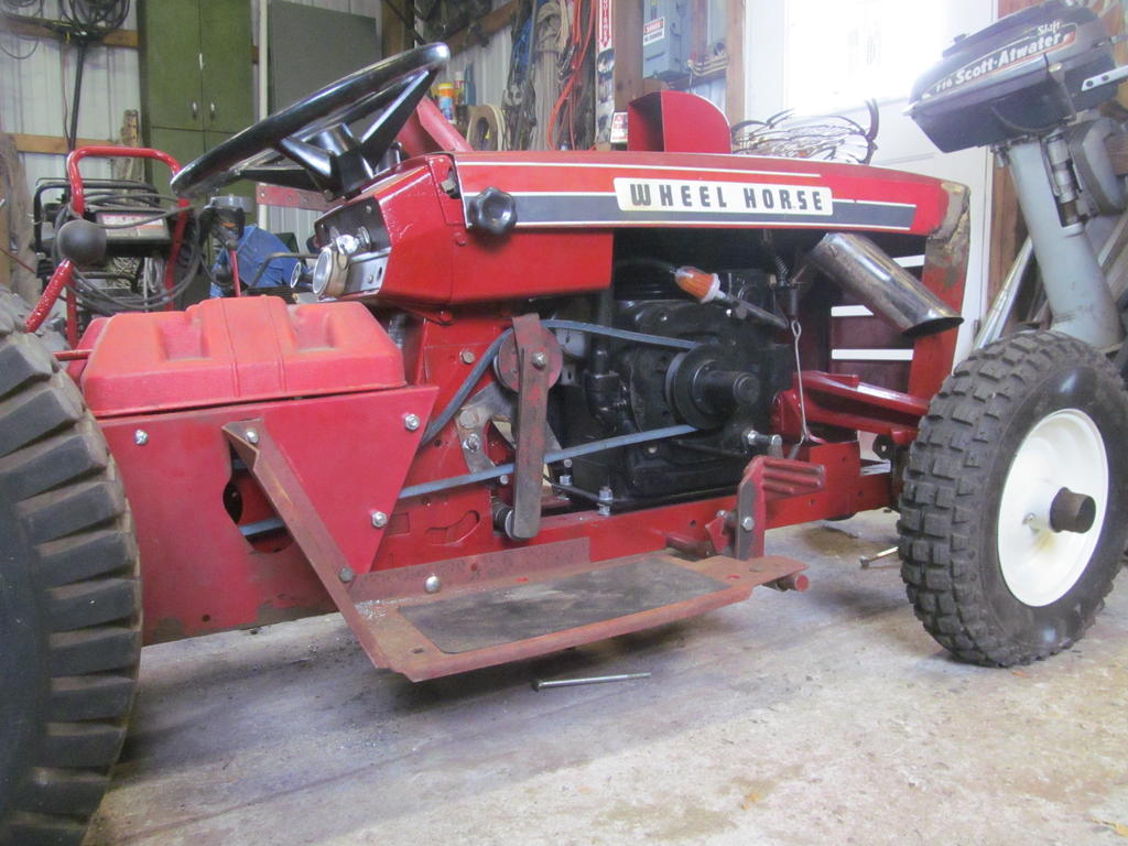

Ed Kennell 47,958 #30 Posted July 2, 2019 15 hours ago, 953 nut said: When @Ed Kennell built his low-rider he did a lot of engineering to drive the transmission and keep the belt out of harms-way. Perhaps he will share that post. I located a clutch cross shaft with foot and hand control right behind the engine and added a second idler pulley behind the clutch/tensioner pulley to direct the belt below the tunnel. Also added support pins to keep the lower belt from sacking and grabbing the engine pulley during transmission shifting. You can see the support pins on either side of the tensioner pulley lever. 4 3 2 Share this post Link to post Share on other sites
Tractorhead 9,218 #31 Posted July 2, 2019 Cool build Ed, 👍 How you mow with that? Just with speed or by Wheelie. i like it 👌 5 Share this post Link to post Share on other sites
Westie 8 #32 Posted July 7, 2019 Any more pics of that, i like it alot! Share this post Link to post Share on other sites

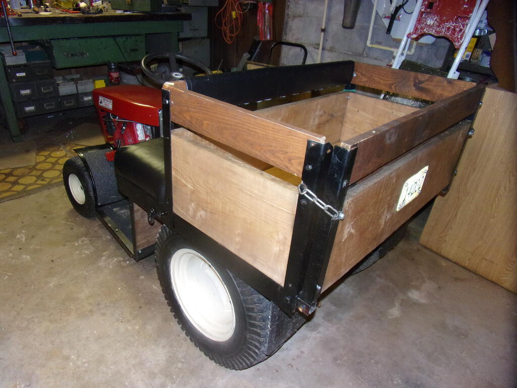

Ed Kennell 47,958 #33 Posted July 7, 2019 1 hour ago, Westie said: Any more pics of that, i like it alot! 2 5 1 Share this post Link to post Share on other sites

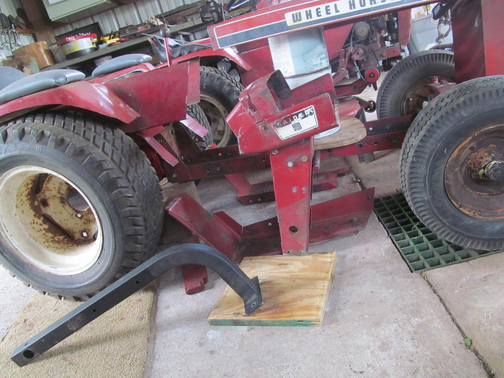

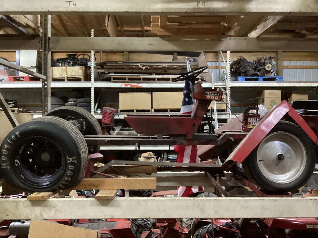

Pullstart 71,566 #36 Posted November 2, 2023 Lookey lookey at what I found! This is two Horse frames mated together, then Z notched up front for a level frame. The plan was to add a whole angle iron subframe. After the build got this far, I obtained a good handful of GT14 frames, much thicker in every dimension, and then it got ticked away for a thinking moment (ahem decade). 1 6 Share this post Link to post Share on other sites
ebinmaine 81,287 #37 Posted November 2, 2023 22 minutes ago, Pullstart said: ahem decade No worries brother man. I'm a few years in on mine too. 1 3 Share this post Link to post Share on other sites
SylvanLakeWH 32,921 #38 Posted November 2, 2023 30 minutes ago, Pullstart said: got ticked away for a thinking moment (ahem decade). 7 minutes ago, ebinmaine said: No worries brother man. I'm a few years in on mine too. So... What you're saying is, basically, now we gots two Colossuses... 5 Share this post Link to post Share on other sites

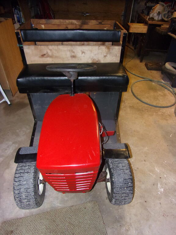

Ed Kennell 47,958 #46 Posted November 2, 2023 On 4/3/2019 at 1:36 PM, tarcoleo said: I just wonder if anyone has ever taken a Wheel Horse drive train (transmission and axles) and used it to fab a two seat novelty sport "roadster"? (parade car) My two seater. 3 Share this post Link to post Share on other sites
MarshDuck 74 #47 Posted November 2, 2023 21 minutes ago, Ed Kennell said: My two seater. That's one nice horse Share this post Link to post Share on other sites
