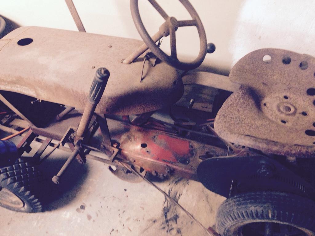

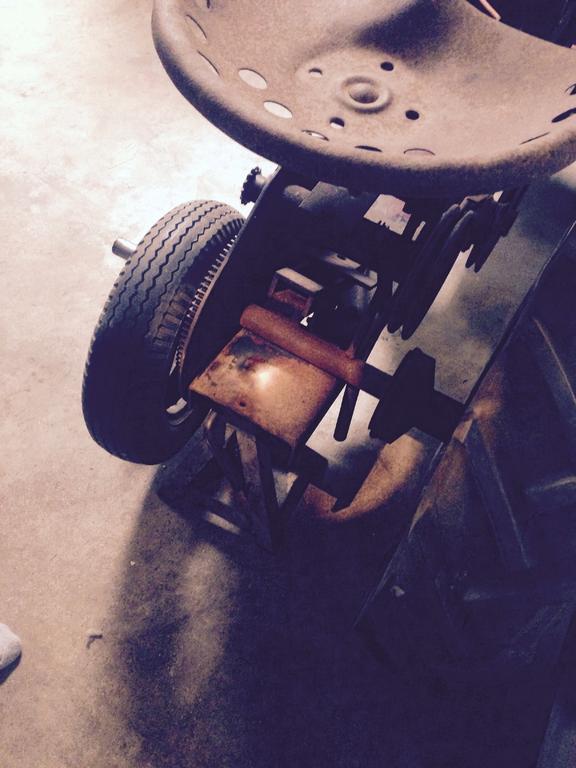

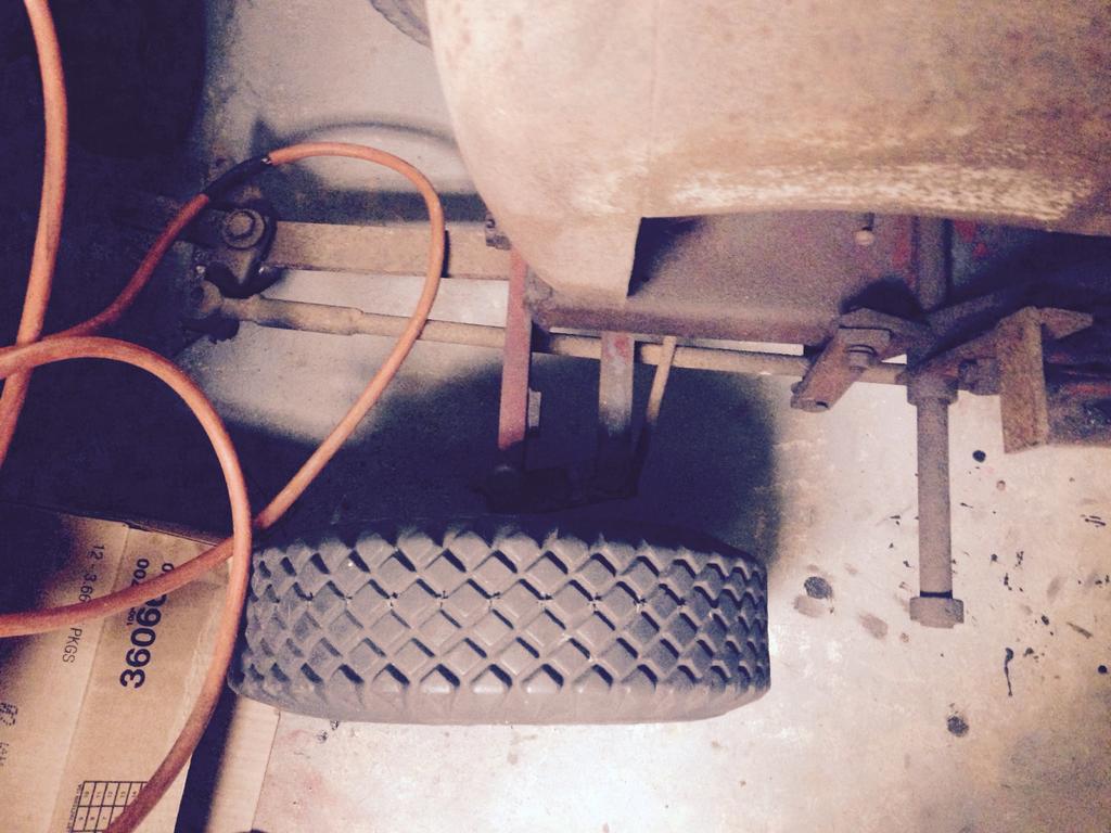

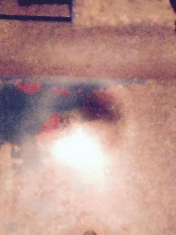

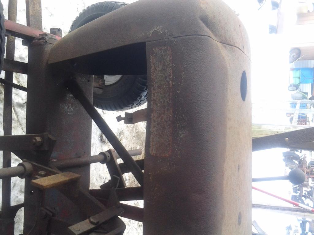

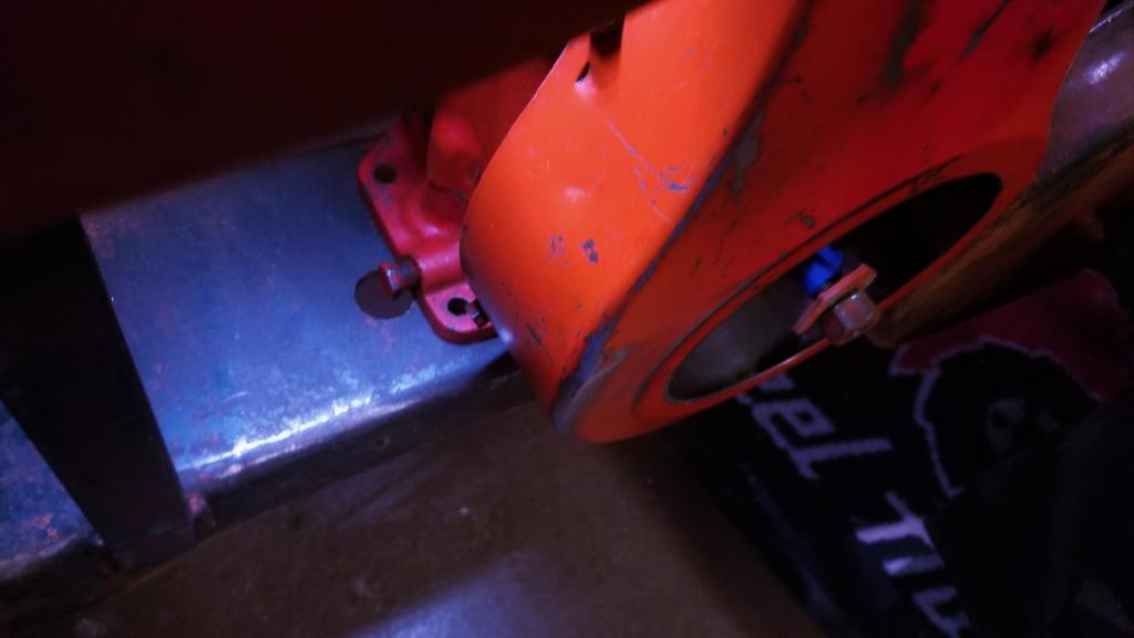

coreyb 13 #1 Posted March 17, 2019 (edited) any idea why i have blue on parts of my frame steering and by rear lift hitch it has a k90 and pond on cover cast steering wheel its as it was when new Edited March 17, 2019 by coreyb Share this post Link to post Share on other sites

coreyb 13 #4 Posted March 17, 2019 Bought from original owner. Parked in barn between 66 & 68. Pulled out of barn in about '08 3 1 Share this post Link to post Share on other sites

Lane Ranger 12,160 #8 Posted March 17, 2019 Not sure about blue paint spots. Replacement Kohler motors did come new with a blue paint on the tins. Kind of a Chrysler Blue color. Post some more pictures of your RJ 35 find CoryB! We all love to see wonderful originals found in someones place of revered storage! 2 Share this post Link to post Share on other sites

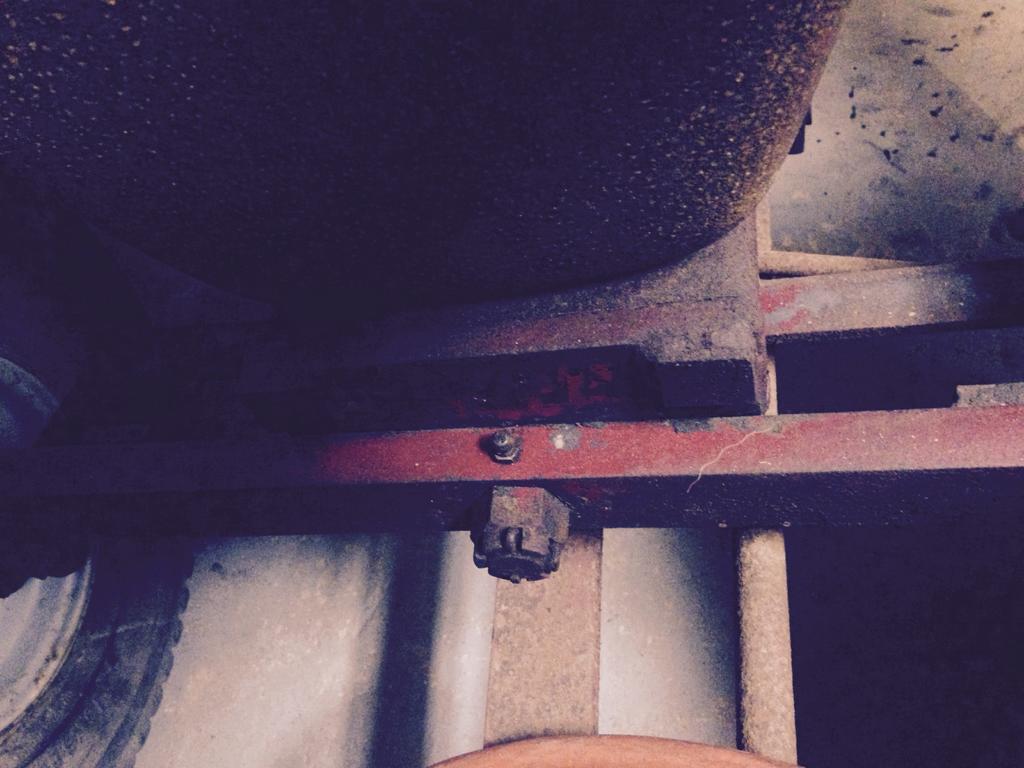

buckrancher 2,697 #10 Posted March 19, 2019 the oil drain hole in the frame is drilled for a Clinton a kohler would be in the center of the engine bolt down pattern brian 1 Share this post Link to post Share on other sites
buckrancher 2,697 #12 Posted March 19, 2019 the blueish color is just the normal off color of the raw hot roll steel they used to build the tractor brian 4 Share this post Link to post Share on other sites
coreyb 13 #13 Posted April 10, 2019 On 3/19/2019 at 9:18 AM, buckrancher said: the oil drain hole in the frame is drilled for a Clinton a kohler would be in the center of the engine bolt down pattern brian the drain hole is in the center of the frame Share this post Link to post Share on other sites
buckrancher 2,697 #14 Posted April 10, 2019 9 hours ago, coreyb said: the drain hole is in the center of the frame third picture down you can clearly see the oil drain hole is offset to one side of the motor bolt down pattern meaning the original motor was a Clinton 1 Share this post Link to post Share on other sites
coreyb 13 #15 Posted April 11, 2019 I DID SEE THAT AS WELL SO I CALLED WHO I GET IT FROM HE GOT IT NEW HE SAID THAT THE K 90 ON IT IS THE ORIG MOTOR IT GOT PARKED IN HIS BARN AROUND 1963 OR SO HE SAID THAT IT HAD NEVER BEEN APART UNTILL THIS WINTER WHEN I STARTED PLAYING WITH IT 1 Share this post Link to post Share on other sites

stevebo-(Moderator) 8,742 #17 Posted May 8, 2019 On 4/11/2019 at 10:17 AM, coreyb said: I DID SEE THAT AS WELL SO I CALLED WHO I GET IT FROM HE GOT IT NEW HE SAID THAT THE K 90 ON IT IS THE ORIG MOTOR IT GOT PARKED IN HIS BARN AROUND 1963 OR SO HE SAID THAT IT HAD NEVER BEEN APART UNTILL THIS WINTER WHEN I STARTED PLAYING WITH IT It goes to show if the K90 was the original motor that must have been a mistake that the hole was drilled for a Clinton. Must have been drilled on a Monday morning and the motor installed on a Friday afternoon 1 1 Share this post Link to post Share on other sites
