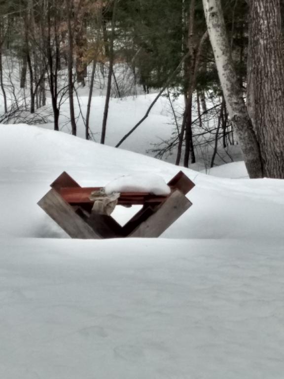

ebinmaine 80,435 #4 Posted March 15, 2019 I can't get a picture of it right now cuz it's buried in snow. We have a double ended sawhorse so to speak. Each end is an X They are held about 30 inch apart by cross boards. Put the log in the X and it keeps it well off the ground and away from nasty things that chains don't want to get into. Share this post Link to post Share on other sites

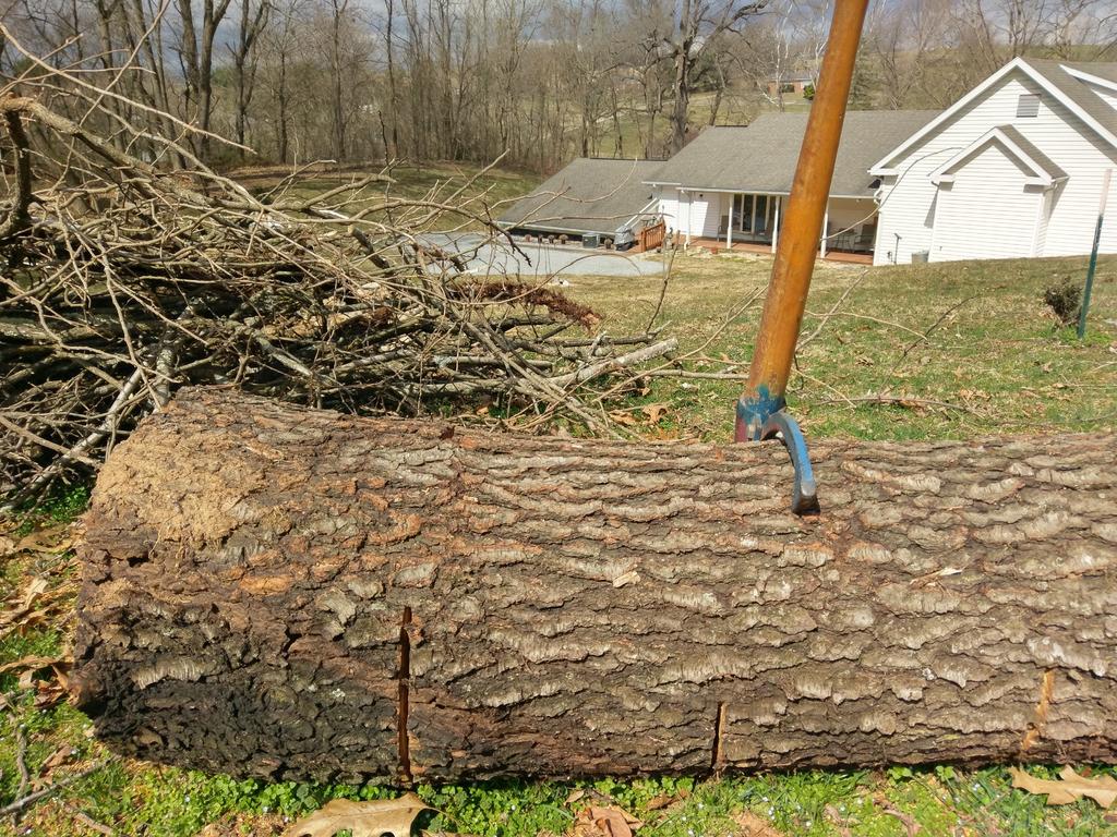

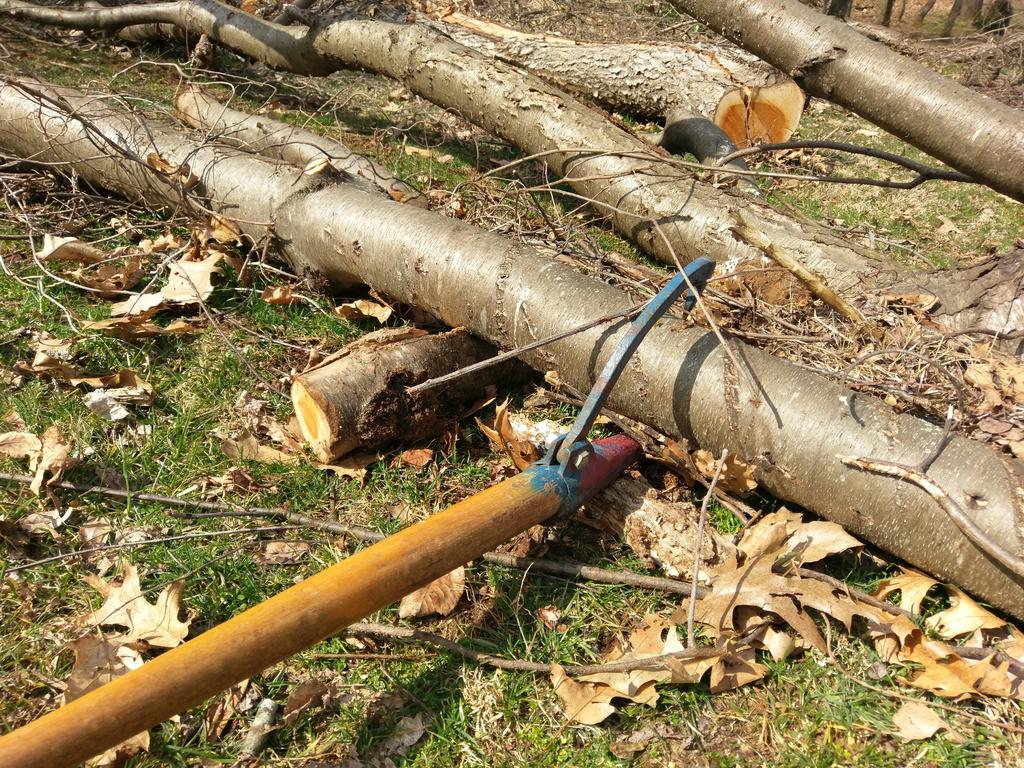

WVHillbilly520H 10,379 #7 Posted March 15, 2019 7 minutes ago, pfrederi said: I was trying to get them up some so I didn't cut into the ground which here is mostly rocks.... 7 minutes ago, ebinmaine said: Put the log in the X and it keeps it well off the ground and away from nasty things that chains don't want to get into. Every 4-6' I just put a sawn block of wood under the "log" (or roll said log onto sawn block) this will keep it up out of the dirt/rocks and you don't have to lift it very high to boot the use of a "cant hook" comes in handy as well especially with the bigger diameter logs don't cut all the way through then roll it over to finish...or a chain and a FEL will get them hanging high. 5 Share this post Link to post Share on other sites

ebinmaine 80,435 #9 Posted March 15, 2019 Here's the top half of our log cutting sawhorse. 2 Share this post Link to post Share on other sites

pfrederi 21,091 #13 Posted March 15, 2019 I had thought about the old fashioned cross buck but isn't the last piece going to be the length of the stand which is too long 30" or do you make a 16 inch stand??? The works thing Steve mentioned is nice but probably more than I can justify. May get the cant hook as I will need something when I get the big logs. Thanks for all the info!!! Share this post Link to post Share on other sites
ebinmaine 80,435 #14 Posted March 15, 2019 6 minutes ago, pfrederi said: isn't the last piece going to be the length of the stand which is too long 30" or do you make a 16 inch stand??? I always have an extra set of hands here so I just have Trina hold that last piece in place. Share this post Link to post Share on other sites

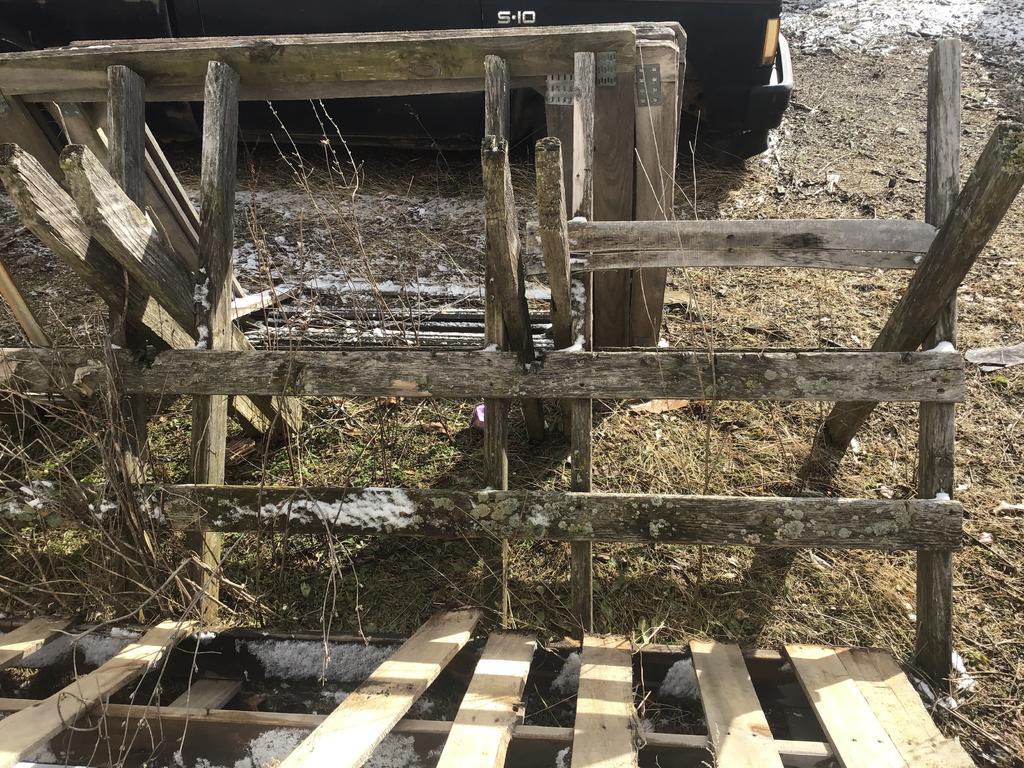

Pullstart 71,144 #19 Posted March 16, 2019 @pfrederi this stand was built for cutting up small logs and slab wood. 2 Share this post Link to post Share on other sites
