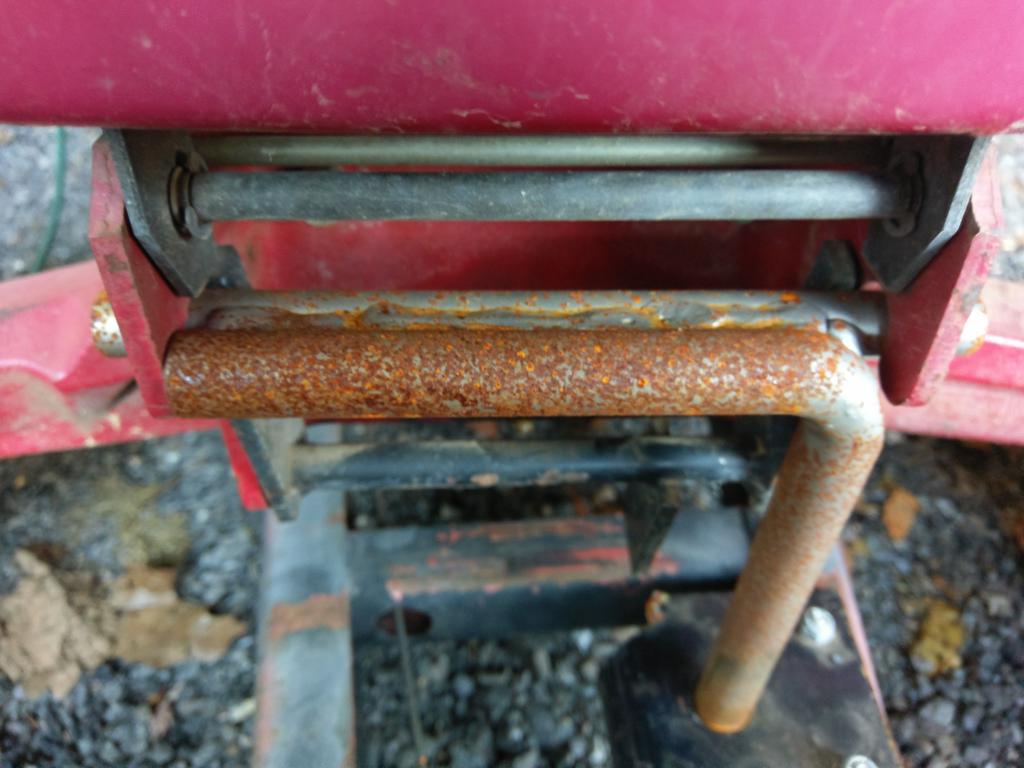

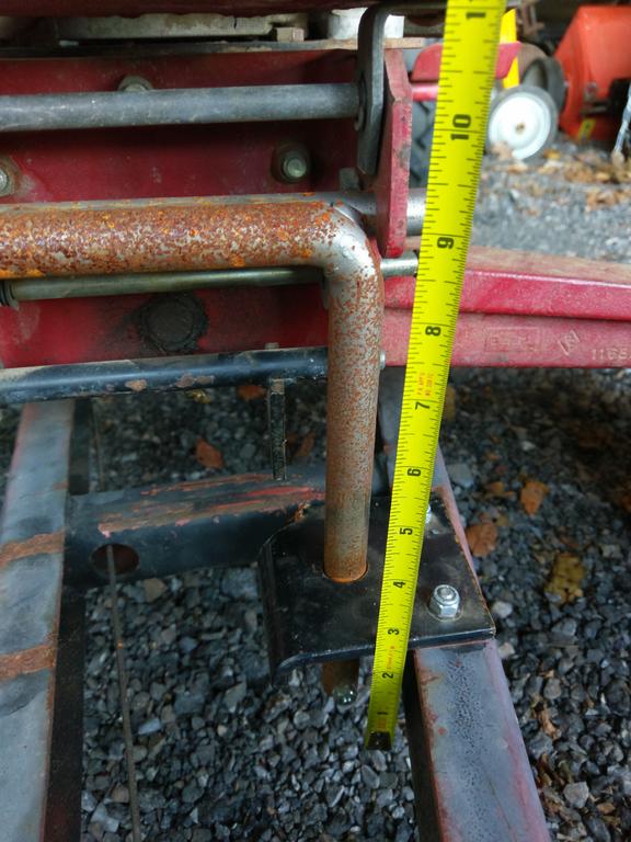

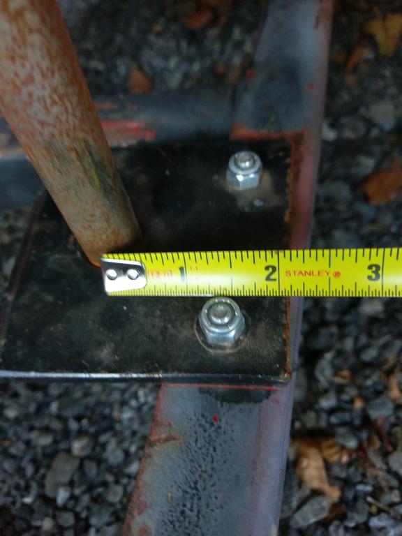

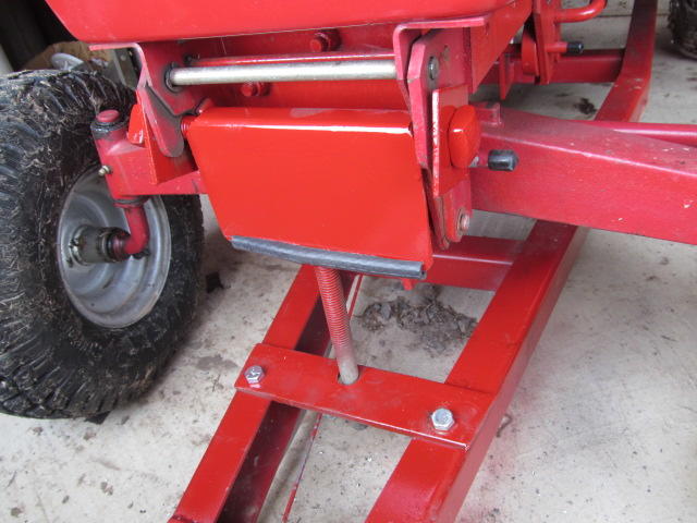

Ed Kennell 47,612 #2 Posted March 4, 2019 Here's mine. There were several other designs. Jeff @WV Hillbilly had one . 2 2 Share this post Link to post Share on other sites

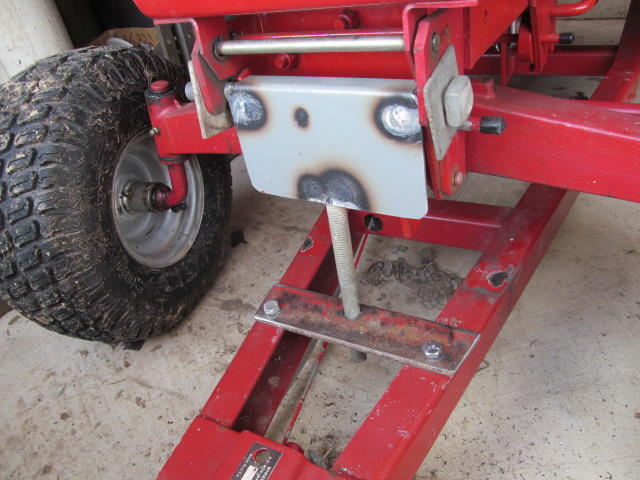

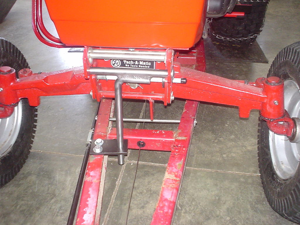

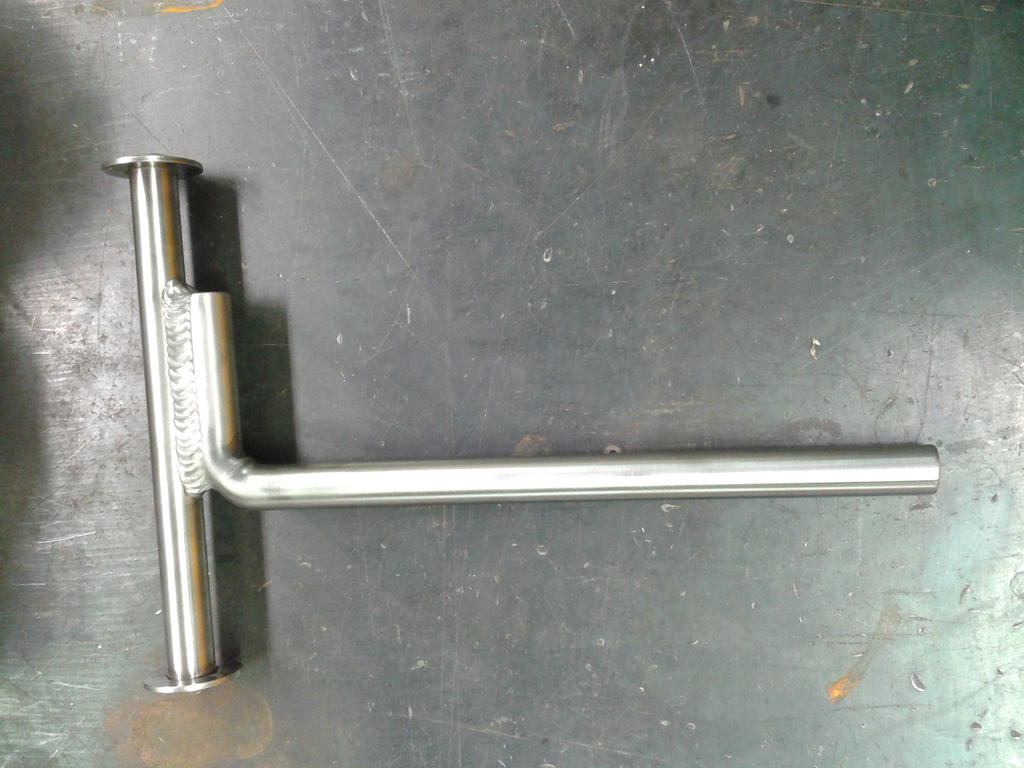

WVHillbilly520H 10,379 #3 Posted March 4, 2019 27 minutes ago, formariz said: There was a thread about a modification to a plow to minimize sideways movement that I cant seem to find . Any ideas anyone? As Ed said here's my version basically taken from the xi series...and @cleat also did one too. 2 2 Share this post Link to post Share on other sites

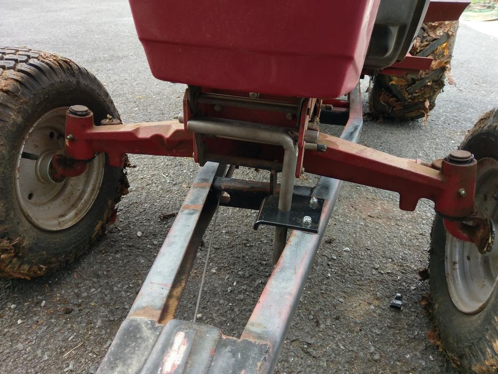

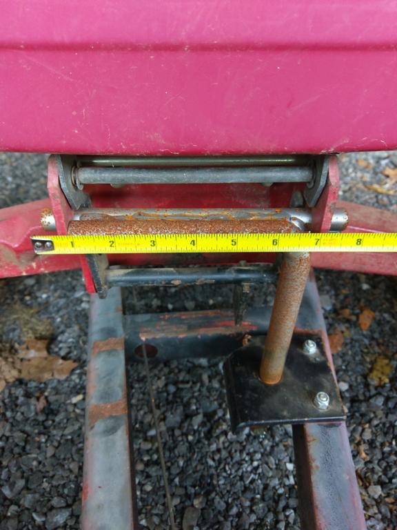

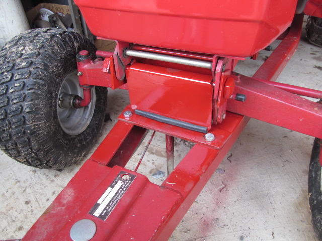

cleat 9,380 #4 Posted March 5, 2019 (edited) Here is my version. Works great but it does squeak a bit. And here are the plans. Snow blade stabilizer.pdf Cleat Edited March 7, 2019 by cleat 1 3 1 Share this post Link to post Share on other sites
WVHillbilly520H 10,379 #5 Posted March 6, 2019 @formariz....the PDF file blue print for my antisway bar is in this thread 2cd page post #30, Jeff. 1 Share this post Link to post Share on other sites
peter lena 10,091 #6 Posted March 7, 2019 cleat, like your plow stabilizer, have found that silicone grease , really stays with tough applications, Pete Share this post Link to post Share on other sites
cleat 9,380 #7 Posted March 7, 2019 I will try that next time it gets used. Share this post Link to post Share on other sites
