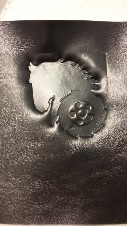

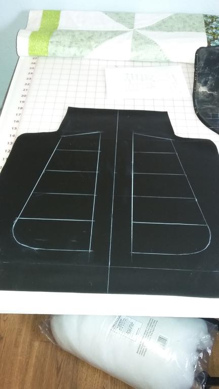

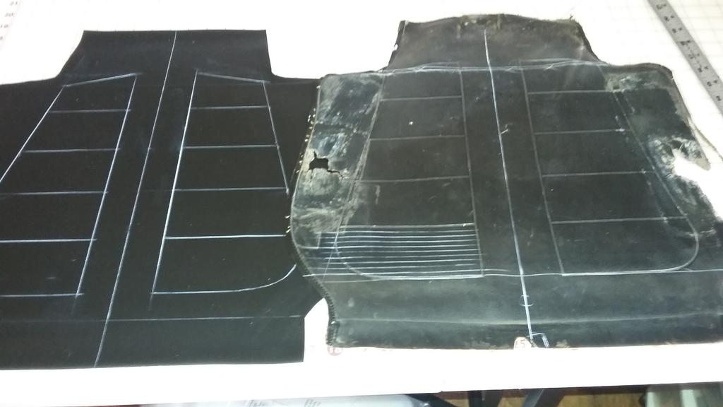

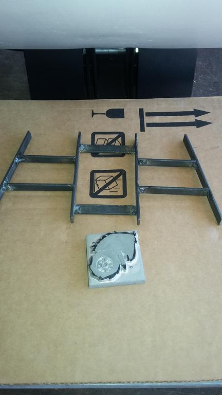

BOB ELLISON 2,983 #1 Posted February 25, 2019 The C160 I have didn't come with the 2 piece seat so I purchased one from Northern tool. It does look good and is comfortable BUT I wanted an original looking seat. So after making the seats for the lawn ranger and 1054/953 I've decided to give it a try. I did buy a seat that I could make patterns from and I can get very close to original. But with the c160 seat there's a big problem trying to duplicate them , they have designs in the back and the seat. Lines in the seat and the back and the back also has the wheelhorse emblem. I've been working on it since October 2018 and as the weather get better I can get in my garage to make a heated frame to make the designs in the seat and back. I had a die made for the Wheelhorse emblem. But this is the biggest problem I've run into. The back has a 1/6" steel plate that it's glued to and the seat has a 1/32 galvanized plate that it's glued to. I can't make these because it's not cost effective to try to reproduce it. So I can't charge what it would cost me to make a complete set. There for I may make the replacement seat and back that can be installed by the owner if they have the old steel back and seat. Maybe I'll make a video on how to install the new seat and back. Here is a few pictures to show some of the progress I've made. It will still be some time before I get a set completed and ready to install.but I hope to have them at the Big Show this year. Hopefully they'll look like the last picture when I'm done . Ps the last picture was borrowed and it's not mine. Yet 8 19 Share this post Link to post Share on other sites

BOB ELLISON 2,983 #6 Posted February 25, 2019 (edited) 54 minutes ago, WHX22 said: I always liked that style of seat and would look good on any model tractor. Excellent Bob but I will ask the question the other fellas will surely want to know. Can the the die be used on the other seats and the fine covers you make? Not really sure but I don't think it could be used on a formed seat. I had to buy a heated press and I'm still trying to figure out how it will work on a flat piece of vinyl. Sort of like a t-shirt is imprinted with the pictures . The die is not only heated but pressed into the fabric. The seats I make are 1 inch pleated vinyl and it will not work on them. Edited February 25, 2019 by BOB ELLISON 1 Share this post Link to post Share on other sites

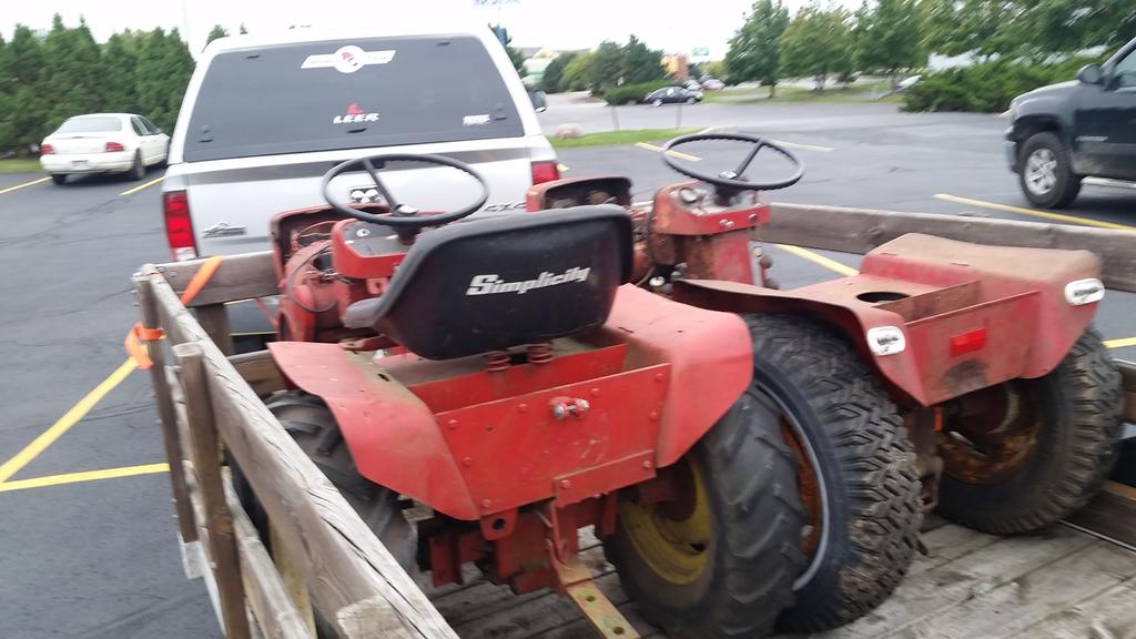

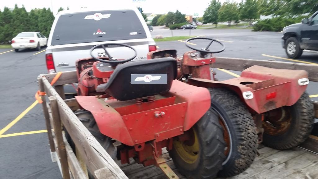

WHX?? 58,388 #20 Posted February 26, 2019 (edited) Richard @953 nut what's your thoughts on putting that style of seat (C160) on a 953? Going to need a seat for one this summer but now on the fence about looking for a orginal 953 frame and having Bob cover it or one like above? Nothin against Simplecities but this one has gots to go! Nether tractor came with the frame so have to start from scratch either way. Edited February 26, 2019 by WHX22 1 1 Share this post Link to post Share on other sites
Super-C 4 me 612 #21 Posted February 26, 2019 On 2/24/2019 at 7:05 PM, BOB ELLISON said: The C160 I have didn't come with the 2 piece seat so I purchased one from Northern tool. It does look good and is comfortable BUT I wanted an original looking seat. So after making the seats for the lawn ranger and 1054/953 I've decided to give it a try. I did buy a seat that I could make patterns from and I can get very close to original. But with the c160 seat there's a big problem trying to duplicate them , they have designs in the back and the seat. Lines in the seat and the back and the back also has the wheelhorse emblem. I've been working on it since October 2018 and as the weather get better I can get in my garage to make a heated frame to make the designs in the seat and back. I had a die made for the Wheelhorse emblem. But this is the biggest problem I've run into. The back has a 1/6" steel plate that it's glued to and the seat has a 1/32 galvanized plate that it's glued to. I can't make these because it's not cost effective to try to reproduce it. So I can't charge what it would cost me to make a complete set. There for I may make the replacement seat and back that can be installed by the owner if they have the old steel back and seat. Maybe I'll make a video on how to install the new seat and back. Here is a few pictures to show some of the progress I've made. It will still be some time before I get a set completed and ready to install.but I hope to have them at the Big Show this year. Hopefully they'll look like the last picture when I'm done . Ps the last picture was borrowed and it's not mine. Yet Very nice Work I'd be up for one as well when your ready 2 Share this post Link to post Share on other sites
953 nut 70,665 #22 Posted February 26, 2019 4 hours ago, WHX22 said: what's your thoughts on putting that style of seat (C160) on a 953? I don't have a problem with a bit of custom work on a 953, heck I've got one with a seat like that Simplicity seat (mine came from Tractor Supply) and it is very comfortable. I bet Terry @Vinylguy has a sticker big enough to cover that up. 3 2 Share this post Link to post Share on other sites

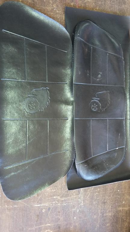

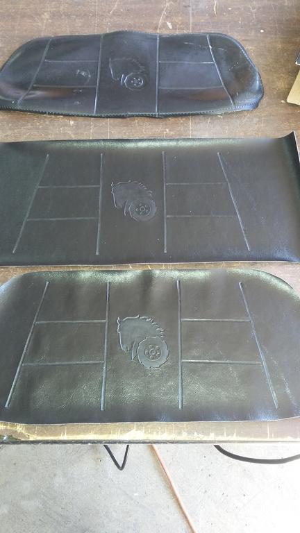

BOB ELLISON 2,983 #23 Posted April 8, 2019 Well trying to make some headway now that the weather has improved. I started making the frame for the back trying to get it just right and I had to get me a new hobart welder. But after 2 weeks of off and on bad weather I've got it as close as I can. I bought a heat press to heat and impress the die and frame into the vinyl. This is what I have so far. 15 Share this post Link to post Share on other sites

BOB ELLISON 2,983 #25 Posted April 8, 2019 21 minutes ago, dells68 said: That is unbelievable Bob. Looks beautiful!! Thank you dell. But now I see why I didn't want to make these last year. So much work and money just to make one. So I'll have to make a dozen or two just to brake even. This is the most time consuming seat to make and now I have to weld the seat frame to make it. 3 Share this post Link to post Share on other sites
