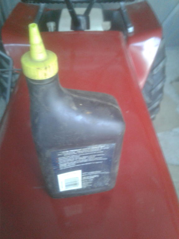

Herder 2,356 #11 Posted February 17, 2019 10 minutes ago, ebinmaine said: @Herder Adam what, exactly, do you do to prime the system? I've never had to do this... Good morning EB I put fuel in a squeeze bottle with a nipple on it and use it to prime the system. The fuel filter needs to primed too. Share this post Link to post Share on other sites
ebinmaine 81,139 #12 Posted February 17, 2019 Just now, Herder said: Good morning EB I put fuel in a squeeze bottle with a nipple on it and use it to prime the system. The fuel filter needs to primed too. I can get good flow all the way to the carb inlet. Is there a way to fill the carb bowl from the outside front? Or should I just pop off the line and drip fuel in by holding a hose to the carb inlet and dropping gas in it? Share this post Link to post Share on other sites
Herder 2,356 #13 Posted February 17, 2019 This is the squeeze bottle that I use. Primitive I know but it works. I start prior to the fuel filter and lightly squeeze fuel through the system. This should plush most of the air out and make starting the engine easier. I would recommend that you crack the fuel line prior to the carburetor so that you can remove the air from the system. And like I said before I usually remove the spark plug and put a little bit of fuel down the cylinder head prior to starting it so that the engine fire and so the fuel pump begins to deliver fuel to the carburetor. I've had times before where these small tractors have run out of fuel and the system gets air bound once the system is air bound they can be very difficult to start. 1 1 Share this post Link to post Share on other sites
