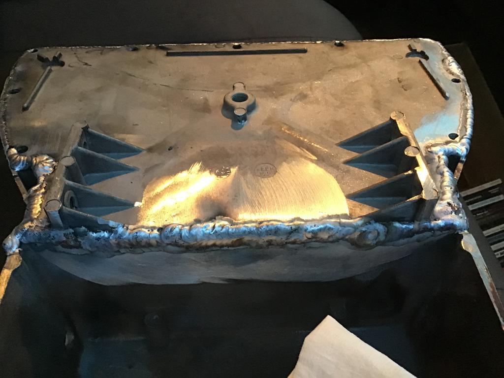

dells68 7,499 #1 Posted February 13, 2019 (edited) Well, being the lazy bones I am, I decided to use POR15 gas tank sealant to seal the 2 piece tank on Emory’s 633. I had bought a couple of seals from Lowell at the Big Show, but was afraid I’d break a bolt off. Well after having gas in the tank for a few weeks, it started to leak again. I took a light and looked inside and found the sealant delaminating from the aluminum. I have used it in metal car tanks with no issues and prepped this one by the directions, but it just didn’t seem to adhere to the aluminum. Anybody else had this issue? I did manage to get the tank apart to clean it with breaking only 2 bolts. I drilled them out and retapped them. Any ideas on a good sealant to use on the gasket to add a little more protection against leaks? I can’t think of anything that would resist gas. Edited February 13, 2019 by dells68 3 Share this post Link to post Share on other sites

Achto 32,896 #14 Posted February 13, 2019 You could always take the route that @pullstart took with his latest build. Looks like a forever fix to me. 4 1 Share this post Link to post Share on other sites
