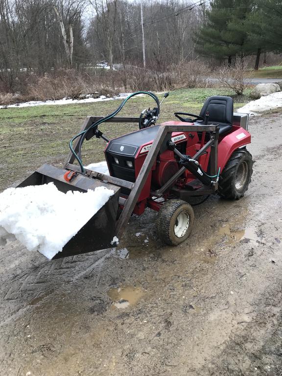

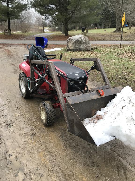

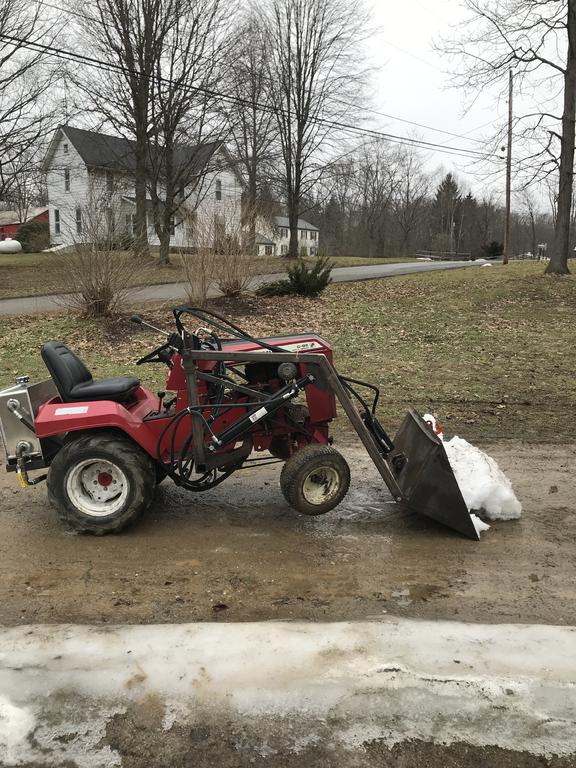

Firebug 267 #1 Posted February 5, 2019 Just wanted to share a few pics of my latest acquisition. Got it in November as an unfinished project. The loader is now complete, just have some cleanup work to do, paint, routing the lines etc. anyway, it’s a c85, has in a swapped k341. Run great but it’s loud, baffles are rusted out. Address that later. The loader is home made, 2x2 heavy wall tubing. 3000 psi pump, mounted underneath right where the original mower spindle goes so it uses the original length belt. Aluminum reservoir out back for ballast and one stick control lever. The loader operates smooth with no issues. Will be perfect for work around my 2 acres. Rear fenders are all cracked but I have a set from a work horse to go on after they get a coat of red. The weak spot I see is going to be the 3/4 inch spindles. Thinking at swapping in a 1 inch axle to help remedy that. Also need to move my fittings to the inside, I know me and I’ll end up schearing them off where they are. Any thoughts from the masses on changes that need to be made are appreciated 4 4 Share this post Link to post Share on other sites

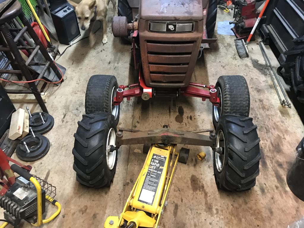

Super-C 4 me 612 #5 Posted February 5, 2019 In the classified adds on here, there is a 520 front axle and reduction steering for sale Both would go nicely on that tractor 2 1 Share this post Link to post Share on other sites
Firebug 267 #6 Posted February 5, 2019 520 axle a direct swap? Share this post Link to post Share on other sites
Firebug 267 #7 Posted February 5, 2019 Pretty sure I had seen that axle for sale at one point but heck if I can find it now Share this post Link to post Share on other sites
roadapples 6,987 #8 Posted February 6, 2019 2 hours ago, Firebug said: 520 axle a direct swap? The axle is, but you'll need longer tie rods if you don't have the whole set up... 1 Share this post Link to post Share on other sites
Achto 31,601 #9 Posted February 6, 2019 2 hours ago, Firebug said: 520 axle a direct swap? I believe so, may need to make some minor alterations for the tie rods. Oh ya, you'll want the tie rods with it they are much heavier. The gear reduction steering would be a nice addition also. I believe that the 520 axle is the only close fit with 1" spindles. 1 Share this post Link to post Share on other sites
elcamino/wheelhorse 9,363 #10 Posted February 6, 2019 @Firebug Check with @richmondred01 I think he has the axle etc that you need. 1 Share this post Link to post Share on other sites
Achto 31,601 #11 Posted February 6, 2019 Bamm!! Your name looks good in red @Firebug. Thank you for becoming a supporter!! 2 Share this post Link to post Share on other sites

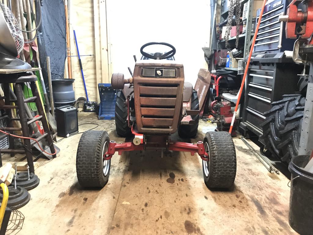

Firebug 267 #12 Posted February 6, 2019 for The help I’ve recieved on the site becoming a supporter is well worth it. This kind of experience and expertise anywhere else would cost a fortune. Here are the rest of the pics I wasn’t able to load earlier 2 7 Share this post Link to post Share on other sites
wallfish 19,746 #13 Posted February 6, 2019 4 hours ago, Firebug said: Any thoughts from the masses on changes that need to be made are appreciated Nice Setup! You can turn the end cap on those type of cylinders so the fittings are facing up or down. Just loosen the 4 long bolts to spin the end cap and turn it 90 deg. I'd be concerned with all that hose underneath catching something. It could easily snap one of the fittings at the pump if it does snag on something. Also a good idea to add a hydraulic oil filter, usually on the return side. And make some kind of lock for the suction hose ball valve to hold it in position. If it gets knocked close by mistake with the pump on, it will ruin the pump. (even a zip tie would work). Add more weight to the rear like wheel weights and/or filling the tires. It'll get light in the rear with a heavy load. 1 Share this post Link to post Share on other sites
Firebug 267 #14 Posted February 6, 2019 Thank you, I had planned on turning the fittings up. That was on the list to do when I pull it apart for paint. I have a filter for it but contemplated the need since it’s a closed system, how much dirt will get in there? I also have plans for routing and securing the lines. I plan on running them along the frame rail for protection Share this post Link to post Share on other sites
Firebug 267 #15 Posted February 6, 2019 I have mounting block on order from fastenal but they are on back order till the end of February, similar to the green ones in the picture 1 Share this post Link to post Share on other sites
wallfish 19,746 #16 Posted February 6, 2019 8 minutes ago, Firebug said: I have a filter for it but contemplated the need since it’s a closed system, how much dirt will get in there? The ARK factory FELs didn't come with filter but it sure couldn't hurt. Some dust will get past the wiper seals on the rods but most would get in through the reservoir as breaths air in and out during the fluid level changes. There's plenty of info out there on the web to read up on and make a decision either way. 1 Share this post Link to post Share on other sites
JoeM 9,768 #17 Posted February 6, 2019 you will get more use out of that then you think. I use mine for just about anything, I even use it as a mobile saw horse! Looks pretty good, that is one super cool oil tank. All those ideas are real good. The filter is just not for dirt but will catch any metal in the system, especially if something fails the tank will stay clean. Not too much of a need to change the filter very often, probably 3, 4 years or so. One thing to keep an eye on is the bars running from the towers to the frame at the front wheels. Make sure the pins, or you may have bolts, holding those on are secure, that is a critical part of the structural strength. Mine uses bolts and they worked loose, I double nut them. I had my pump on my D loader mounted that way, worked out good. 1 Share this post Link to post Share on other sites
Firebug 267 #18 Posted February 6, 2019 Those are bolted to factory holes in the frame. Grade 5 bolts and I used nylock nuts to help keep them from loosening up 1 Share this post Link to post Share on other sites
MalMac 1,336 #19 Posted February 6, 2019 As mentioned, you need to convert to the 520 swept axel with steering reduction. I have used a loader on a C141 with just the HD front spindle kit. Still was way to hard on the stock fan gear set up. You will eventually break or put extream wear on your fan gear. The steering reduction will eliminate that and make way easier to steeer. It is more or less a straight bolt on. You may have to grinde a little off one of the arms of your lifting bell crank. It’s just a tad to long and will hit the bevel gear on the steering reduction. I did all this when I switched my Ark loader over to a 414-8. The C141 just got wore out from the loader use. The loaders are hard on the front ends and steering. If your going to be using it a lot you will be glad you did convert it. 1 Share this post Link to post Share on other sites

Super-C 4 me 612 #24 Posted February 7, 2019 Just put a 520 swept axle in my C160 I’m using it with a 2 snow thrower this winter and did not like the flex with the 3/4 spindles. 2 1 Share this post Link to post Share on other sites
Firebug 267 #25 Posted February 7, 2019 I have a set of 1 inch spindles, access to an axle, just would need the tie rods. Is the gear reduction steering necessary? Share this post Link to post Share on other sites
