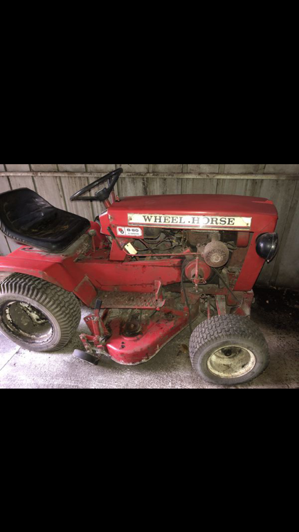

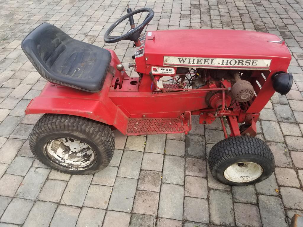

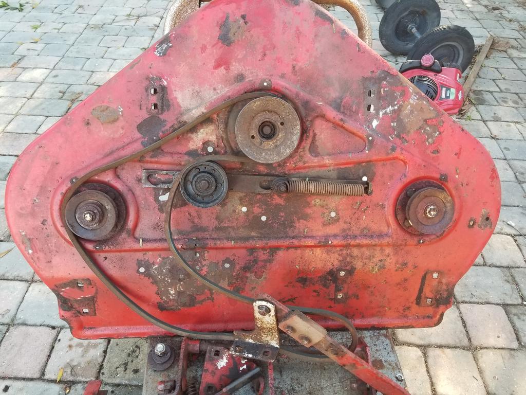

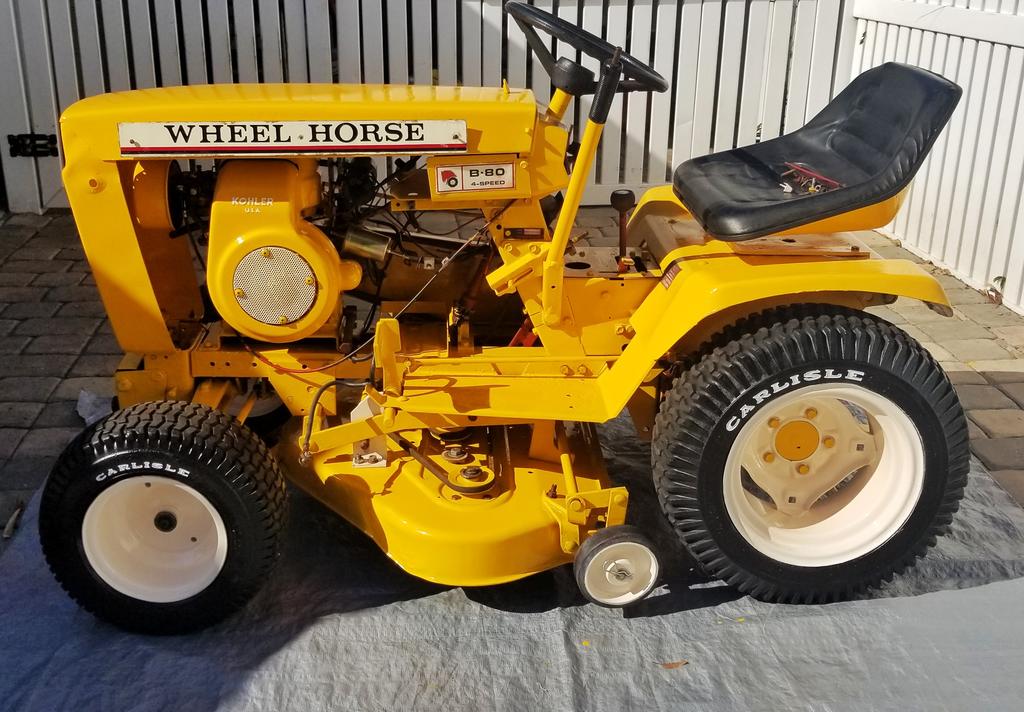

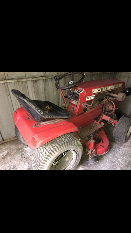

svir 17 #1 Posted January 30, 2019 Hello. I recently stumbled upon this B-80 and at first glance I was put off because I'd never heard of this brand (it was way before my time). Did some digging online and it turned out that it was made in South Bend, IN. I spent some time last year, so I found it to be a weird coincidence and I now needed to see it. An appointment was set and when I went to look at the mower, I realized that the previous owner's family were liquidating the estate, so not much of info was available about the mower or its maintenance. Once the mower made the journey to it's new home, I immediately started to take it apart. At this point I'm feeling good because of the simplicity of how things are attached and the ease they come apart. Once the deck was off, I got a new battery and some fresh gas and much to my surprise, it started and it ran pretty good. As can be seen, I've chosen to deviate from the stock red color. At the moment, the tractor is in the final stages and I am eager to put it to work. Here comes the problem. When I got the mower, the belt from the deck to the PTO was in pieces. Did some reading and ended up purchasing a trublue 97". Unfortunately the belt is way too long. I measured today with the mule drive in its middle adjustment point and the measurement came out to 89". Remeasured several times and yes, it comes out to 89". How can this be? The deck is 36" with rear discharge. I did attached back the same way it was removed. Any help would be appreciated. Thank you, George 3 5 Share this post Link to post Share on other sites

wildman 205 #3 Posted January 30, 2019 You sure you have the fork of the deck mount in the attachamatic? If not the deck will still hook up but the belt will be long if that a check Share this post Link to post Share on other sites
wildman 205 #4 Posted January 30, 2019 Ole girl don't look bad painted yellow Share this post Link to post Share on other sites
Mikey the Monkey 701 #6 Posted January 30, 2019 love the color. makes it a B-80 industrial 1 1 Share this post Link to post Share on other sites
WVHillbilly520H 10,379 #7 Posted January 30, 2019 Me thinks we wanted a Cub Cadet, but it does look good. 2 Share this post Link to post Share on other sites
Lane Ranger 12,160 #8 Posted January 30, 2019 svir: FOR A REAR DISCHARGE 36 INCH MOWER DECK Drive belt 102607 (1/2" x 89.12") when used on medium frame 43-1/2" wheelbase tractors 1974 B-80 4-Speed models 1-0140 and 1-0145svi 1 Share this post Link to post Share on other sites
svir 17 #9 Posted January 30, 2019 Thank you all. Just placed an order for the correct belt. Will bring an update once it gets in. 1 Share this post Link to post Share on other sites

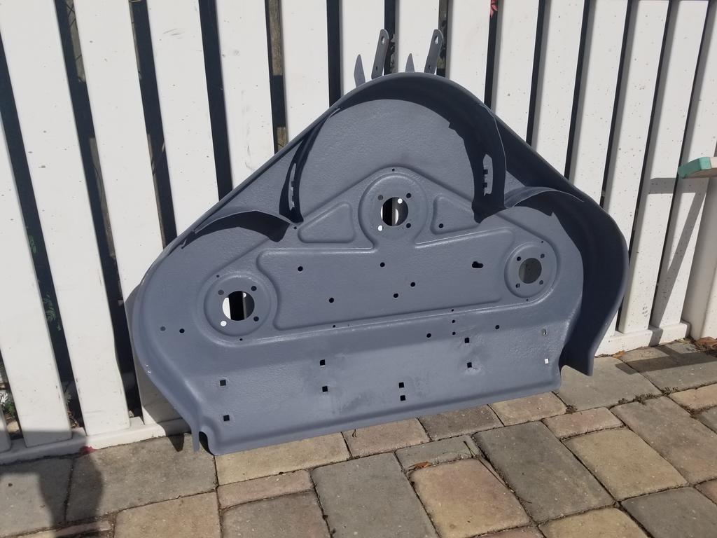

svir 17 #13 Posted January 31, 2019 While I'm waiting for the parts to arrive. Here are some pics from the journey... Lots of seized bolts that gave me a run for the money. 1 Share this post Link to post Share on other sites

Tuneup 1,459 #16 Posted January 31, 2019 I appreciate your attention to detail - nice job! Share this post Link to post Share on other sites

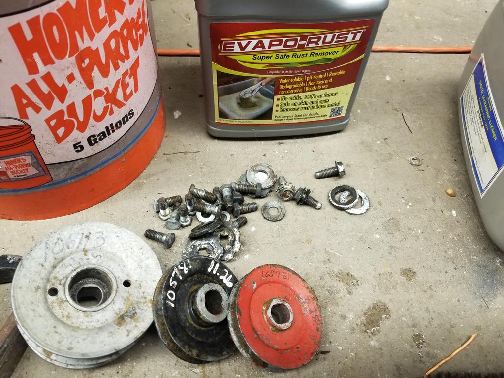

svir 17 #17 Posted January 31, 2019 Evaporust revealed color and part numbers lol.. 2 1 Share this post Link to post Share on other sites
953 nut 70,071 #18 Posted January 31, 2019 1 hour ago, svir said: Used up my upload quota. More pics later. There is a limit on storage on here unless you become a supporter. https://www.wheelhorseforum.com/store/category/1-redsquare-support/ You could delete that "YELLOW" picture if you want to free up some space! 2 Share this post Link to post Share on other sites

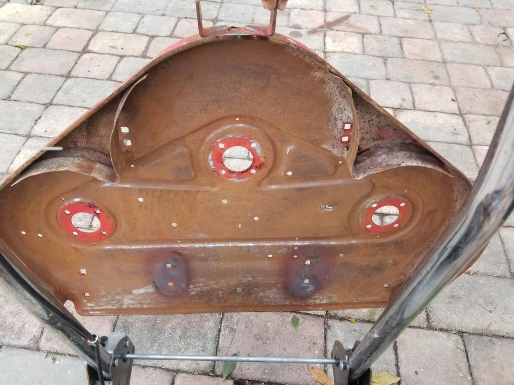

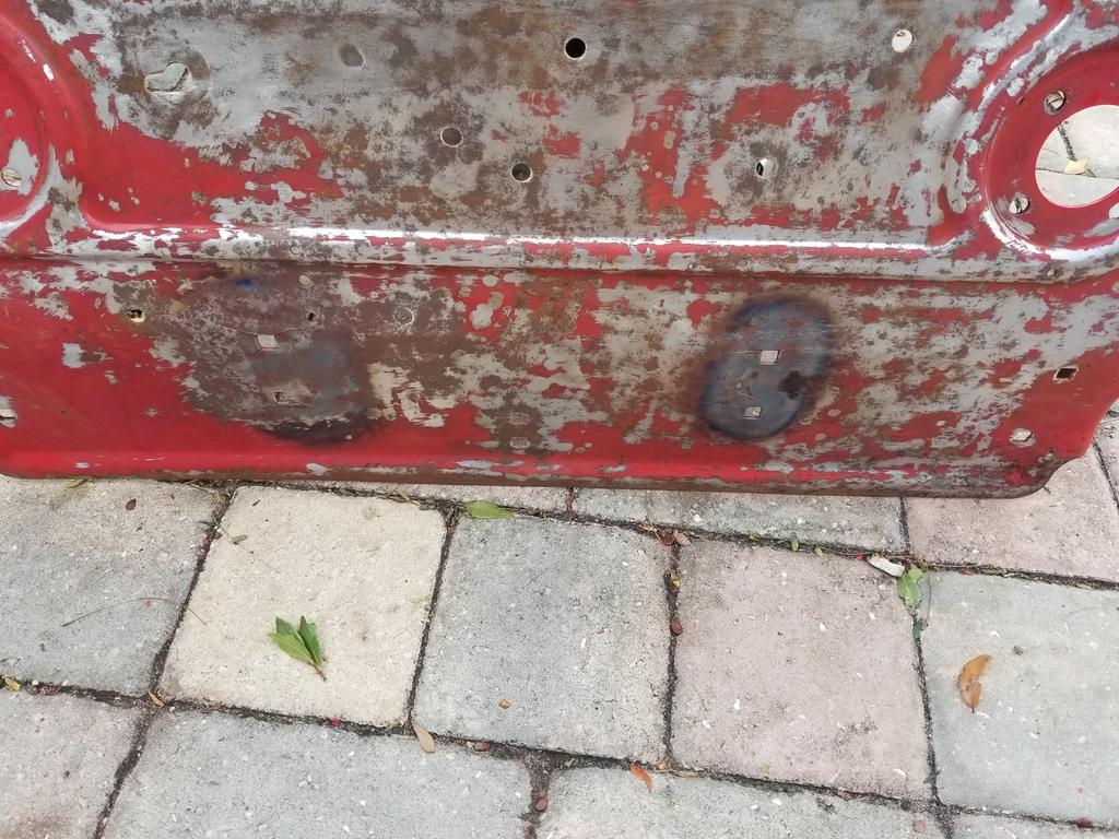

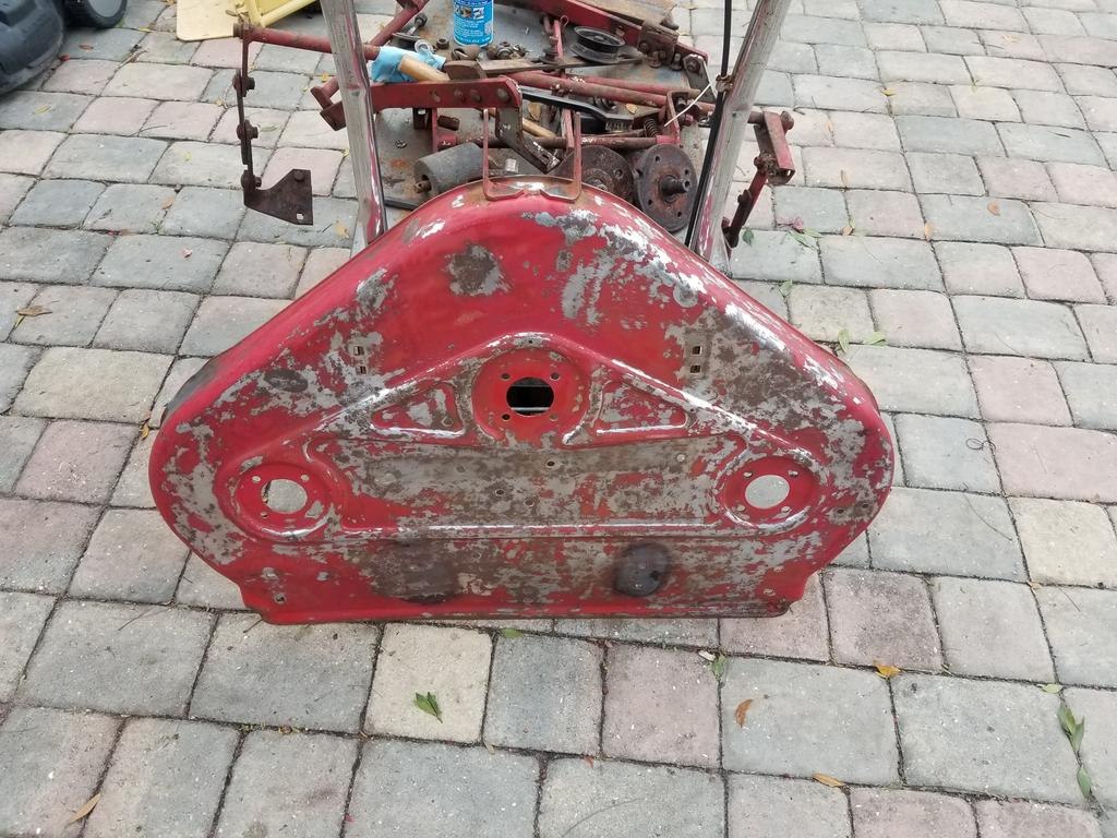

svir 17 #19 Posted January 31, 2019 The deck had some cracks and dents. Hopefully the dose of heat, lost of hammering and then some welding be a permanent fix and stop the cracks from spreading. Share this post Link to post Share on other sites
ebinmaine 81,048 #20 Posted January 31, 2019 1 minute ago, svir said: The deck had some cracks and dents. Hopefully the dose of heat, lost of hammering and then some welding be a permanent fix and stop the cracks from spreading. I'm no metal expert so get a second opinion but I've heard that you can drill a hole at the end of the crack to stop it from going any further Share this post Link to post Share on other sites
svir 17 #21 Posted January 31, 2019 Just now, ebinmaine said: I'm no metal expert so get a second opinion but I've heard that you can drill a hole at the end of the crack to stop it from going any further I did that and then welded off the ends. 1 Share this post Link to post Share on other sites
