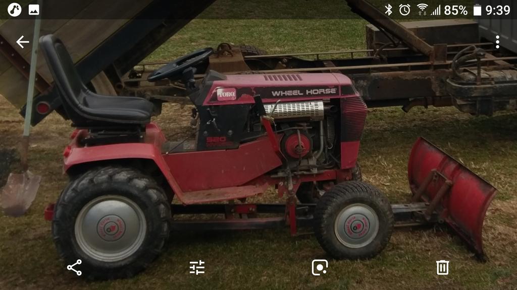

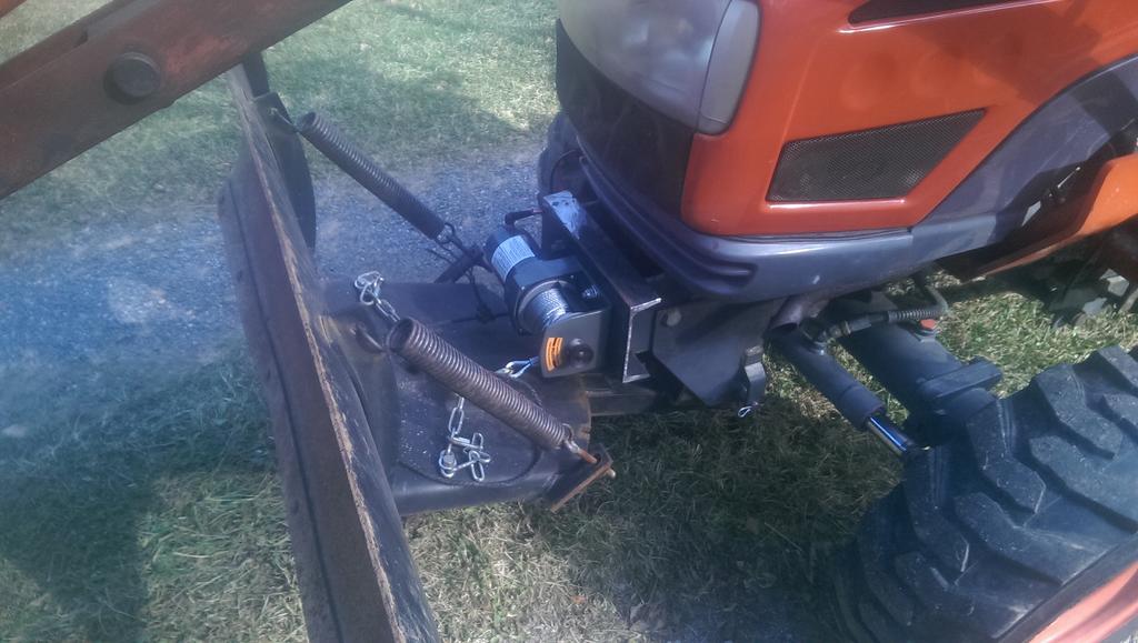

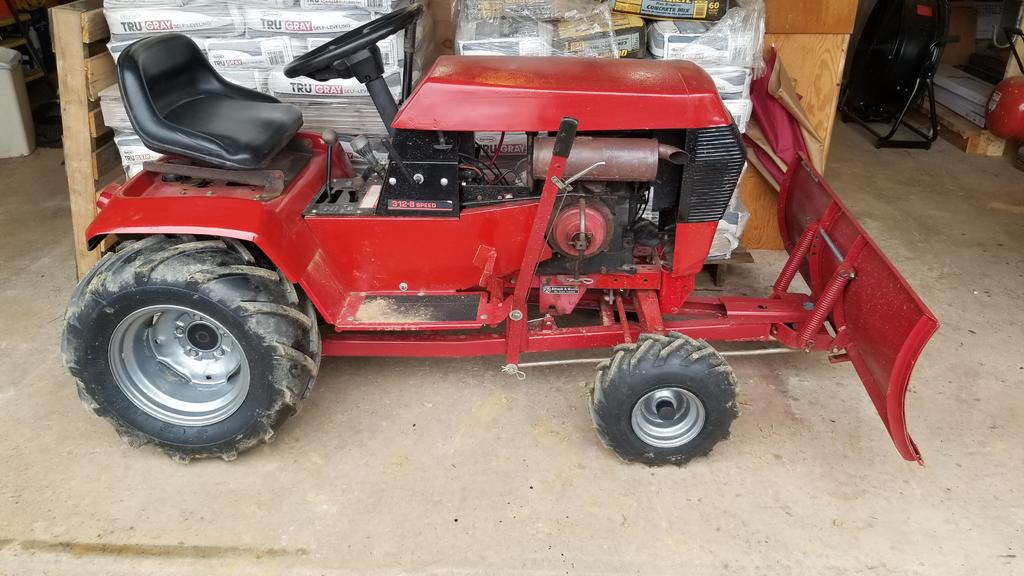

WVHillbilly520H 10,379 #3 Posted January 19, 2019 24 minutes ago, Bmaui24 said: Does or has anyone installed an electric lift on a 312-8 tractor for the snow/dozer blade? I'd like to do this but need info on it. HMU @richmondred01, put it on his 520-8 maybe he'll chime in to help give you perspective, personally I'm a hydro/hydralic fan... 9 minutes ago, ebinmaine said: I've thought about it as well. I've considered mounting a winch to the front of the frame of the tractor. Like this Eric? 2 Share this post Link to post Share on other sites

ebinmaine 80,307 #5 Posted January 19, 2019 @WVHillbilly520H Yes Jeff, that's just about exactly what I was thinking. I have a plow frame here that has been cut down so that it would mount in the mid mount saddle of a horse for whatever reason of a previous owner. Share this post Link to post Share on other sites

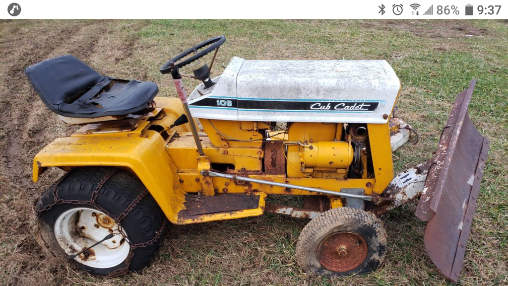

WVHillbilly520H 10,379 #9 Posted January 19, 2019 17 minutes ago, pfrederi said: I am sure there are ways to come up with an electric lift...but for snow plowing a hydro is the way to go. Once you try one you will never go back to a gear drive for snowplowing. The high speed reverse and quick directional change plus the fast blade lifting make it a whole bunch better. 110% , that's how I felt and still do when I went from my CC 106 to the 520H 20 years ago. 1 1 Share this post Link to post Share on other sites

richmondred01 2,389 #13 Posted January 19, 2019 (edited) I put a factory wheel horse electric lift on the 520-8. The lift works very well. Is it slower then the hydro lift, yes. Im not a real fan of the hydros in the winter months. That’s just my opinion. I put that 520-8 in gear and nothing stops it until the wheels spin. Unlike the the hydro units that tend to wimp out when the pushing gets tough. However, i believe the 8 speed has more power then the hydro so it’s a trade off and the electric lift certainly beats the hand lift. The only thing better for plowing for me would be an 8 speed with a hydro lift like the older IH cub cadets had. Edited January 19, 2019 by richmondred01 2 Share this post Link to post Share on other sites

Bmaui24 38 #20 Posted January 25, 2019 On 1/19/2019 at 7:46 AM, WVHillbilly520H said: @richmondred01, put it on his 520-8 maybe he'll chime in to help give you perspective, personally I'm a hydro/hydralic fan... Like this Eric? Would work. I'm just concerned about having enough down pressure. Share this post Link to post Share on other sites

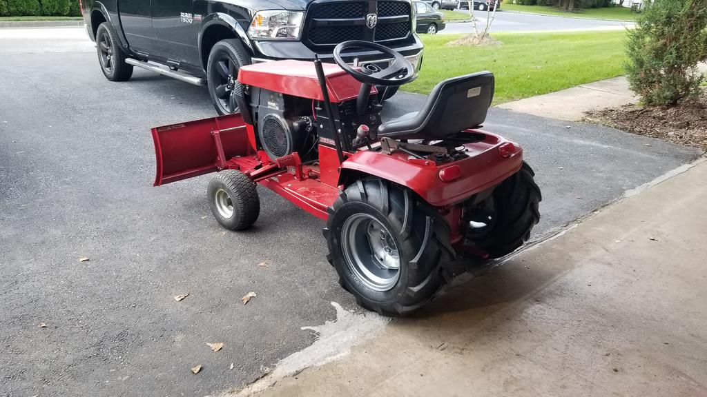

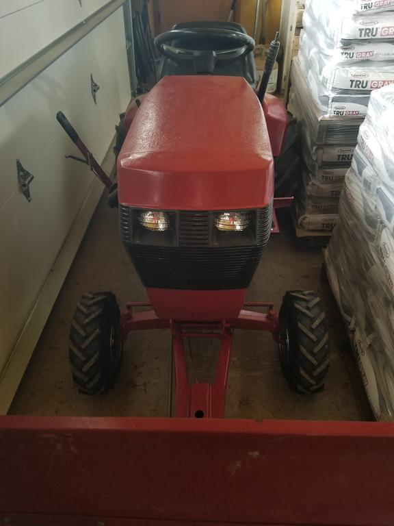

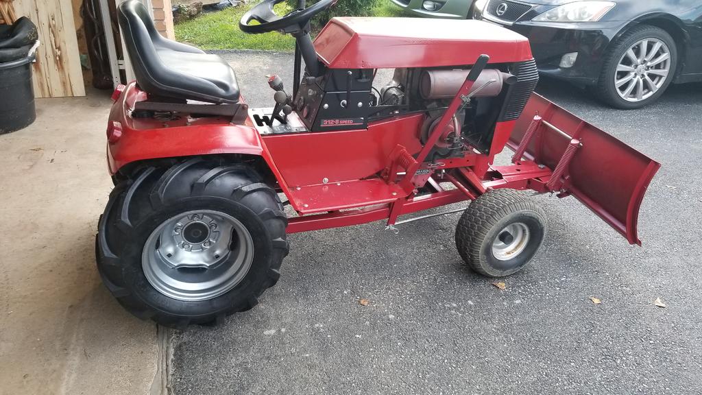

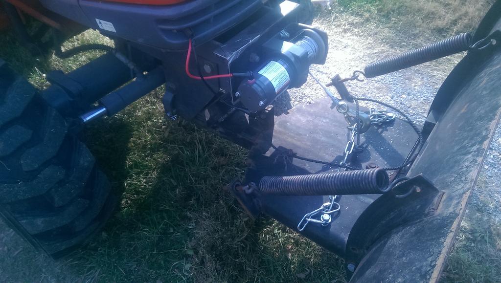

Bmaui24 38 #21 Posted January 25, 2019 (edited) Here is my setup. Edited January 25, 2019 by Bmaui24 2 Share this post Link to post Share on other sites
ebinmaine 80,307 #22 Posted January 25, 2019 2 minutes ago, Bmaui24 said: Would work. I'm just concerned about having enough down pressure. On my snow plow tractor I do occasionally use down pressure to bite into harder snow or places where it has been driven over by a vehicle. I have no real way of measuring how much extra pressure is being exerted but I wonder if, considering you are going to be using a winch, you could put some free weights on the plow or something along that line? 1 1 Share this post Link to post Share on other sites
Bmaui24 38 #23 Posted January 25, 2019 1 minute ago, ebinmaine said: On my snow plow tractor I do occasionally use down pressure to bite into harder snow or places where it has been driven over by a vehicle. I have no real way of measuring how much extra pressure is being exerted but I wonder if, considering you are going to be using a winch, you could put some free weights on the plow or something along that line? Could do that. 2 Share this post Link to post Share on other sites

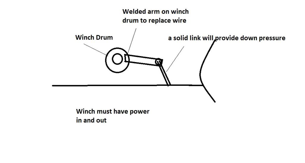

wallfish 20,510 #24 Posted January 25, 2019 How about something like this if you're not concerned with using the cable on the winch. You get more speed and down pressure. Remove the cable and weld an arm onto the winch drum. 1 Share this post Link to post Share on other sites
