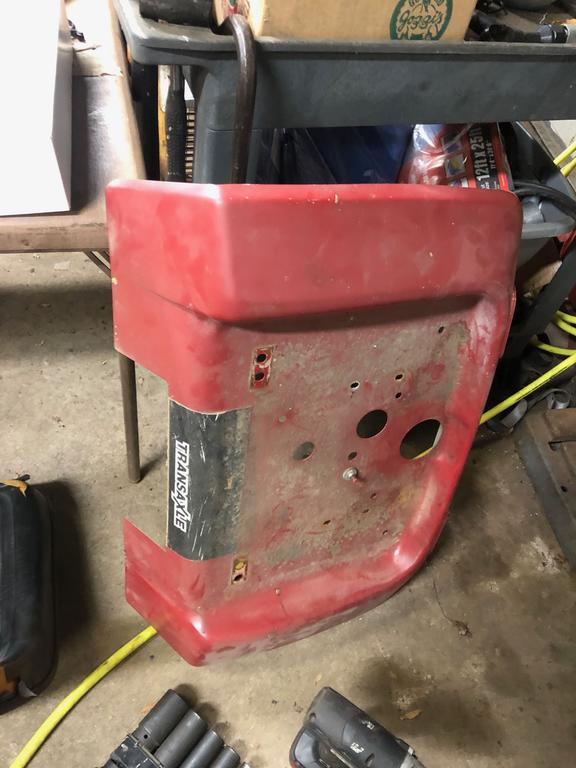

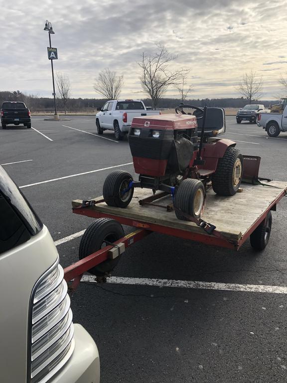

AHenry014 128 #1 Posted January 14, 2019 (edited) My luck has been pretty good lately with Wheel Horse finds. Picked up a 312-8/plow a couple months ago that I serviced and sent on its way. Next came my 418-C, which i am totally keeping for the foreseeable future. This past Saturday i awake and pick up my phone to find a new Craigslist alert email. Less than an hour after it was posted, I was reading the ad for a 1984 GT-1600. Cliffnotes of the ad body were "Parked 3 years ago when my son-in-law lost interest in it", "Runs if you pour gas down the carb" and "sorry its a bit dusty". The few pictures in the ad indicated that it was no longer grey, but now red. A bit of a bummer in my eyes as i used to own a Work Horse and loved the odd coloring. The best part is that it featured a plow and rear wheel horse wheel weights. For 300 bucks with those accessories, how could i go wrong?! I happened to be the first to call at around 8am. About an hour and a half later, it was on my trailer on its way home. The guy couldnt believe the interest he had in it. He said he fielded another 5 callers after me! Its in great shape and appears to have very low hours. The drive belt looks great and the 10yr old battery even holds a charge. The paint job actually looks quite good. Someone masked the stickers carefully prior to painting. Got her rolled into the garage and apart in no time. With something like this that hasnt run in years, my first stop is the carb, but this time started at the fuel pump. The insides of the fuel pump on the carb had seen better days, so we went and picked up a rebuild kit for it. Got that back together and cracked open the carb to find some ugliness at the bottom of the bowl. I removed the idle jet screw and cleaned it out with carb clean and compressed air. "Hey Matt, have you seen the idle screw? It should be next to the screw spring, which is right here!". As luck would have it, I misplaced the screw and had to order a new one. In the meantime, i found the petcock to be clogged and the grommet leaked, so i have one of those on order as well after spilling about a gallon of gas on the floor. Saw that the shift boot was cracked, so ponied up for a new one of those too. I expect those parts later this week. I am not sure what my plans are for this one. Its a perfect time to sell it as it is snow season, but i really like it! It should be a very capable machine with that big 16hp twin in it. It would be kind of neat to see how it does next to the hydro tractor at next years tractorpalooza event! And its always good to have a spare on hand should something go wrong with the main steed. Only have one picture of it so far, but will post more as the project moves along. Edited January 14, 2019 by AHenry014 7 1 Share this post Link to post Share on other sites

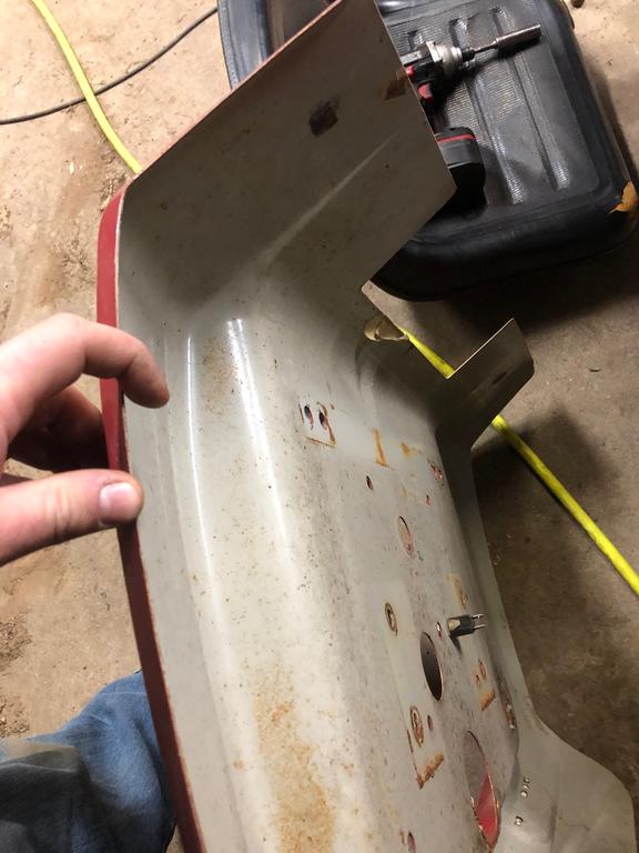

AHenry014 128 #8 Posted January 14, 2019 Yea once i saw the weights i knew i had to try to get my hands on it! It was grey at one point. If you look closely enough at the edges of the stickers, you can see the grey. Can also be seen on the bottom of the hood and the seat pan. 2 Share this post Link to post Share on other sites
Racinbob 13,286 #9 Posted January 14, 2019 All the Work Horses in the 80's were gray. The red Work Horses were way earlier like the 700 and 800. I walked into Countywide Wheel Horse back in 85 and bought a new GT-1100 they had on display because the price was so right. Great tractor. It didn't come with any attachments but I had a spare 48" deck to put on it and it handled it like a dream. 2 1 Share this post Link to post Share on other sites

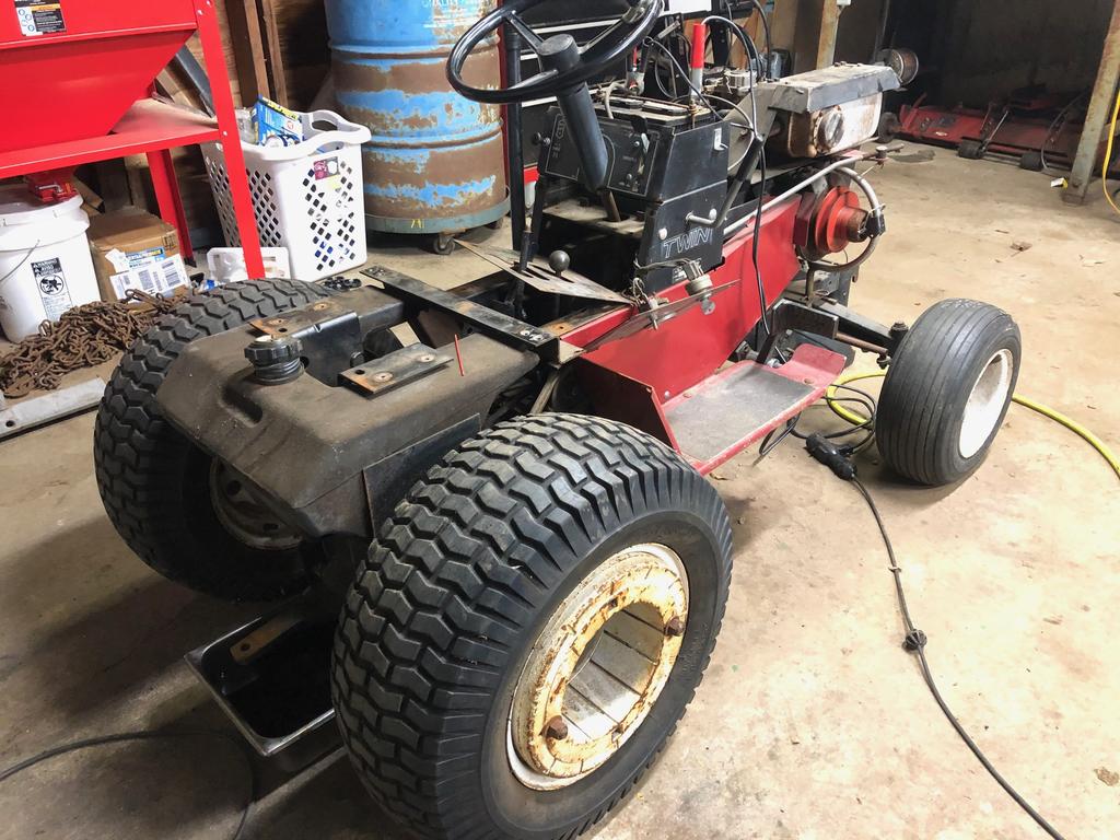

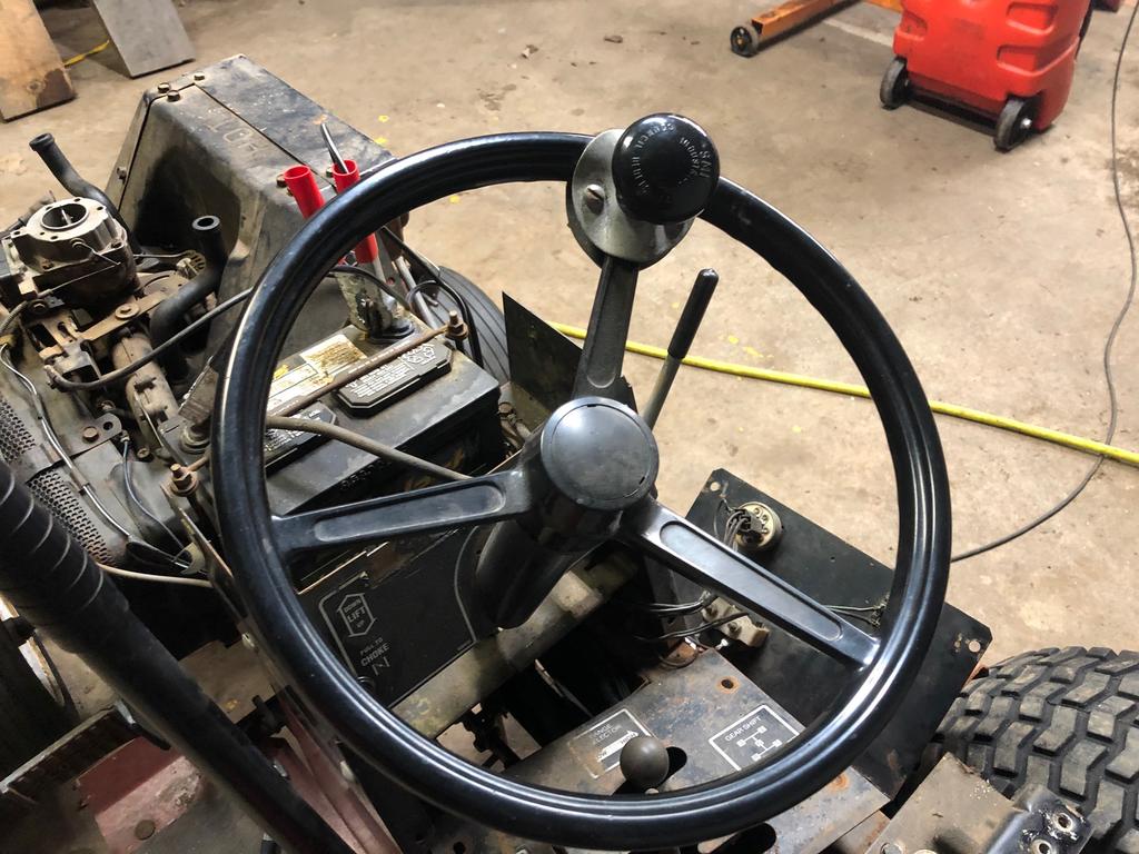

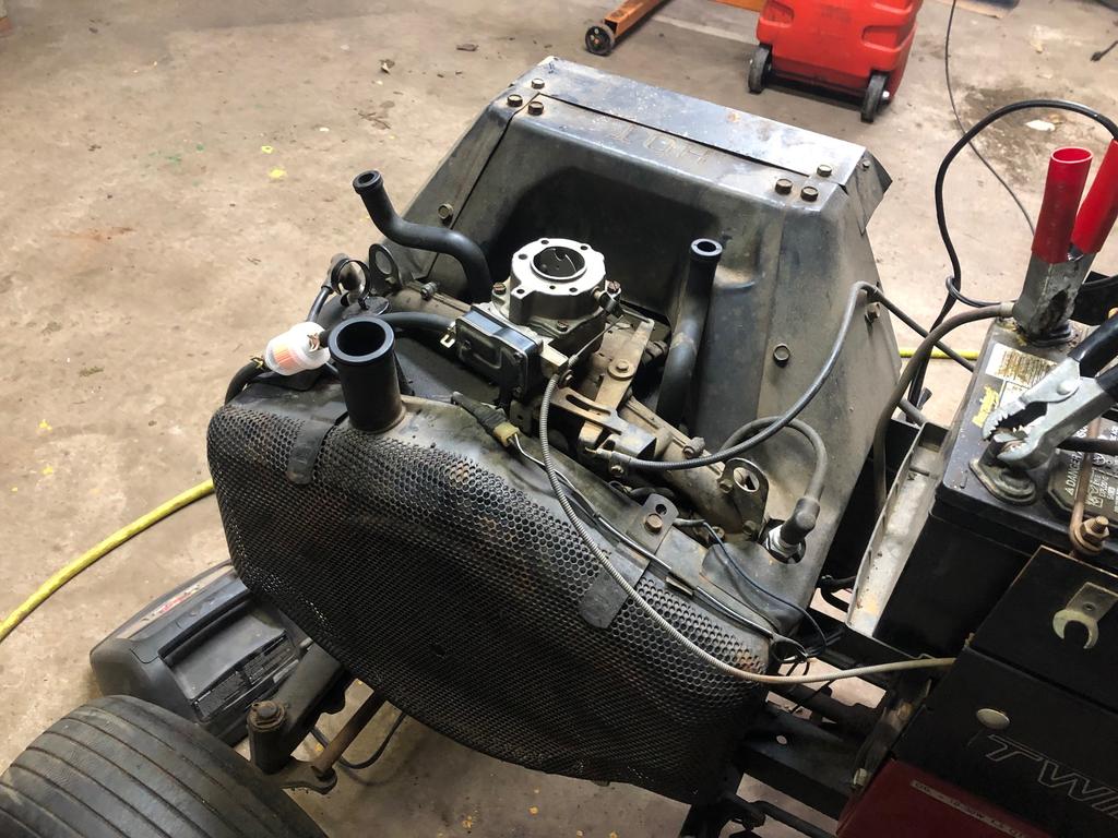

AHenry014 128 #19 Posted January 17, 2019 (edited) So....I found the needle!! I was just tinkering with it last night, trying to be patient waiting for parts when the idle jet screw falls from somewhere near the PTO. Must have blown off when j was cleaning the carb. Oops! I am still waiting on the petcock, so I fed a line into a gas can and she fired right up and it runs great. A bit of blue haze but I think that will clear up with more run time. After a bit of cranking, the battery dwindled away, so I guess the 10yr old battery won’t do. Shucks. Tonight, we drive!! One issue ill need to resolve is that it did not shut down with the key. So ill be searching for a wiring diagram next. EDIT: Got the diagram. Thank goodness to all you folks that downloaded manuals and diagrams! Edited January 17, 2019 by AHenry014 1 1 Share this post Link to post Share on other sites

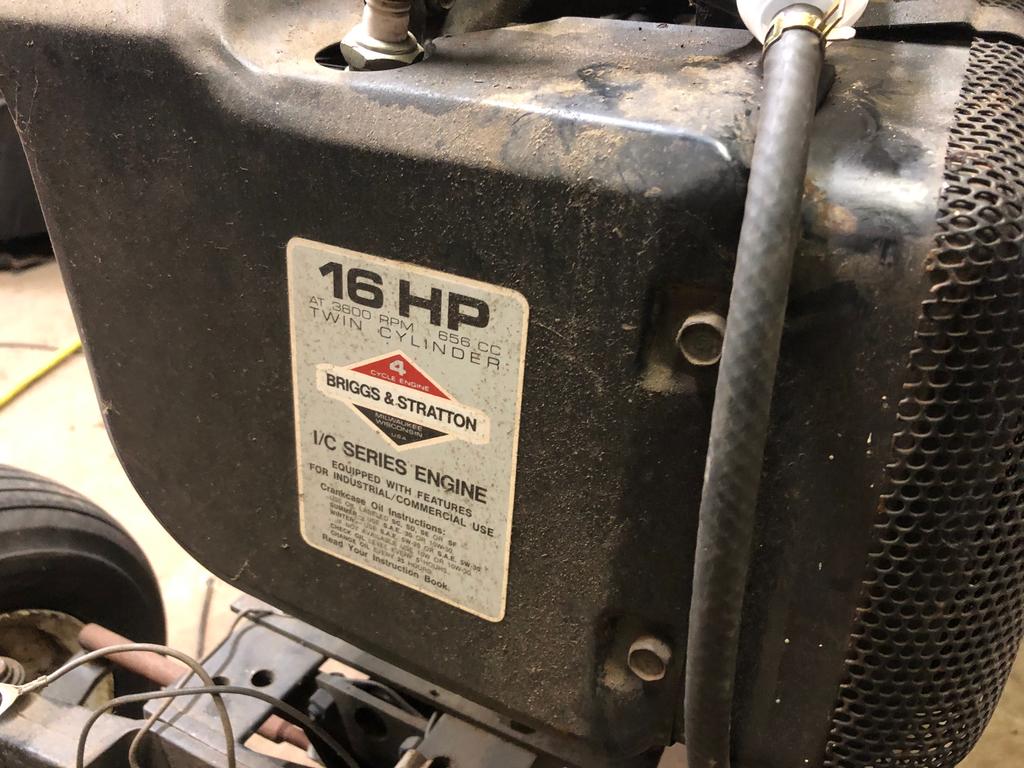

ericj 1,580 #20 Posted January 18, 2019 If I recall correctly the briggs ran a magneto ignition. there should be a separate wire on the ignition switch that grounds out the magneto to shut the tractor off. good luck eric j Share this post Link to post Share on other sites
Pullstart 71,520 #21 Posted January 18, 2019 39 minutes ago, ericj said: If I recall correctly the briggs ran a magneto ignition. there should be a separate wire on the ignition switch that grounds out the magneto to shut the tractor off. good luck eric j I believe you’re correct. My wood splitter had an 18 horse Briggs that I owe parts to @Whnewone... it had a kill switch for shut down. Share this post Link to post Share on other sites
Blackhood Bill 728 #22 Posted January 18, 2019 Yes pullstart and Eric you are correct Briggs has a magneto. Share this post Link to post Share on other sites
AHenry014 128 #23 Posted January 18, 2019 Got the wiring figured out last night. I had unscrewed the panel that the key switch is in so i could route the fuel line. I took one look at the wiring diagram and said "DUHHHH". Used a screw driver to ground the panel to the chassis and it shut right down. Got the new petcock in last night and it starts and runs beautifully. I think ill be keeping this tractor. It would look nice with a 48" mower deck under it! Or maybe a second tractor for plowing the driveway.....Or maybe trade the plow for a snowthrower!! The options!! Next steps are getting the new shift boot on there and the transaxle fluid changed. Otherwise its pretty well ready to go! Thanks all for the help. I will keep this thread updated with progress should there be any developments. 1 Share this post Link to post Share on other sites
953 nut 70,344 #24 Posted January 18, 2019 8 minutes ago, AHenry014 said: I took one look at the wiring diagram and said "DUHHHH". Used a screw driver to ground the panel to the chassis and it shut right down. Was just looking at this post and was about to suggest the switch wasn't grounded, glad you found it. 1 Share this post Link to post Share on other sites
