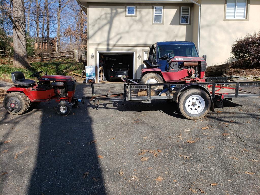

pyroplegic 55 #1 Posted January 6, 2019 Got a 416H yesterday needs a starter to start with. haaa 4 Share this post Link to post Share on other sites
Wishin4a416 2,473 #3 Posted January 6, 2019 Some very able machines there. Enjoy! Share this post Link to post Share on other sites
WHGuy413 2,851 #4 Posted January 6, 2019 I have a 416H. I almost died when the dealer told me the cost of a starter. Make sure your sitting down when you find out. Are you positive it's the starter that's bad? Share this post Link to post Share on other sites
The Tuul Crib 7,340 #5 Posted January 6, 2019 I'm sure someone here has a starter for it . I would check fleabay as well, Share this post Link to post Share on other sites

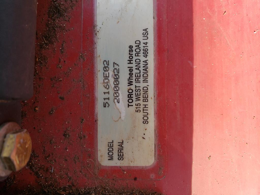

pyroplegic 55 #7 Posted January 7, 2019 its a 92, what else can you tell from the serial number?? Share this post Link to post Share on other sites

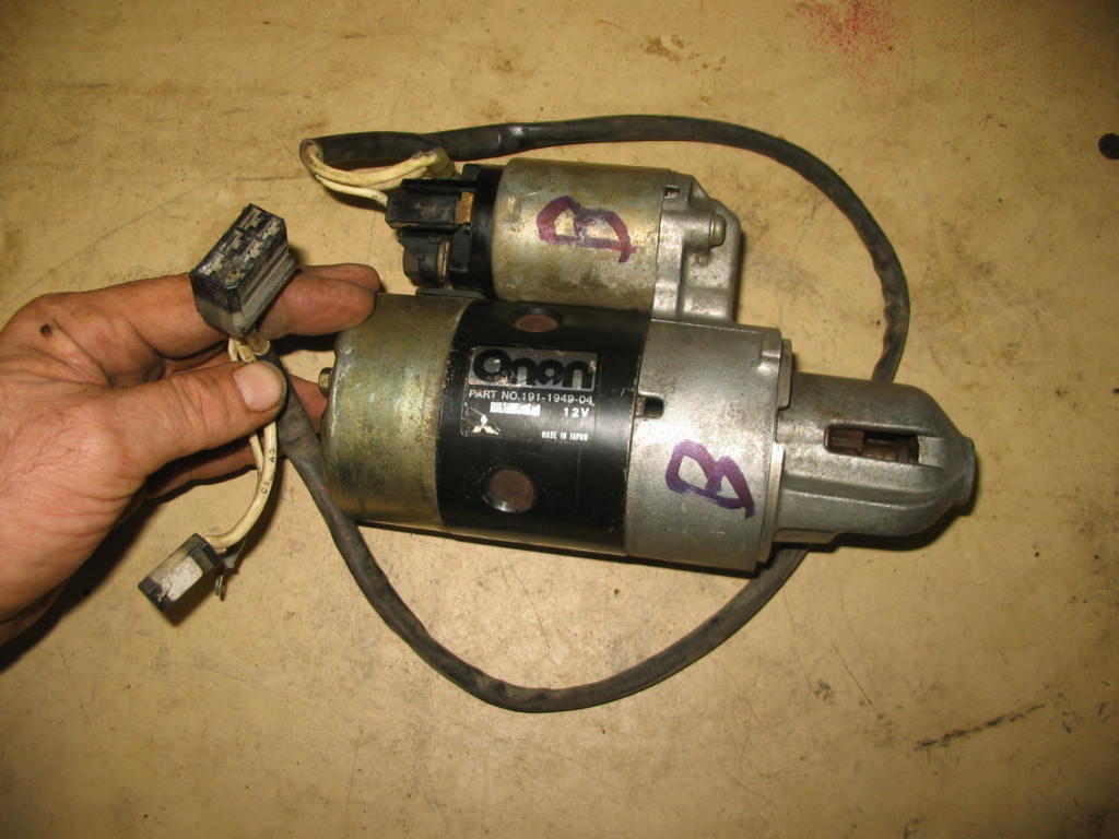

daveoman1966 3,882 #12 Posted January 7, 2019 I have a good working starter from a 520-H model 41-200E02 that should match the Onan 16hp engine in your model 51-160E02. Lacated in N/W PA but can ship anywhere. $55 + ship.... Interested: send me an off-site email.. I am: daveoman@windstream.net 1 Share this post Link to post Share on other sites
