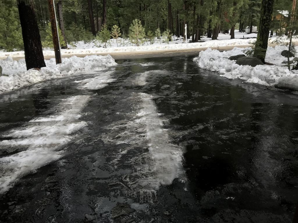

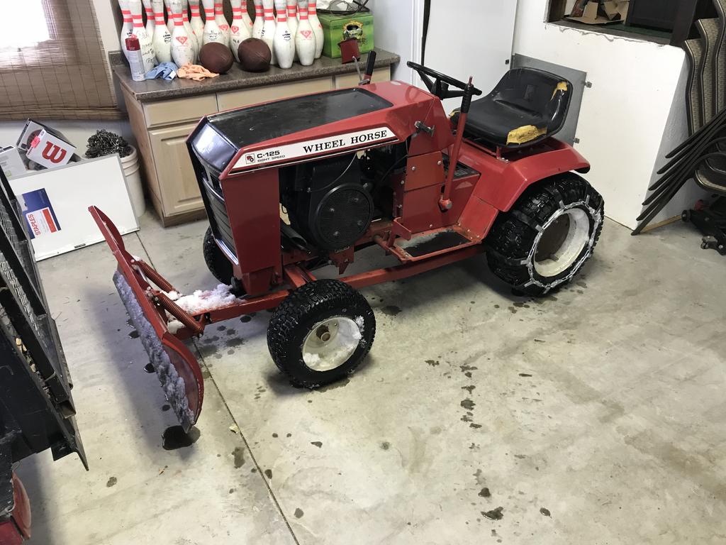

Jim anderson 77 #31 Posted January 11, 2019 All went very well for the first time. I got the deck off easily, plow mounted, new snow chains on, and the driveway plowed. Some very heavy/wet snow. It has been melting for a week and gotten rained on at least 3 times. Great fun! So a bit curious, should I leave the mule drive on, or remove completely. I took the guard off for this first run, it looked like the plow might hit it in the raised position. Still need to troubleshoot the lights, do the oil change and a couple other things. May have a loose wire to the starter too. Thanks to all who offered advise!,,, 1423B20C-C22D-449F-A532-83EFF28F0B8E.MOV 4 Share this post Link to post Share on other sites
SylvanLakeWH 32,709 #32 Posted January 12, 2019 I take the mule drive of my C-105 and store it with the deck... Figure it does not need to be exposed to the elements and salt etc... 2 Share this post Link to post Share on other sites

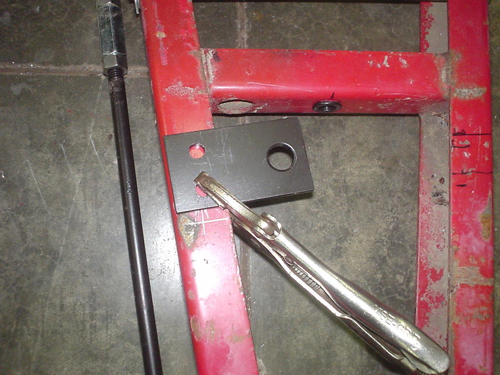

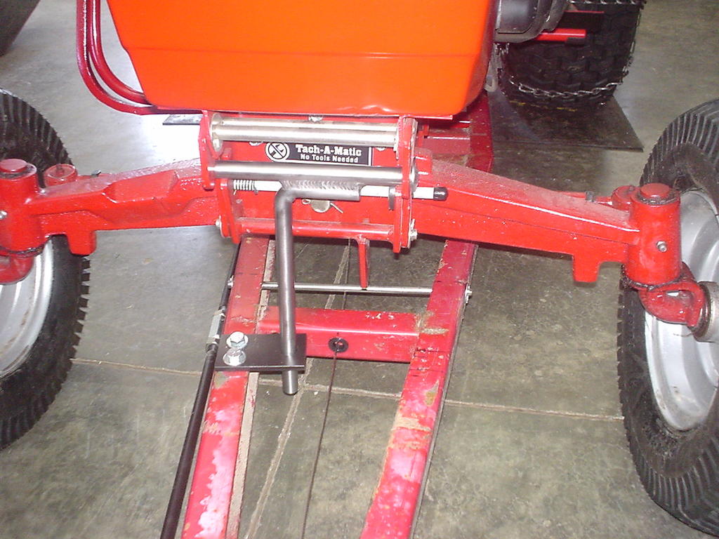

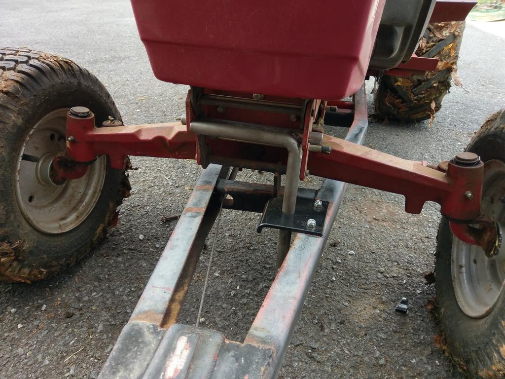

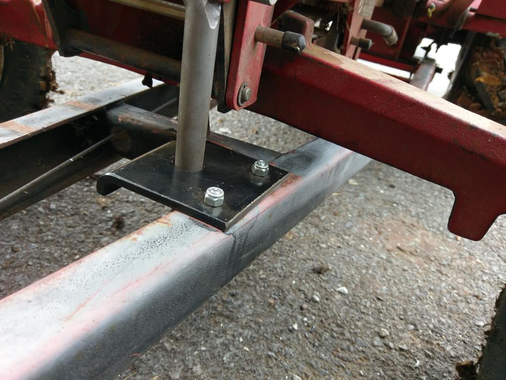

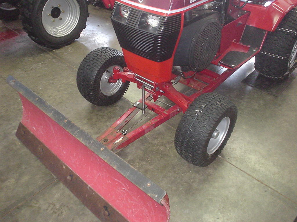

cleat 9,384 #33 Posted January 12, 2019 Take that mule off and then you can make up (or get made up) a stabilizer to hold the plow nice and straight. Takes a lot of stress off of the rear attachment points. Here are the plans I drew up. Snow blade stabilizer.pdf Here are a couple of pictures of mine. To mount the plate with the hole for the rod to pass through I just installed the stabilizer into the front attachment bracket on the tractor then pass the rod through the plate and clamp it onto the blade so the rod is as close to vertical as possible then drill the 2 holes and bolt it up. Once it is clamped you can remove the stabilizer from the front attachment bracket on the tractor, then disconnect the lift link and rear attachment bracket on the tractor so you can pull the blade forward a little to make drilling easier. Then just slide it back, re-attach everything and you are good to go. 5 4 1 Share this post Link to post Share on other sites

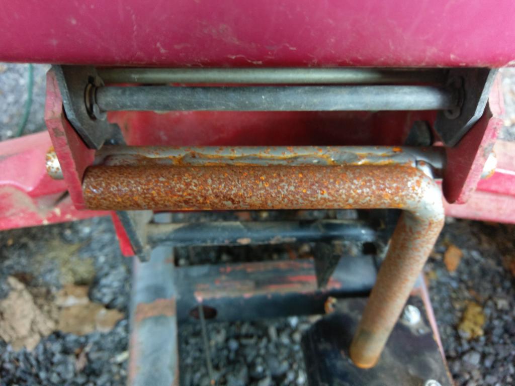

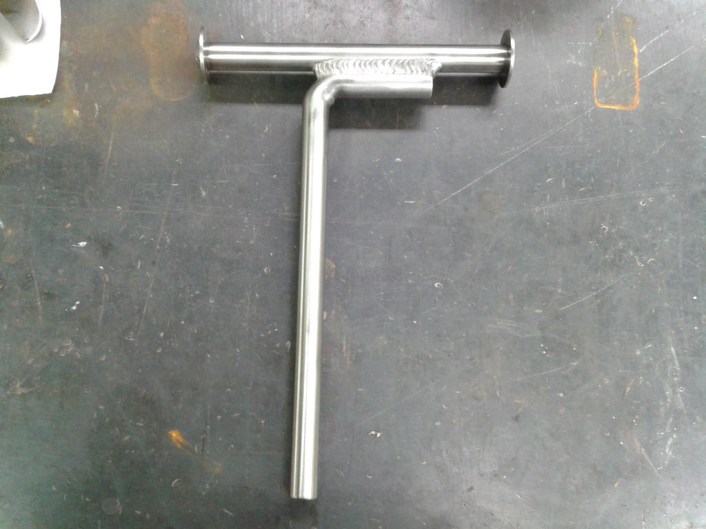

WVHillbilly520H 10,379 #34 Posted January 12, 2019 3 hours ago, cleat said: Take that mule off and then you can make up (or get made up) a stabilizer to hold the plow nice and straight. Takes a lot of stress off of the rear attachment points. Here are the plans I drew up. Snow blade stabilizer.pdf Here are a couple of pictures of mine. To mount the plate with the hole for the rod to pass through I just installed the stabilizer into the front attachment bracket on the tractor then pass the rod through the plate and clamp it onto the blade so the rod is as close to vertical as possible then drill the 2 holes and bolt it up. Once it is clamped you can remove the stabilizer from the front attachment bracket on the tractor, then disconnect the lift link and rear attachment bracket on the tractor so you can pull the blade forward a little to make drilling easier. Then just slide it back, re-attach everything and you are good to go. Because of you and owning an xi, here's my version... 2 1 Share this post Link to post Share on other sites
formariz 12,381 #35 Posted January 12, 2019 @cleat, @WVHillbilly520HGreat idea on that stabilizer. The sideways deflection on the plow always concerned me. Will be making one soon.Thank you guys!! 1 1 Share this post Link to post Share on other sites
