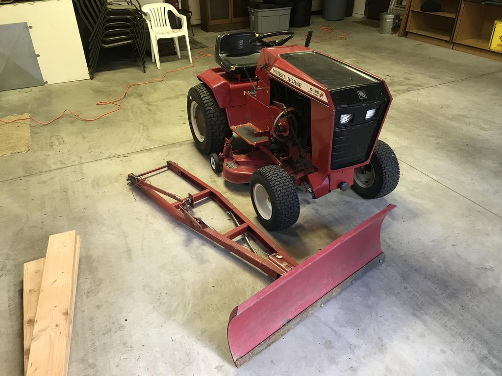

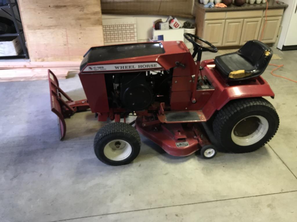

Jim anderson 77 #1 Posted January 2, 2019 Hello all, new to this forum and was looking for some advice on value. In my area is posted a 1983 C-125 with blade attachment and mower deck. The unit looks pretty clean from the pic and the asking price is $950. Is this in the ballpark, or too high too low? Thanks in advance. So fast forward to New Years Eve and my wife humored me and let me buy the tractor, so this is my first one. I ended up getting everything including plow, wheel weights, tire chains for $680. It had sat for a bit so wouldn’t start at first, add a little starter fluid and she lit off and purred nicely. Just one puff of smoke on initial light off as would be expected for something that had been sitting, nothing else bad at all. All gears shift nicely, engine is smooth etc. So the reason I’m posting is that even though it was advertised as an ‘83, I think it might be a 1981. When I got home and went thru the papers that were included, they looked to be original owners manual and brochures that came with the tractor upon first purchase. (Pretty cool actually.). So one of the included magazines is a Wheel Horse magazine, dated 1981, and has an article about 1981 design features. Who knew that Jackie Stewart was their pitch-man at the time? So looking at the VIN Number I come up with: 01-126803-25028. followed by: 2095. Hoping that someone can give me an idea if the tractor is 1981 or ‘83 or anything else. My my little disclaimer here, still figuring out how to post and read on this forum, so if I have double posted anything I apologize in advance. Thank you all for the help!! 5 1 Share this post Link to post Share on other sites

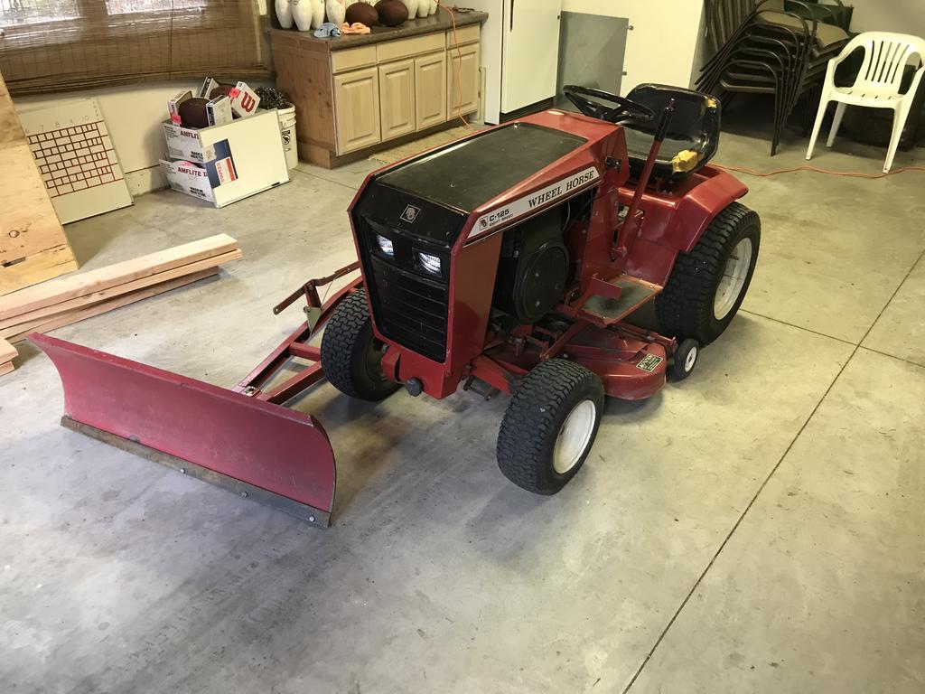

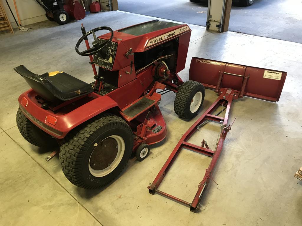

Jim anderson 77 #6 Posted January 2, 2019 Ok- 1982 is just fine with me. Oh, just a little additional info: rear discharge mower looks to be in great condition, but I don’t have a lawn so will stay in great condition. Just plan on mounting and using the snow plow. Also, headlights worked initially, but don’t now. Haven’t troubleshot yet but I’m guessing the fuse is the likely culprit? I posted pics earlier, not sure where they ended up so here we go again: 5 2 Share this post Link to post Share on other sites
oliver2-44 11,782 #7 Posted January 2, 2019 That is an amazingly clean looking 36 year old tractor and implements. Great purchase! There's lots of knowledgeable, friendly people here and no wrong questions. Share this post Link to post Share on other sites
roadapples 6,987 #8 Posted January 2, 2019 Can't buy anything comparable today for that price. Older bulb sockets can be a PIA. 1 Share this post Link to post Share on other sites
Jim anderson 77 #9 Posted January 2, 2019 I suspect that they can, but two different times tried the headlights and both came on, now neither will. Don’t think it can be both bulbs going out simultaneously. Share this post Link to post Share on other sites
midpack 1,148 #10 Posted January 2, 2019 more than likely a ground causing your lights to work occasionally. Nice machine 4 Share this post Link to post Share on other sites

peter lena 10,091 #13 Posted January 2, 2019 hello Jim, I can relate to the black hoods, I bought mine new in 82, very stout machine, when mounting that plow frame , I usually attach at the rear axel first , giving you the advantage of alignment and containment. I also use these spring clips https://parts.ectts.com/hairpin-clip-hitchpin/?_vsrefdom=adwords&gclid=EAIaIQobChMIysKAyofQ3wIVg-DICh21fgsCEAQYAyABEgKAsPD_BwE in the 1/8" holes on the lever arms to secure its mounting. if you don't use something ,you could possibly drop the rear of the frame, don't ask me how I know this , pete 2 Share this post Link to post Share on other sites

SylvanLakeWH 32,708 #15 Posted January 2, 2019 The Black Hoods are somewhat famous for grounding issues at the front head light bulbs due to the hood pivot. I found this out the hard way... Easy fix though... Check your ground and redo it. Fixed my issue immediately... Also - watch for wear on the wires at the hood pivot point - mine was worn away pretty badly. The factory wire routing guy was either drunk or wanted return business on warranty calls!!! 1 1 Share this post Link to post Share on other sites
