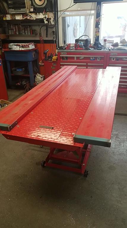

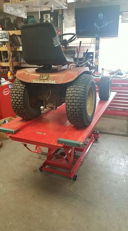

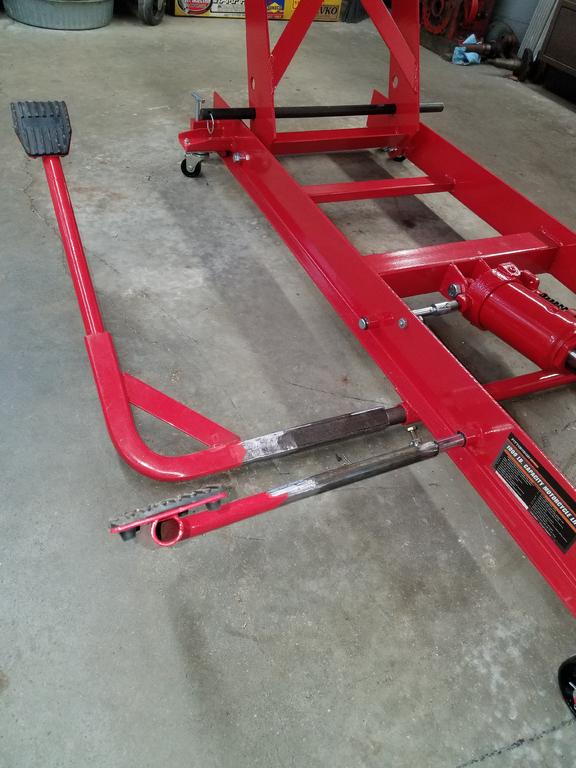

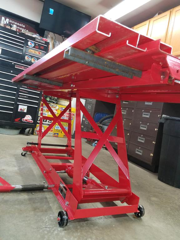

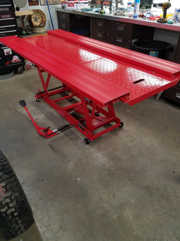

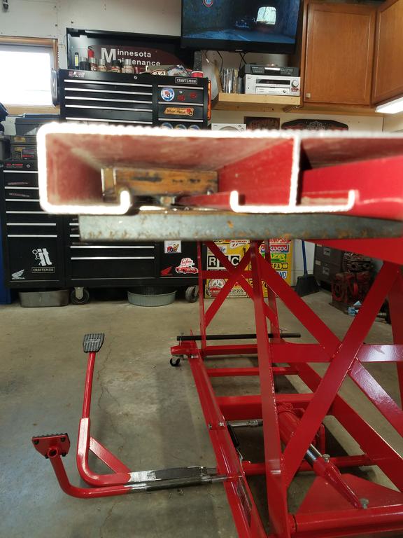

prondzy 3,891 #1 Posted January 1, 2019 (edited) I posted the other day in the xmas gifts thread that i got a lift table. I knew it needed modifications to hold a tractor and i couldn't just put a slab of plywood on it because i still need to use it for my motorcycle. I had a plan figured out but was going to need sheet metal bent to make rails for the tires to go onto while leaving the center open for my motorcycle when needed. I went to the scrap metal yard with @Shynon to pick up metal for the rail supports, while digging through the rack i found aluminum bleacher seats! Score! They were 15ft long and 10 in wide this is perfect, best part is the bleachers were already RED! So we took some bleachers home and started cutting, i have been fabricating all day and this is as far as i got today, had to extend the pedals too. I still need to make a steel lip for the ends of the rails so they dont get wrecked when mower decks hit the edge, and make a front tire vise for my motorcycle. Edited January 1, 2019 by prondzy 6 8 1 Share this post Link to post Share on other sites
Shynon 7,729 #2 Posted January 1, 2019 Tractor is on mine. Sure is nice not to have to lay on the floor. I'm getting too old for that. 7 2 Share this post Link to post Share on other sites

WHX?? 58,378 #6 Posted January 1, 2019 What's that cutout thingy in the back for guys ..some kind of removable plate? Looks like Mr. Gilmour on the tube ther Tom 1 Share this post Link to post Share on other sites
prondzy 3,891 #7 Posted January 1, 2019 4 minutes ago, WHX21 said: What's that cutout thingy in the back for guys ..some kind of removable plate? Looks like Mr. Gilmour on the tube ther Tom Its a plate to drop out the back tire on the old HD Jim Share this post Link to post Share on other sites
WHX?? 58,378 #8 Posted January 1, 2019 Ahhh.... I thought it was maybe for putting an oil catch pan under it! 1 Share this post Link to post Share on other sites
prondzy 3,891 #9 Posted January 2, 2019 2 minutes ago, WHX21 said: Ahhh.... I thought it was maybe for putting an oil catch pan under it! I had the same thought for catching trans oil on the tractors Share this post Link to post Share on other sites
rdeanrj58 68 #10 Posted January 2, 2019 Very nice. Did you widen the ramp too ? 1 Share this post Link to post Share on other sites
WHX?? 58,378 #11 Posted January 2, 2019 You plan on taking those extensions off for scoots or not that far of a reach? Share this post Link to post Share on other sites
prondzy 3,891 #12 Posted January 2, 2019 13 minutes ago, WHX21 said: You plan on taking those extensions off for scoots or not that far of a reach? Plan on leaving them on for now, gotta do some bike work soon so i will see how it goes 21 minutes ago, rdeanrj58 said: Very nice. Did you widen the ramp too ? Not yet, i plan on using a set of ramps i have for now. Share this post Link to post Share on other sites
