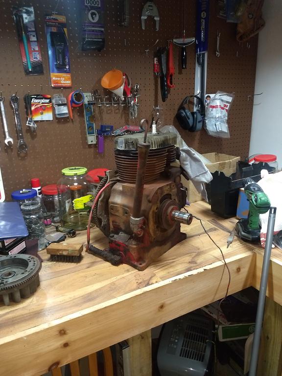

ebinmaine 79,127 #15 Posted December 31, 2018 Here's the engine as it sits on the bench for us to work on it I'll get some more of it ... during process. Share this post Link to post Share on other sites
