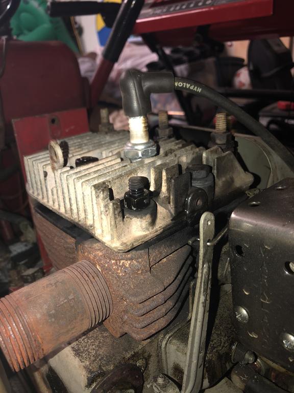

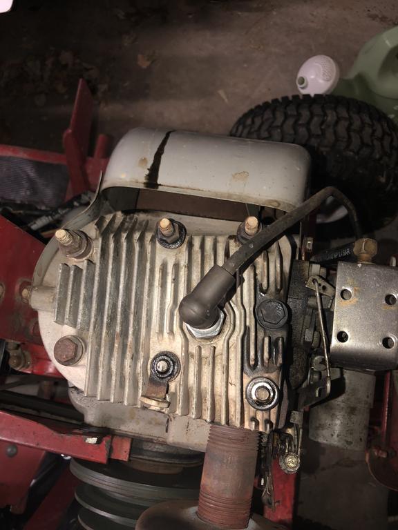

Haven’t been doing too much, been down sick and busy with the holidays. The other day I fired up Hank just because he’d been sitting and I like the smell of exhaust. After running for a bit I noticed my negative cable was loose, so I shut it down and went to tighten the nut, that’s when I noticed the oil that had percolated out of the top. (See pictures). Is this indicative of a problem already present that I just haven’t noticed, or a foreshadowing of one about to happen?
Also, in another thread that I’d come across, someone had mentioned that it sounded like the OP was running their engine higher than they should. Where should I be putting the throttle to put around the yard, when pushing snow, etc?  I’ve always left it at about 1/3rd, simply because I didn’t think it needed to sound like I was qualifying at the brick yard when I’m just going around the yard in 1. Rarely do I put it past 1/2.  Am I unintentionally causing undue stress the the engine? Is this what could be causing the oil to come out of the bolts? Any and all guidance is appreciated!

Kind of looks like your head gasket is leaking.  If that is all it is, it is an easy fix.  Check out this thread...  Gaskets are available on E-Bay.
Your engine uses the splash method to lubricate it self.  You should be running it at 3/4 speed to get the oil splashing the way it is supposed to.  You may not have to run at 3/4 all the time, but you should run it a little when you got her out.

Looks like a bad head gasket. These old flatheads need to be run at 3/4 to full throttle, more oil getting to where it need to be and more air to keep it cooler. you engine is running hotter at half throttle than at full throttle not good.

:text-yeahthat:  Blown head gasket.   Easy fix.   Be prepared to clean out some carbon buildup while you have the head off, and put 15 to 20 ft.lbs. torque on the head bolts when you reassemble.   Good luck.

You want to fix that gasket.  You are losing compression and the gap will get bigger if you run it.  Go on E-Bay order the gasket for a K-181...either Stens of Kohler.  The Stens is cheaper but fine to use.   Get a piece of glass and some wet dry paper.  It only takes about an afternoon and you are taking it around the block and re-torqueing the bolts.  :handgestures-thumbupright:

I noticed the tins from the top of the head and cylinder are missing. I presume that was done to take the pictures. It is important to have them in place for cooling.

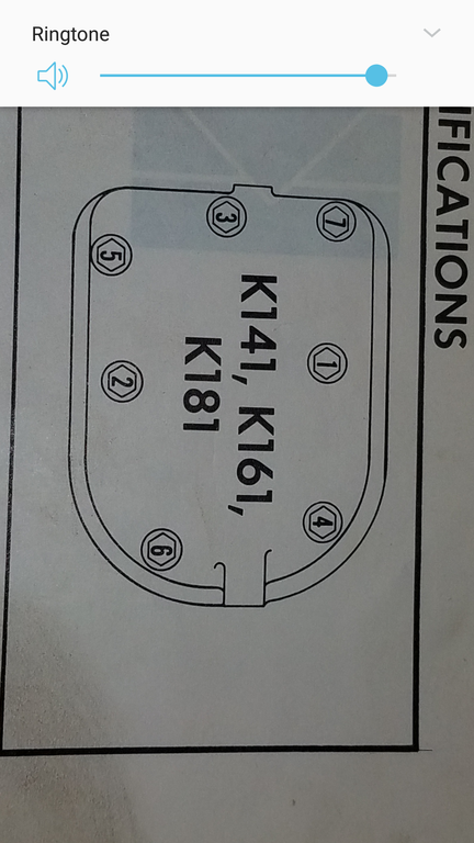

This is very important, once the engine has been brought up to operating temperature the head bolts need to be hot torqued, same sequence and same torque setting.

Torque sequence for 181 head gasket
The way it’s pictured is the way we got it. Aside from the flywheel cover there aren’t any other tins.
Could that have helped excelerate the problem? Any idea where to find quality replacements?

If you've been ruining it with out those tin especially at low RPM, you've probably cooked your oil. When the oil gets really hot it get thin, probably why it's blowing out of  the head and up through the head bolts. You going to need to get those tin covers and replace the head gasket, and definitely check the head to see if it's warped. Put fresh oil in once you get it back together, run it a little at at least 3/4 throttle, then retorque  the head bolts and change the oil again

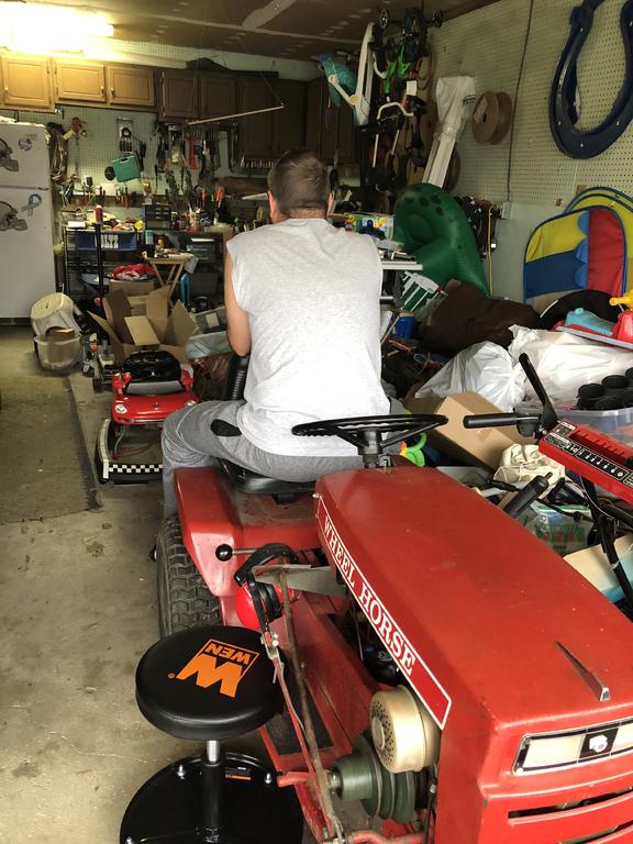

I see you have kept a clear path to the refrigerator.  Very smart.  :occasion-xmas:

You can’t see it, but that's because our little grocery getter  (Chevy HHR) is parked there. That’s our “get the car seat out” buffer zone
Getting 2 families worth of stuff in a 1 family home gets a little cramped at times 😂.
