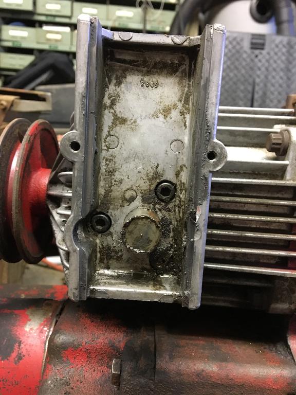

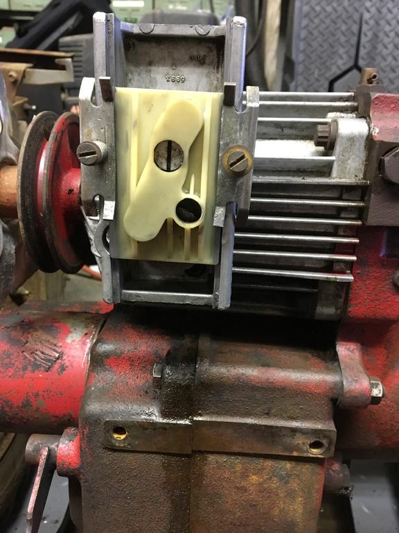

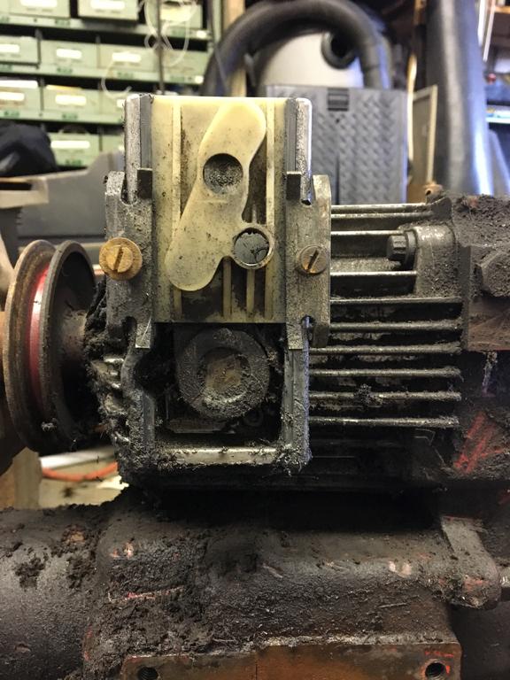

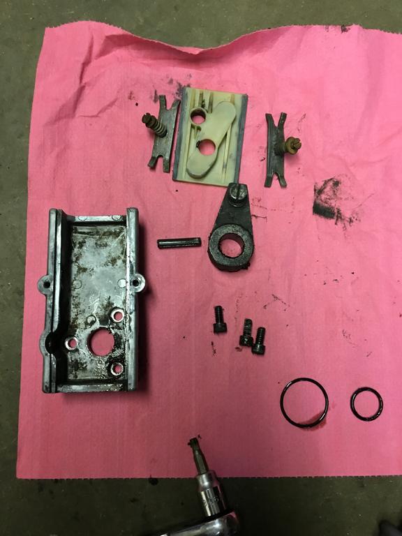

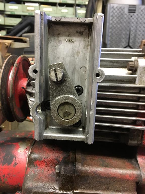

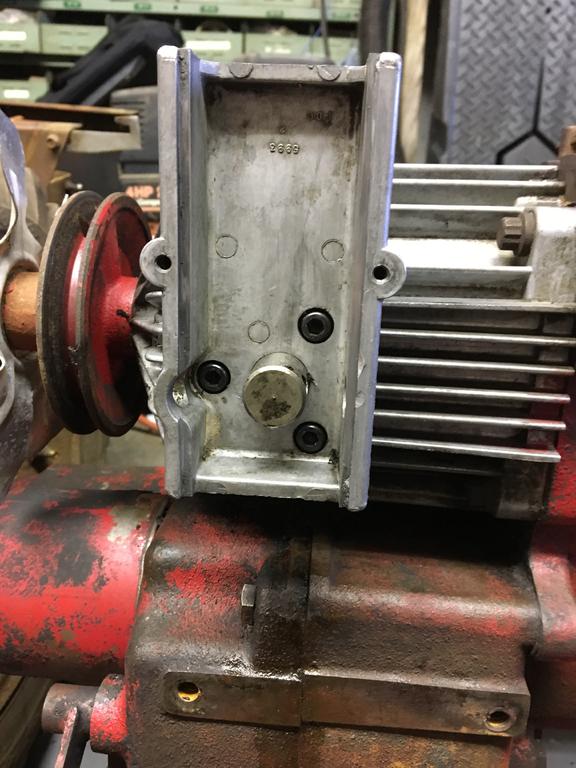

p38js 444 #51 Posted February 4, 2019 Cam box and data tag cover resealed pretty easy job once you gain access to the cam box 1 2 Share this post Link to post Share on other sites

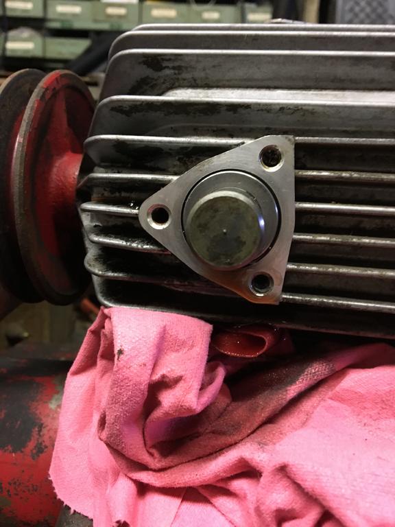

pfrederi 21,342 #52 Posted February 5, 2019 Was the triangular shim in your replacement unit??? Share this post Link to post Share on other sites
p38js 444 #53 Posted February 5, 2019 Yes sir one under the cam box and one under the data tag. I feel bad I drove those poor people nuts at my local dealer. They had to go back into there special parts bin. Oh well we all learned alittle bit from it. 1 Share this post Link to post Share on other sites

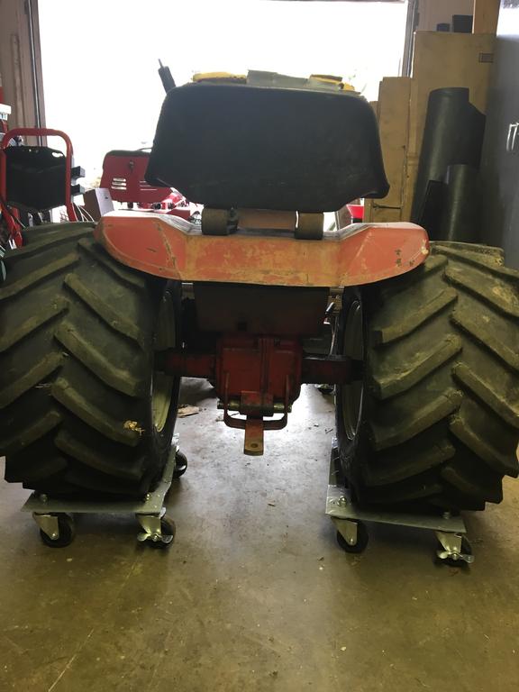

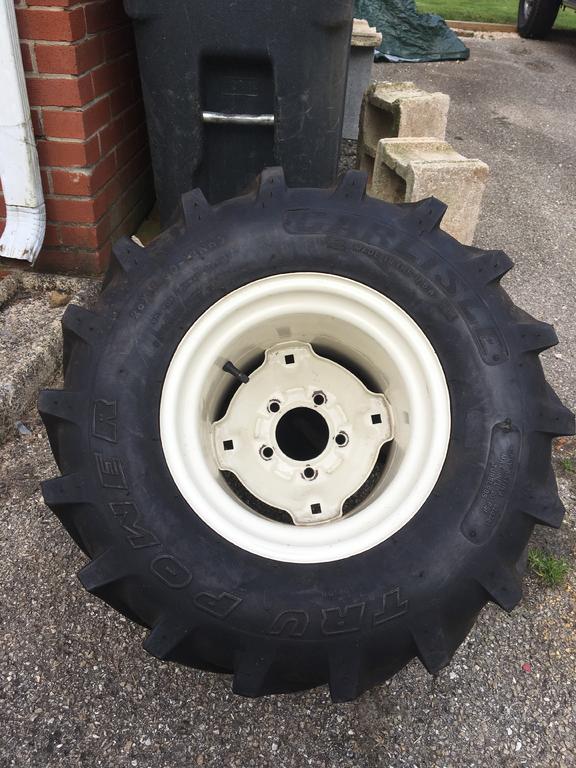

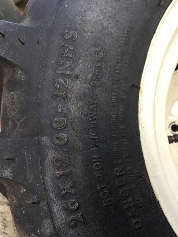

p38js 444 #60 Posted April 26, 2019 What a difference tire and wheels make I can’t believe the transformation 2 Share this post Link to post Share on other sites

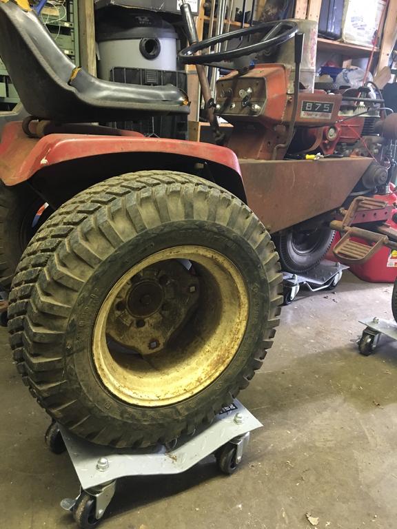

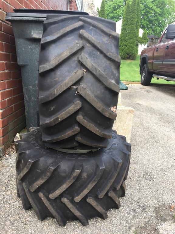

p38js 444 #61 Posted April 26, 2019 And now to try and get this to fit on a short frame 2 3 Share this post Link to post Share on other sites
ebinmaine 81,282 #62 Posted April 26, 2019 Love those big rear Meats Did you have to tweak the fender or anything? What's the power plant you have there? Share this post Link to post Share on other sites
19richie66 17,951 #63 Posted April 26, 2019 Looks mean. Spacers I presume? Share this post Link to post Share on other sites
Lee1977 7,813 #64 Posted April 26, 2019 9 minutes ago, ebinmaine said: Love those big rear Meats Did you have to tweak the fender or anything? What's the power plant you have there?c Eric you need a magnifying glass with phone, It's right o the side {Briggs twin cylinder 16HP} . It's an older model because of the rope starter . 1 Share this post Link to post Share on other sites
Pullstart 71,561 #65 Posted April 26, 2019 Oh boy oh boy oh boy this looks fun! Share this post Link to post Share on other sites
ebinmaine 81,282 #66 Posted April 26, 2019 8 minutes ago, Lee1977 said: need a magnifying glass with phone Yes I do! Thanks for pointing that out. Share this post Link to post Share on other sites

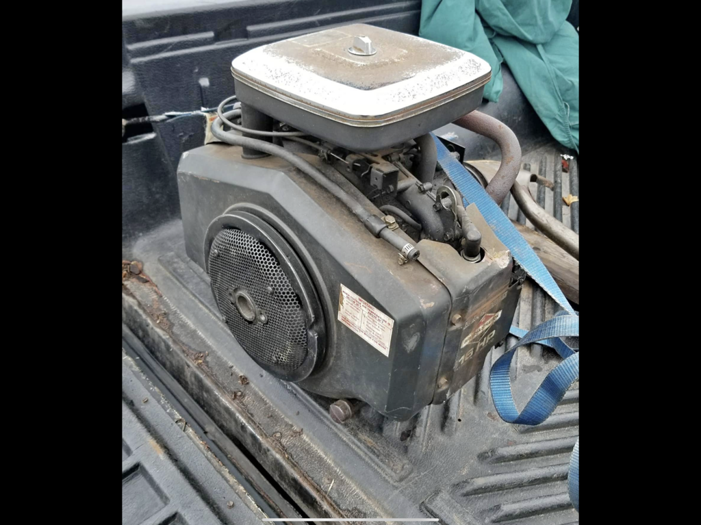

p38js 444 #67 Posted April 26, 2019 I got the tires from a gentleman in New Jersey that had them on a wheel horse puller, he already had the correct back spacing needed for the wheel horse, I went into fully knowing I was going to have to trim the fenders, to my surprise and shock they fit with no trimming need or spacers need, every once in a while a blind squirrel finds a nut. Now to try my hardest to get that twin 16 Briggs to fit without extending the frame. I’m entertaining ideas I need about 3 inches with the battery in the current location, might try to find a smaller 12v to relocate the battery to under the seat, because from what I understand the Briggs only needs a battery to start since it has a magneto, i’m Not a Briggs guy yet so a lot of reading on my part to understand the finer details, Share this post Link to post Share on other sites
ebinmaine 81,282 #68 Posted April 26, 2019 Awesome that those tires worked out the way they did. I like the battery under the seat idea. I think I remember seeing one of those on Vins RJ YouTube channel a year or two back. @VinsRJ Others here hey have done that as well. Provided that the engine is kept in good tune, cranking amps on a battery can be kept at a minimum as long as you are below about 85 to 90 degrees or above about 30 to 35 degrees. Larger gauge battery cables should be installed as well. 1 Share this post Link to post Share on other sites
p38js 444 #69 Posted April 26, 2019 @ebinmaine that is where I got the idea of putting the battery under the seat but his was an 8 speed and mine is a hydro the dip stick is in the way, 1 Share this post Link to post Share on other sites
ebinmaine 81,282 #70 Posted April 26, 2019 23 minutes ago, p38js said: @ebinmaine that is where I got the idea of putting the battery under the seat but his was an 8 speed and mine is a hydro the dip stick is in the way, Yep yep yep. Gotcha... I know next to nothing about them but what about a long skinny motorcycle battery? Share this post Link to post Share on other sites
p38js 444 #71 Posted April 26, 2019 That’s a good thought I will check them out and start to measure to see what I can find 1 Share this post Link to post Share on other sites

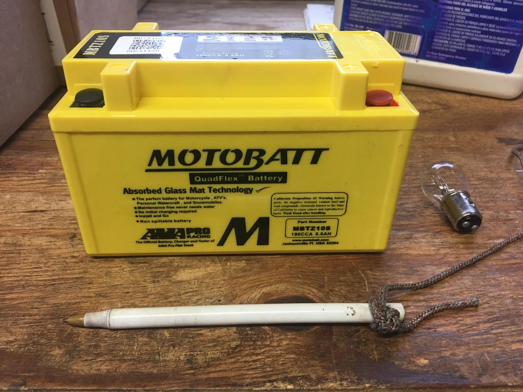

Pullstart 71,561 #73 Posted May 2, 2019 @Achto‘s newest build, Radpferd has a Harley Davidson battery up on a pedestal under the hood. You might want to check that out, as it’s a bit of thinking outside the box. 2 Share this post Link to post Share on other sites
Achto 32,963 #74 Posted May 2, 2019 A couple of pics for you. 1 Share this post Link to post Share on other sites
19richie66 17,951 #75 Posted May 2, 2019 We use these on mowers. 190 cranking amps. You can get them a larger. 3 Share this post Link to post Share on other sites
