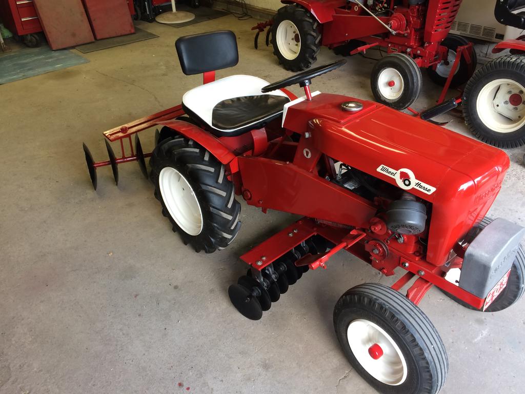

squonk 47,412 #7 Posted December 29, 2018 I like my disc all shiny and clean! 2 3 1 Share this post Link to post Share on other sites
6wheeler 676 #8 Posted January 13, 2019 On 12/29/2018 at 12:33 PM, squonk said: I like my disc all shiny and clean! Mike, that is just too pretty. You should load that up and run out here in say, May. I will help you get all that nasty black paint off those blades . A tandem disc definitely works better than a single gang. I like the notched blades in my clay ground here. I have a tandem three point Brinly disc that I made out of 2 discs. It goes on my D-250. I have to put 100lbs of front weights on it to keep the front end on the ground when it is lifted. 1 1 Share this post Link to post Share on other sites

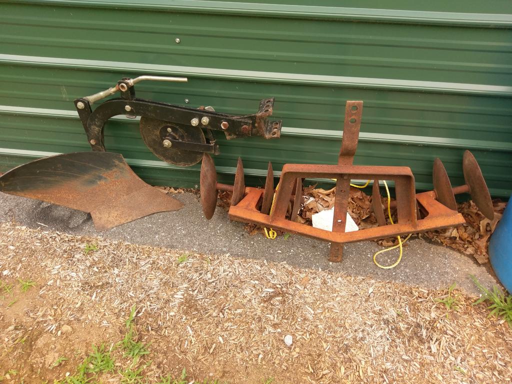

WVHillbilly520H 10,378 #9 Posted January 13, 2019 On 12/27/2018 at 5:02 AM, Daron1965 said: I have been looking at disc harrow attachments for my 312-8. The local stores offer Brinly smooth disc, and Agri Fab notched disc. I plan on using it to disc up my already plowed plots, and then run between rows of the larger plot. Is one better than the other? What do you use, and how does it work? Thank you. Here you go straight from our classifieds... Share this post Link to post Share on other sites
