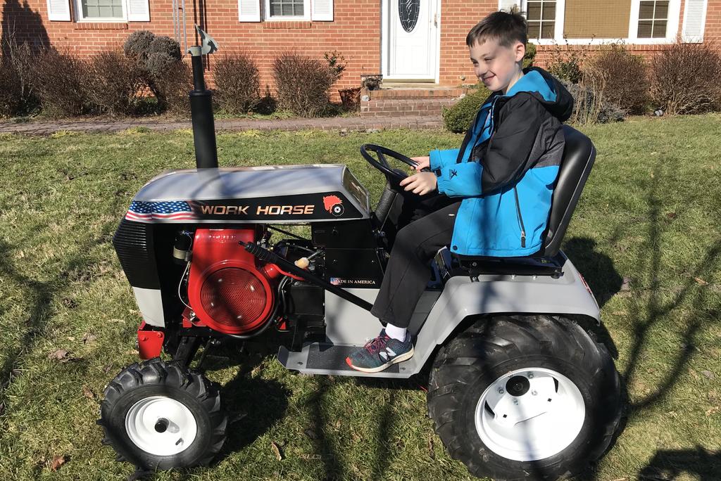

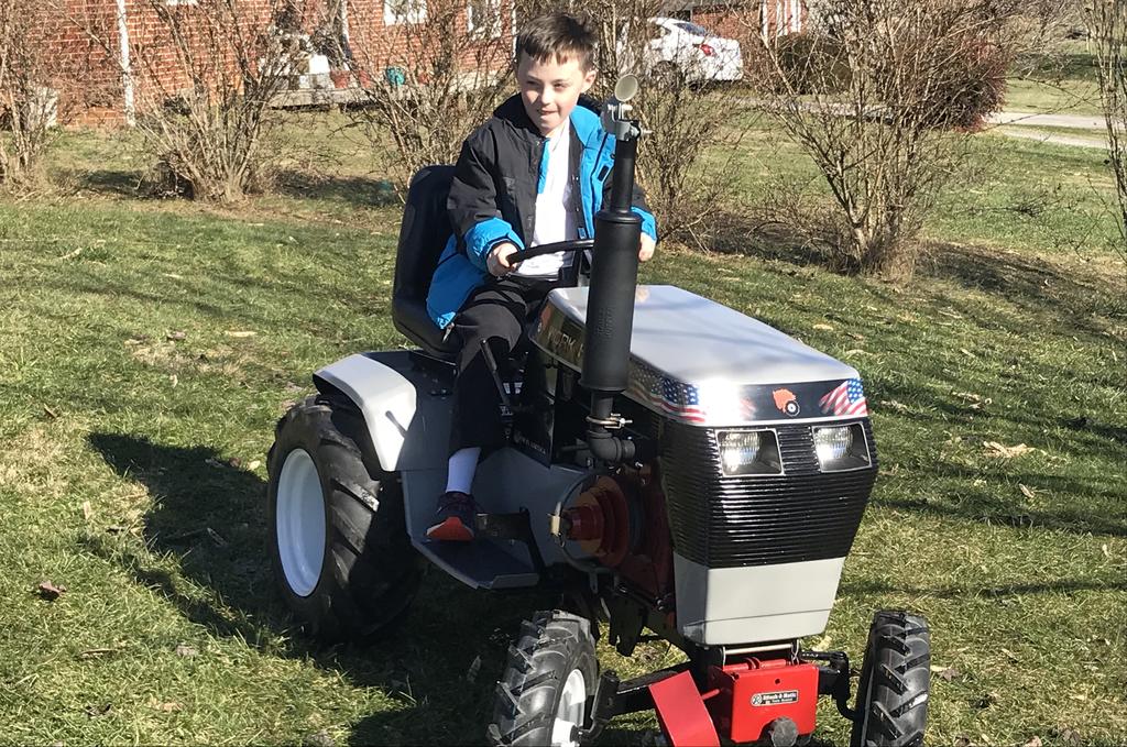

dells68 7,499 #87 Posted December 26, 2018 (edited) Ok, here’s what we’ve been waiting for! Look at that smile!!!! Turns out the problem was I had an externally resisted coil, even though the box said no external resistor required. Put a new coil on it and she runs. Carb I rebuilt has too much slop around the throttle shaft, so I’m gonna order a new one. Should be all she needs. Engine runs strong with no smoke or noises. Nice! Edited December 26, 2018 by dells68 4 9 2 1 Share this post Link to post Share on other sites
dells68 7,499 #88 Posted December 26, 2018 Just talked to @oldredrider and he’s going to bushbthat shaft for me so I’ll have it when we need it. Couldn’t ask for a better friend! Heard it said before, “You meet the nicest people riding Wheel Horses!” 1 3 Share this post Link to post Share on other sites
Shynon 7,604 #89 Posted December 26, 2018 19 minutes ago, dells68 said: Look at that smile!!!! That smile says it all great work Dells I think I know who Emory's hero is. 3 1 Share this post Link to post Share on other sites
19richie66 17,930 #90 Posted December 26, 2018 Better be careful or too many more Christmas’s and Emory will have more tractors than you. Glad you got it going. 1 3 Share this post Link to post Share on other sites
Achto 32,125 #91 Posted December 26, 2018 52 minutes ago, dells68 said: Turns out the problem was I had an externally resisted coil, even though the box said no external resistor required. I'm glad that you found the problem. Emory looks pretty happy on that tractor. 2 2 Share this post Link to post Share on other sites
